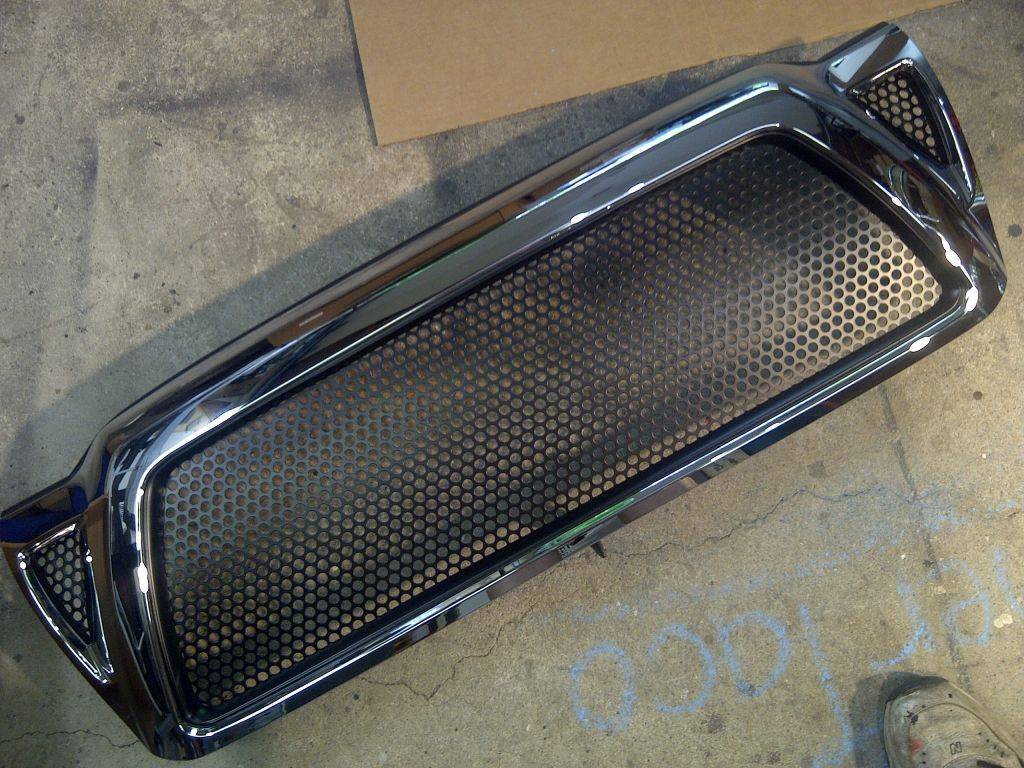

  9. Jun 27, 2012 at 8:57 PM
    #249
    HomerTaco
    Mar 28, 2010
    #34129
    45,874
    HomerTaco
    HomerTaco
    HomerTaco
  10. Jun 27, 2012 at 9:05 PM
    #250
    BrokenTusk
    BrokenTusk I support a velociraptor free workplace.
    May 5, 2010
    #36607
    31,957
    Marcelasaurus
    AB, Canada
    The Scarlett Whore
    Check Build Thread!!
    Thats a lot of holes mate, are you using these grills for target practice now??
  11. Jun 27, 2012 at 9:09 PM
    #251
    HomerTaco
    Mar 28, 2010
    #34129
    45,874
    HomerTaco
    HomerTaco
    HomerTaco
    :rolleyes:

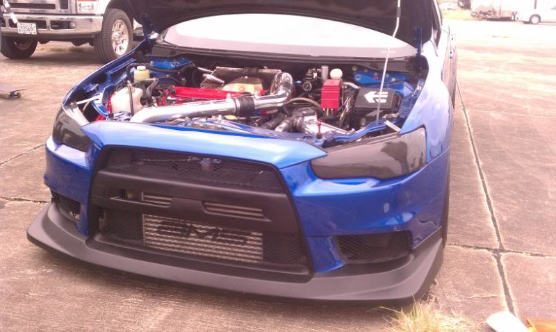

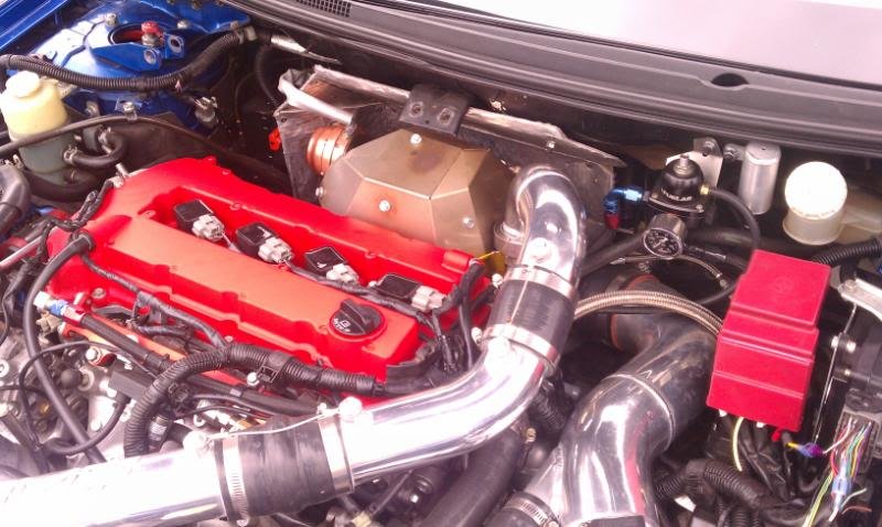

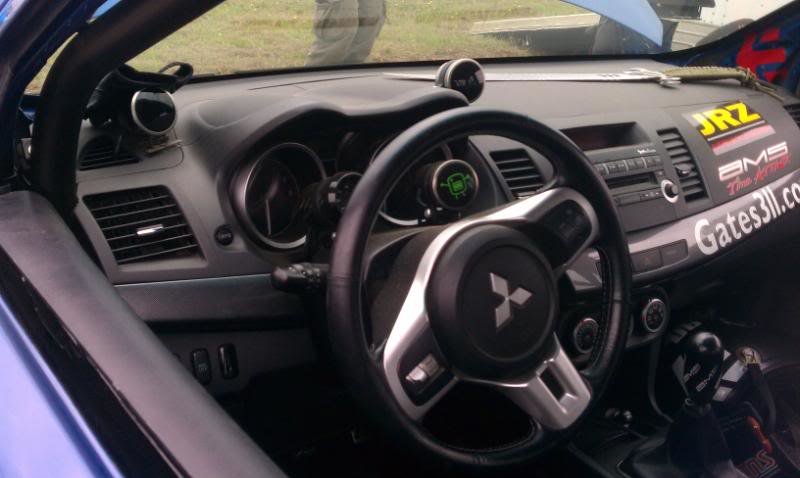

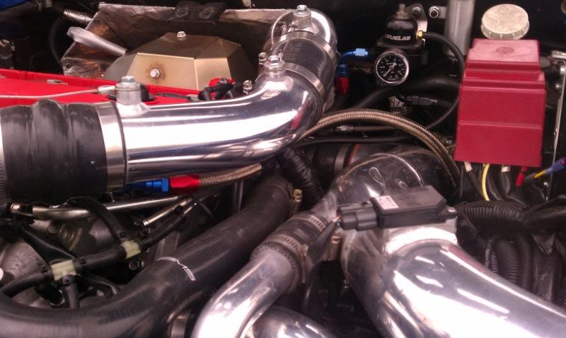

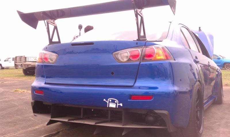

    Where I first heard about them, was from this guy I met at The Texas Mile. This is his car.
    This guy has a Evo X with an AMS Turbo kit. Really cool dude. Loved to share all of the stories about what he had been through with his build process. Super energetic, and an all around great guy. When he started talking about the specs of his car:
    Some additional Lancer spec.
    2.2 Litre, 750 whp, 2800 lbs, 10,000 rpm limit, MoTech Ecu, and "magical linear hp curve". (Not allowed to disclose how though. Hehe.....[​IMG] )
    2gs on the skid pad. Limited to 188mph with track focus built trans.
    Best quarter mile was in the 9's.
    Ran at Texas Mile....got up to 140 and cruised there until the 3/4 mile marker and punched it. Crossed finish line bouncing off rev limiter at 188.
    My first immediate question was," what size injectors are you running to feed that kind of power?"
    He said 2000 cc. I was shocked! So I asked, "How does the car idle with such huge injectors? Does it fluctuate terribly?" (Since even the common 668cc injectors used on the modded TRD S/C units, or URD units have to have very precise tuning to minimize the oscillating idle as best as possible.)
    He said,"Nope. Idles just like factory.:D" I was shocked again! "How does it do that? What type of injectors are those?!"
    Him," They are Injector Dynamics injectors. Check them out. ;)"
    So I did. I am not for certain, but am pretty sure that I was one of the first to run the ID1000s on a 1GR, unless the UAE peeps beat me to it. Lol. Now though, www.Dezod.com has them, as well as www.Horsepowerfreaks.com, specifically for the 1GR. :thumbsup:
    http://www.dezod.com/cat-tacoma-x-runner.cfm
    Oh, and by the way, the owner of that Evo X, was an actually very well known individual. His car is even an unlockable car in a few race car games. He was very humble, and eluded to he was.
    Ryan Gates, was his name. AMS Evo X is his car. http://www.youtube.com/watch?v=YITfILmk1mU

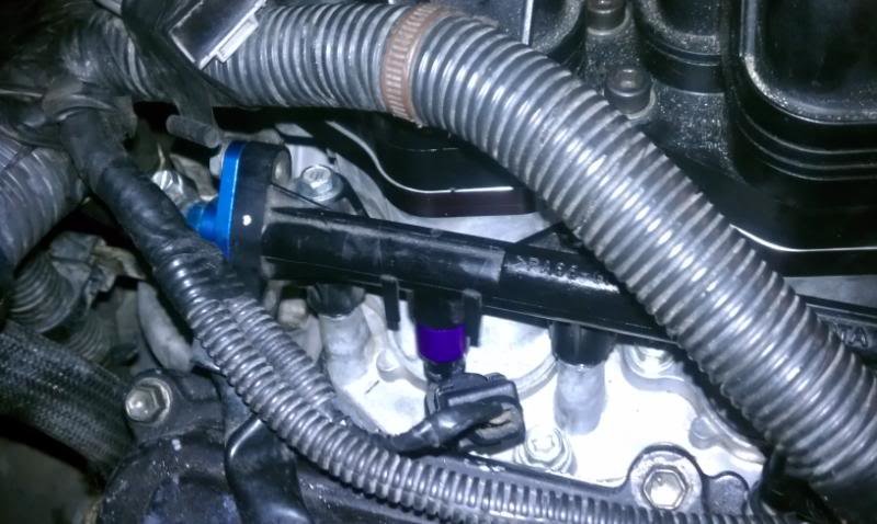

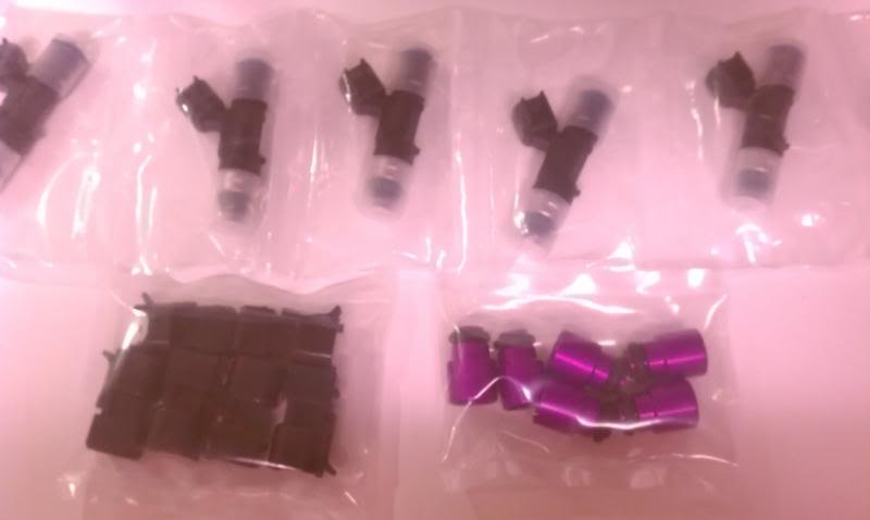

    All of that last post, was what led to the purchase of these. My 1000cc Injector Dynamics injectors. www.injectordynamics.com
    The best in the industy, and I agree.
    So here are the new injectors which I purchased. With these, I won't have to worry about upgrading injectors any more. These will supply effectively fuel for 1000 crank hp, on these motors. Far more than I will ever reach.
    Have a scheduled re-tune day setup as well. Woot!
    The small bag at the bottom left is the bag of plug in play connectors. The purple-ish caps to the right are what are used by them, to be able to adjust for height variences. Since some cars use shorter injectors than others. Very smart idea.
    I received those on right around 7-28-'11.
    The next step, was to go back for a retune with these injectors, as well as up the boost. ^_^

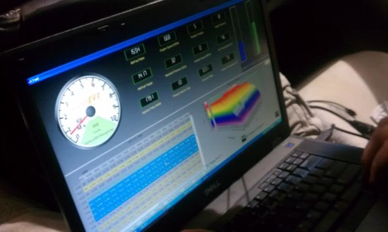

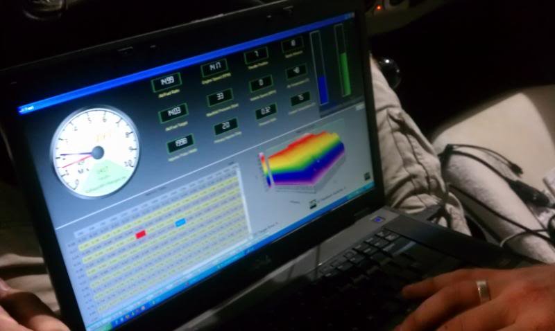

    Well, after installing the new injectors, and going for a retune, we found that the new wastegate spring I had ordered was for a different TiAL wastegate. So we just retuned for the injectors. Here are some pics.
    Here you can see the VE map being adjusted. The box in the top left shows the actual AFR. About 15.9
    Here you can see the AFR getting better if you look at the same box. The box directly below it is the Target AFR.
    A pic of the injector installed.

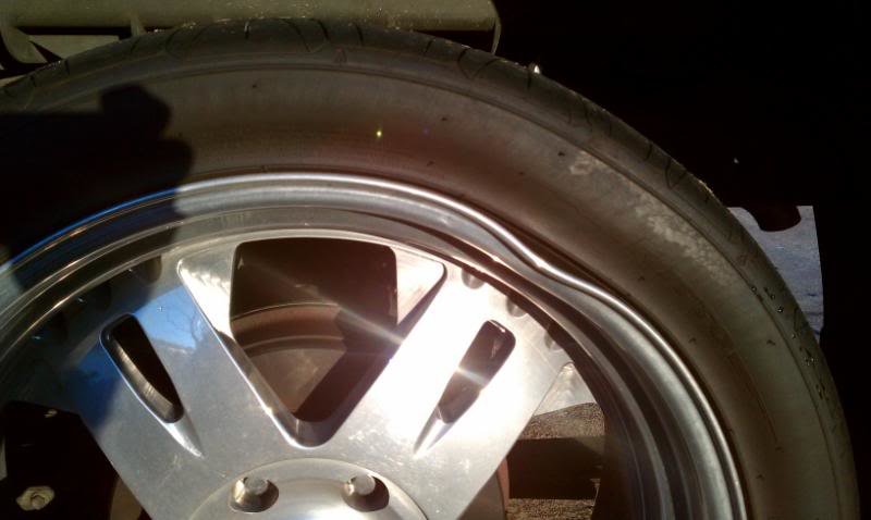

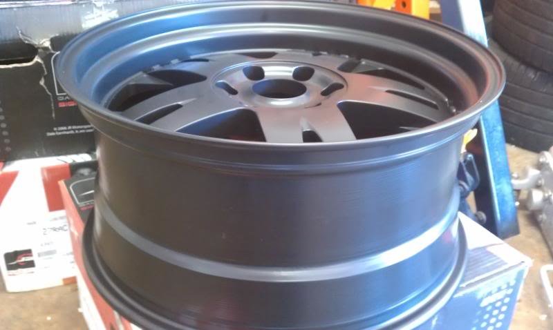

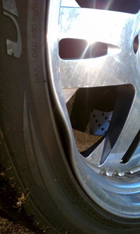

    I side project that I had going on, was getting my wheels fixed. A nice steel plate over some road construction had been placed over a hole in the road, had been layed down with the ends curved up. This is what it did....
    Got these back from a place called SABS, here in Houston. Had them fix them as well as powder coat them Matte Black. Kind of a satin black.

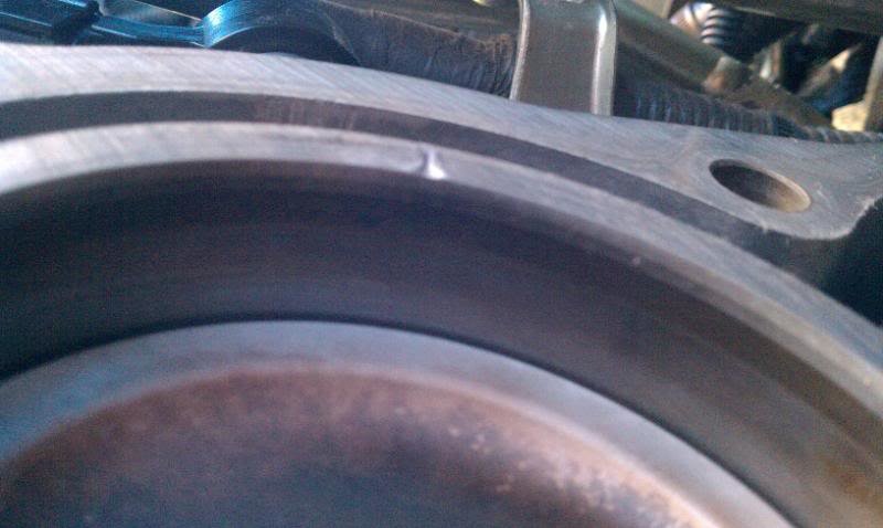

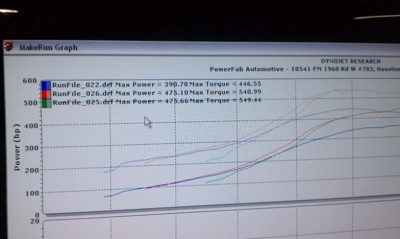

    Now going back to an incident that happened on the deck of the cylinder.
    Keeping my JB Welded deck in mind, and the fright of how it could end up failing on me, I was adament about the fact that the tune had to be extremely conservative.
    ^^^ That will bear some meaning in a little while, when brought into comparison with another 1GR.

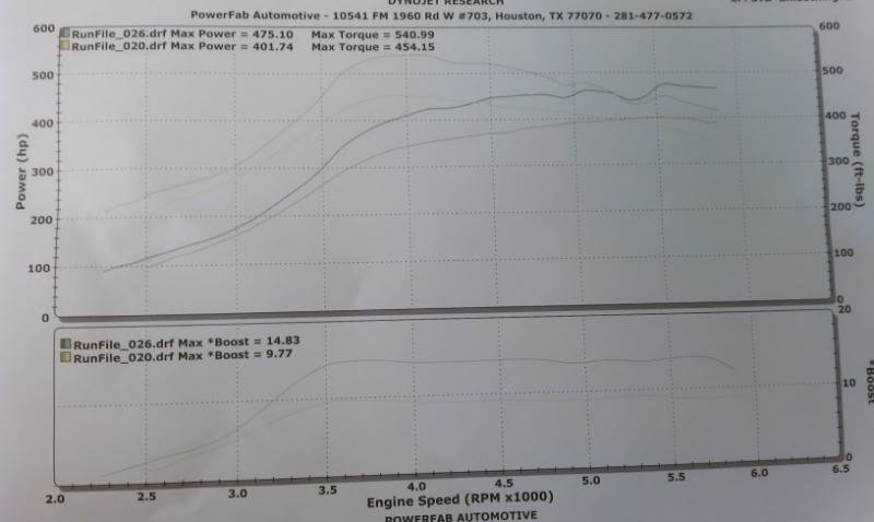

    About one month later, and new wastegate spring and schedule set, it was time to retune.
    The byproduct of that tune on 8-20-11 was very nice. Even with a conservative tune. ;)

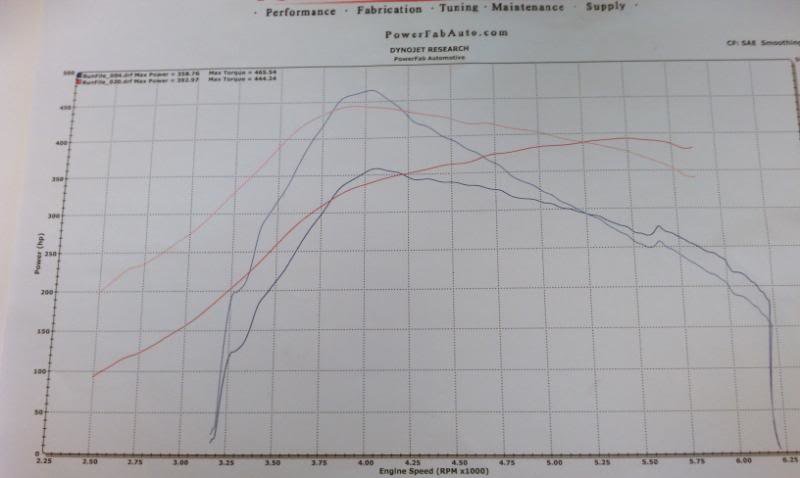

    Here again is the graph at 8.7 psi.
    Dyno pics of dyno at 8.7 psi.... Torspd front mount vs modified STS Rear mount
    And then at a very fun 14.83 psi.... :D
    This shows the best run. Outside temps were between 99-101*
    After datalogging, it is obvious that I need a better fuel pump. Obvious on the graph near the end.
    One thing to observe is that at a 5 psi increase in boost, I picked up 100 ft/lbs of wheel torque. Very impressive!
    Injector duty cycle = 55%.
