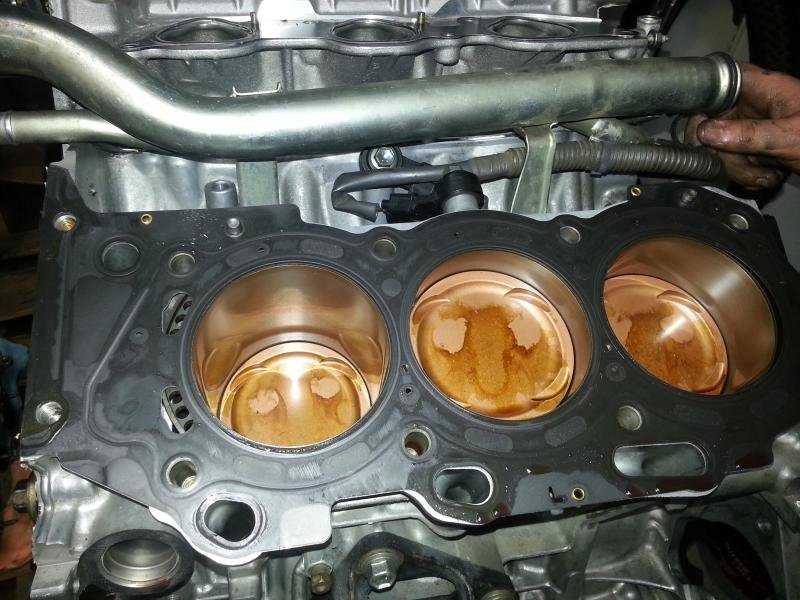

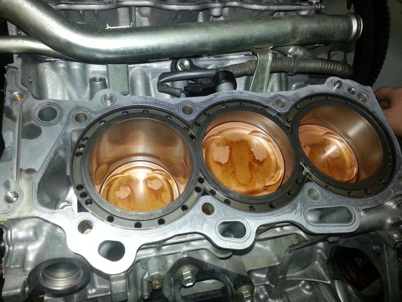

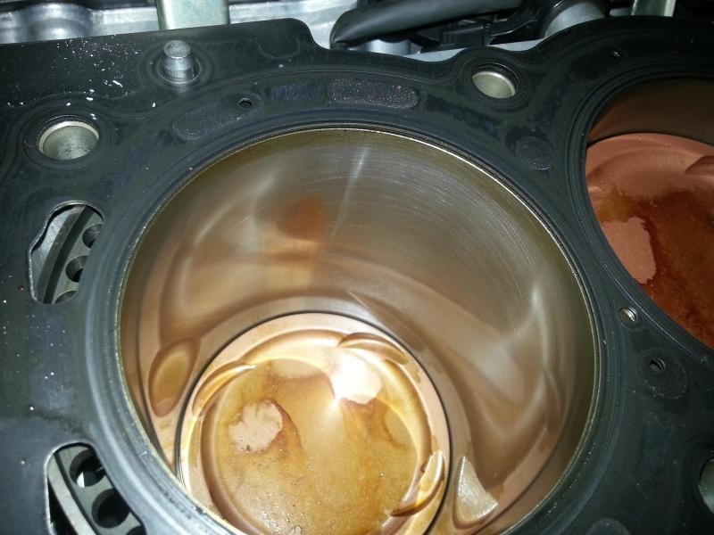

    The larger turbo will be reinstalled once this engine gets the crank re-polished, and them reassembled. As of this weekend, everything looks even better than I had been expecting.
    Just a few pictures to share.
    After seeing what Gadget's engine did, I am getting very excited for mine.

    Yes it is! Considering my fault for the no oil circulation, all of the cylinders on this bank look beautiful. Cross hatch and all. Heads look great, and deck is as smooth as glass.
    Unlike the other sleeved engine, Goldylocks, which had an unevenly machined deck. I must apologize, as I had believed that Darton East had done the deck on that engine and that was inaccurate. APR had "done" that. Either way, that engine, and rotating assembly are all out a Kozmic Motorsports, to head to their machinist. It will be all corrected soon enough.
