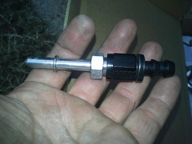

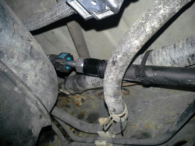

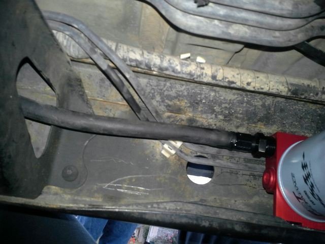

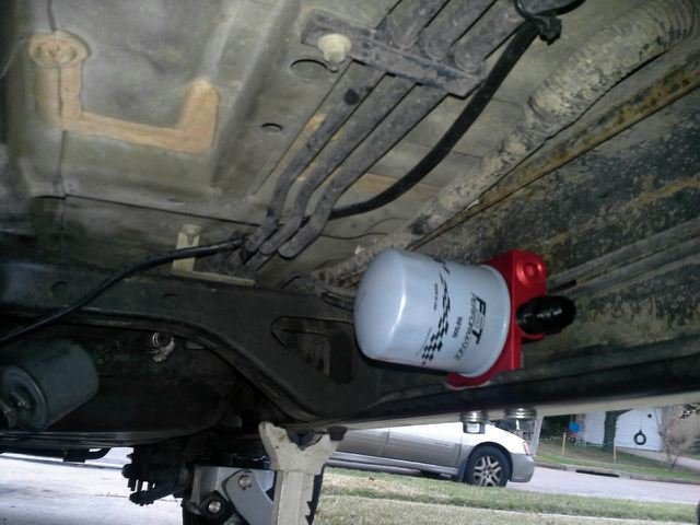

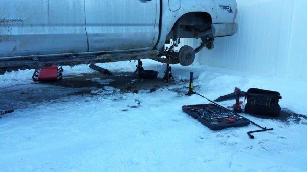

    As much as I could finish before it was to cold and dark.
    Russell Performance 5/16's OEM to -6AN adapter, mated to an Aeroquip -6AN socketless fitting. Plugs right into the OEM line from the gas tank.
    -6AN into the filter and -8AN out to the fuel rail.

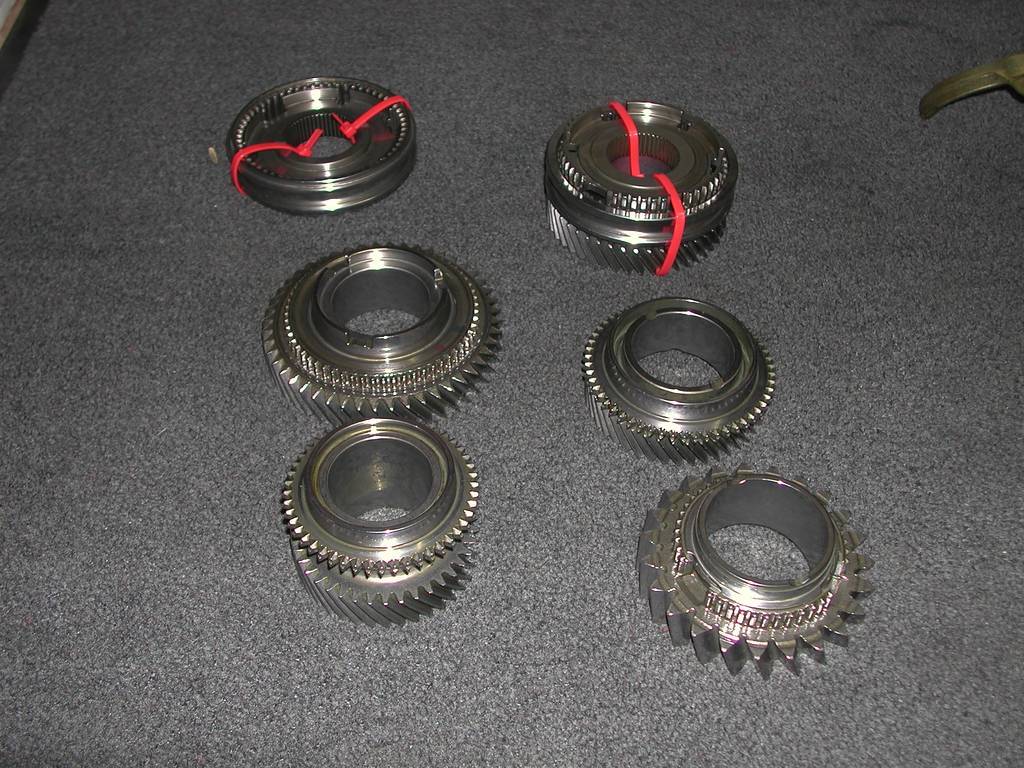

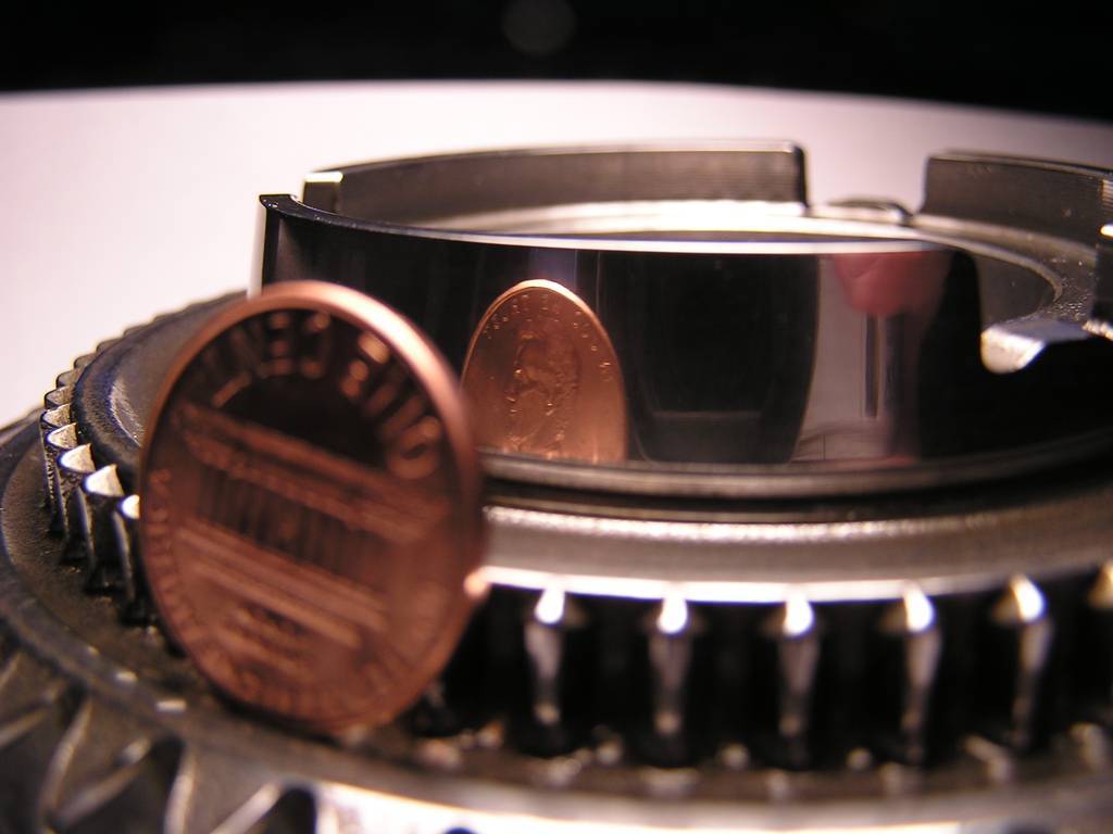

    I had the entire gear stack of my 02M VW tranny treated with that process, along with cryo and heat treatments. Someone is rolling around with a hell of a transmission. :D
    We threw in my old 2nd gear when we sent it out for processing so I would have a souvenir. :D
