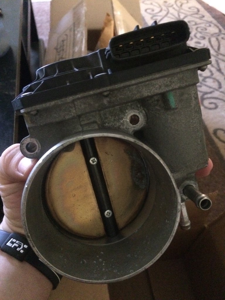

    where can I get a tundra throttle body I have the 76mm spacer and ive had one for years.. :eek:

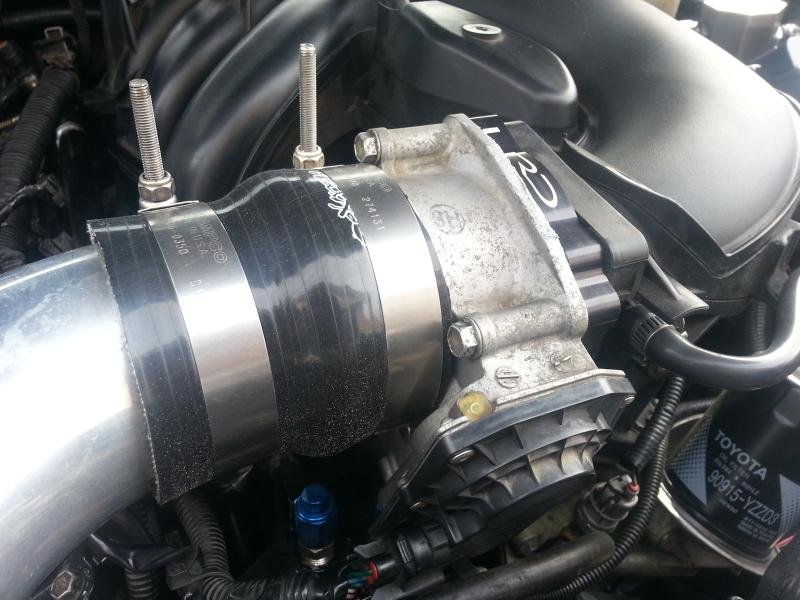

    Like this? :cool:

    Here is the part #. 22030-0s010. 2007+ I ordered mine from eBay through one of the salvage yards. It might have been LQK.
    Let it be noted, that even after having reset the ECU by disconnecting the battery, and the system having released itself, Cold starts, the idle is around 2k RPMs. Once warm enough, it is back to normal. There is a noticeable increase in power. Even with my turbo kit. I am happy with it.
    I used a thin layer of silicone between the battery of the TB, and the mating face of the spacer. Since there is no gasket.
