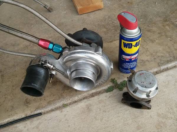

    Hey Mark something to replace my ebay turbo under the hood. Ball bearing, watercooled T3/T04E. This should treat me well and be better for the dirt. WD40 can for size reference. Need to measure it, but looks like a 50 trim compressor and my turbine housing is closing down to a .48AR from the current .63AR should boost a lot earlier and almost no lag.

    It came off a scion tc which is the same displacement. Hopefully the turbo is just waiting to spool at speed. Right now it takes a full second or longer to even start doing anything if I mash on the throttle at 3k rpm. It still is a pretty large compressor side to try and spin up. We'll see. Should be what I'm looking for.
    I miss squirrel performance. It was an amazing turbo calculator.

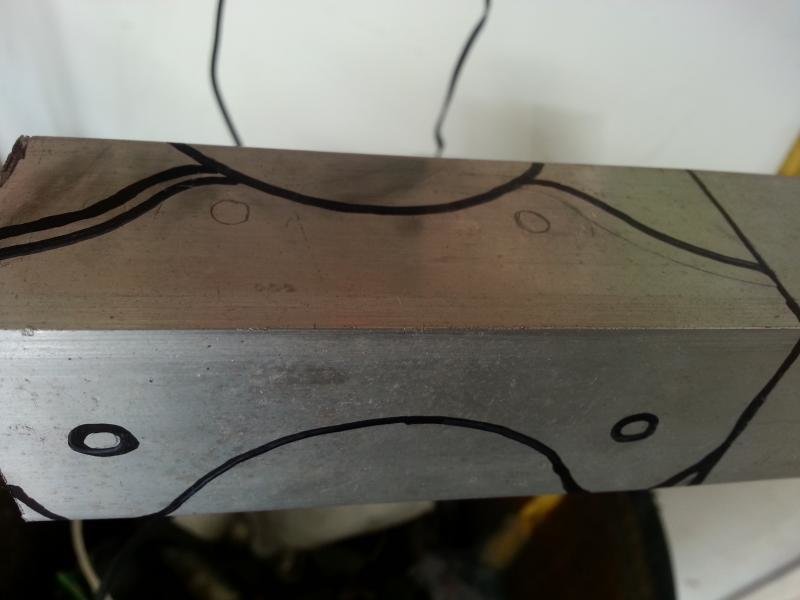

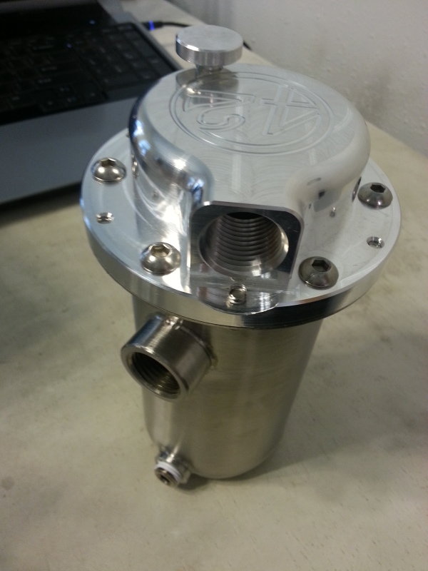

    Started working on trying to mount my Draft 42 Design Catch can. The universal mounting brackets don't work where I need them to. Onto a little DIY. Traced out the bracket from some aluminum angle.
    And the can for those who don't know which one I am referring to.
    Had to order a few more fittings. Then I can do a before and after set of pictures
