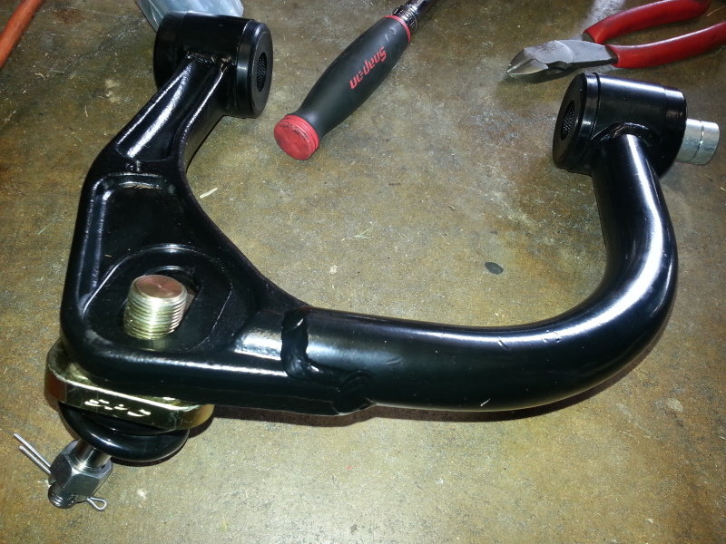

    This is what I am trying for. I need the added articulation of the heim, and simplicity. My angles are pretty sharp due to the drop. Doesn't need to be steroid strong. Lol. I don't have all
    of the off-road forces going on.

    I would consider doing something like this, but having the tie rods being the weak link keeps me from blowing the steering rack.
    So the fancy ball joint adapter isn't necessary if you don't mind drilling out your spindles, is that what I'm seeing?

    Correct. Just wont ever be able to run traditional tie rods without swapping knuckles out

    something like what mike did, and you'd still be good. inner tie rod is what bends on the 2nd gens. do an outer tube tie rod with a rod end, and you still maintain your proper weak point, but you no longer have a ball joint to blow out. would also allow you to run the bolt in double sheer. not so much to the benefit of the bolt, since you don't see many of those bent/break, but more-so for the benefit of the steering arm on the spindle.

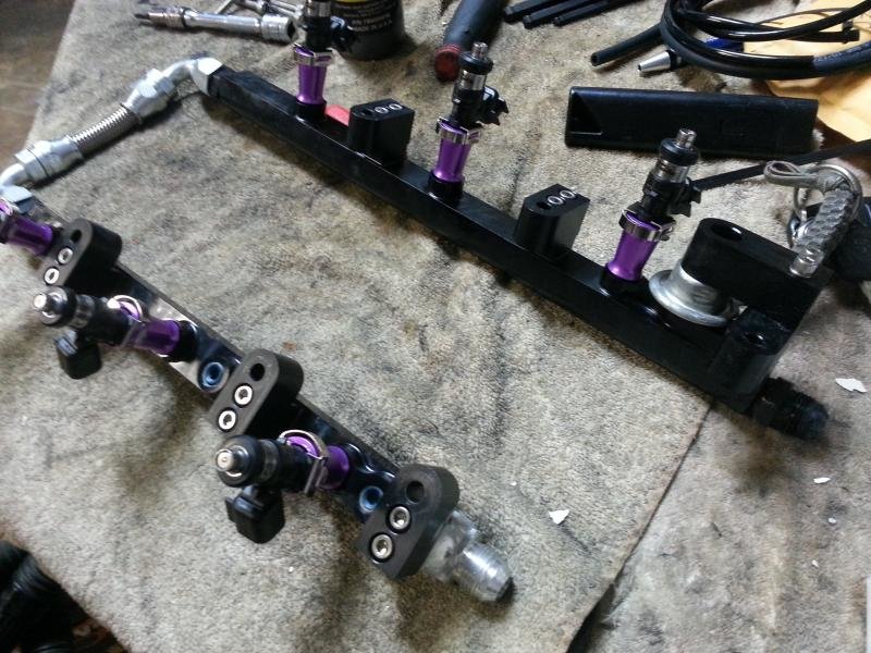

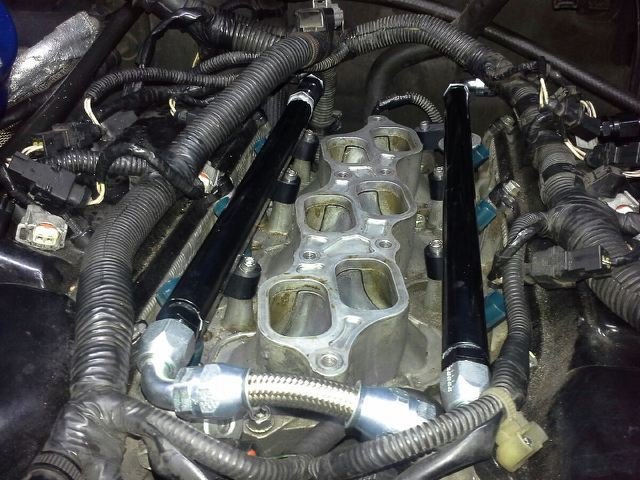

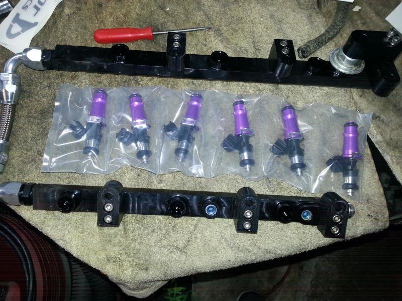

    Another fuel system update. Got around to installing the Injector Dynamics ID1300 's. From this, with the stock injectors to aftermarket.
    I ran into an issue with connecting the harness to the injectors though. The adapter i have are solid. So they extend the plug up much higher then if my harness had the proper connector for those injectors. With this larger fuel rail, the space between it and the head is reduced, coupled with the added height of the adapters, I could not plug them together.
    Long ago, when i had RC Engineering injectors, i changed the pigtails of the factory harness to that of the RC Engineering injectors. Which is an EV1 connector. Point is, I was able to get the wired adapters instead of solid ones, from www.connectorsfast.com. Custom injectors harnesses of EV1 to USCAR (or EV6). Those will be here soon, and I'll be able to fire this sucker up.

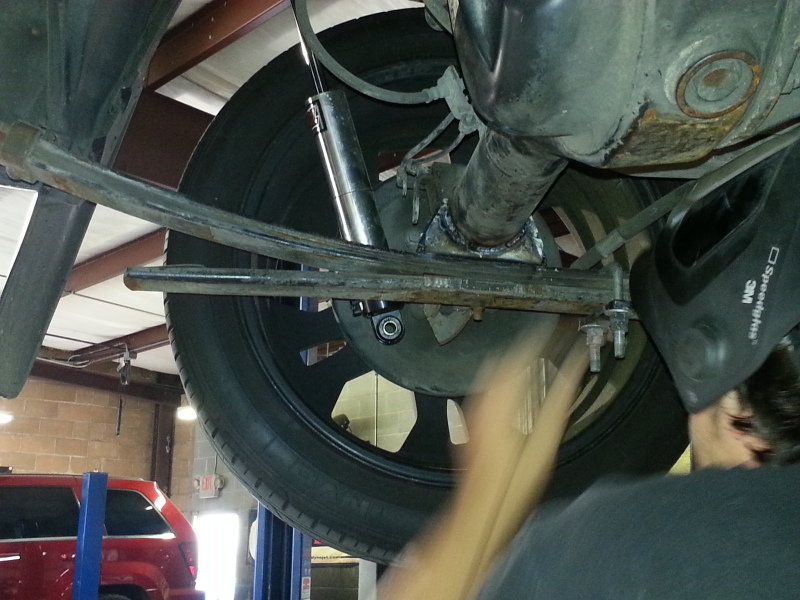

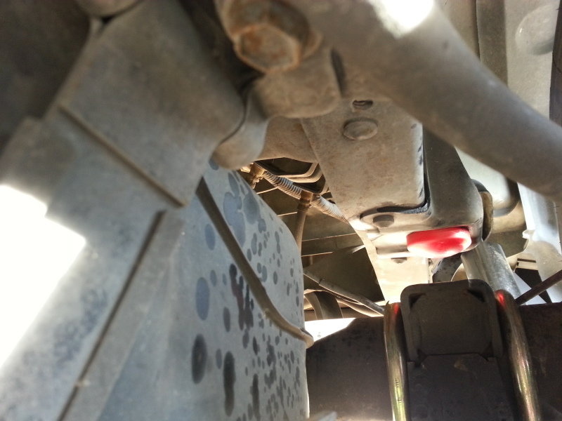

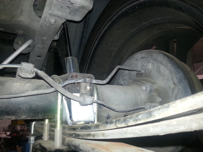

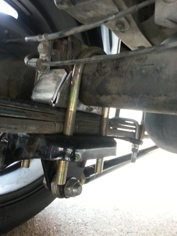

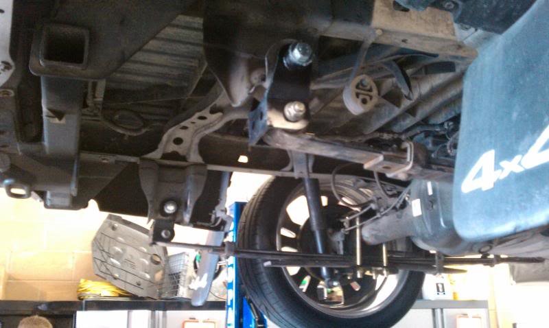

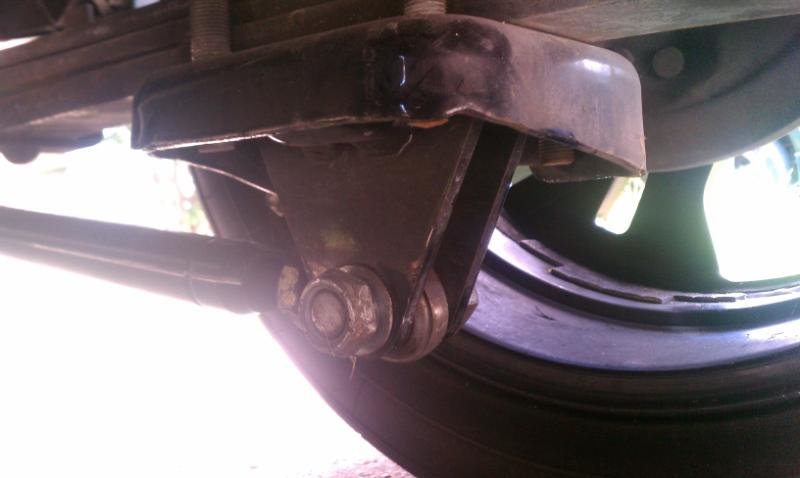

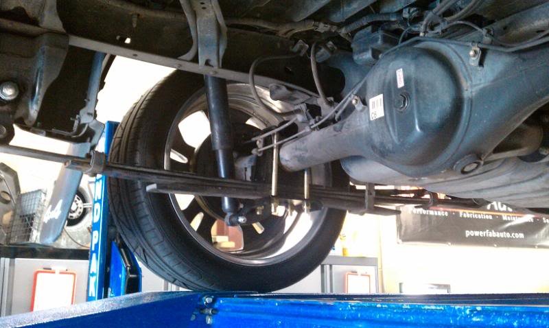

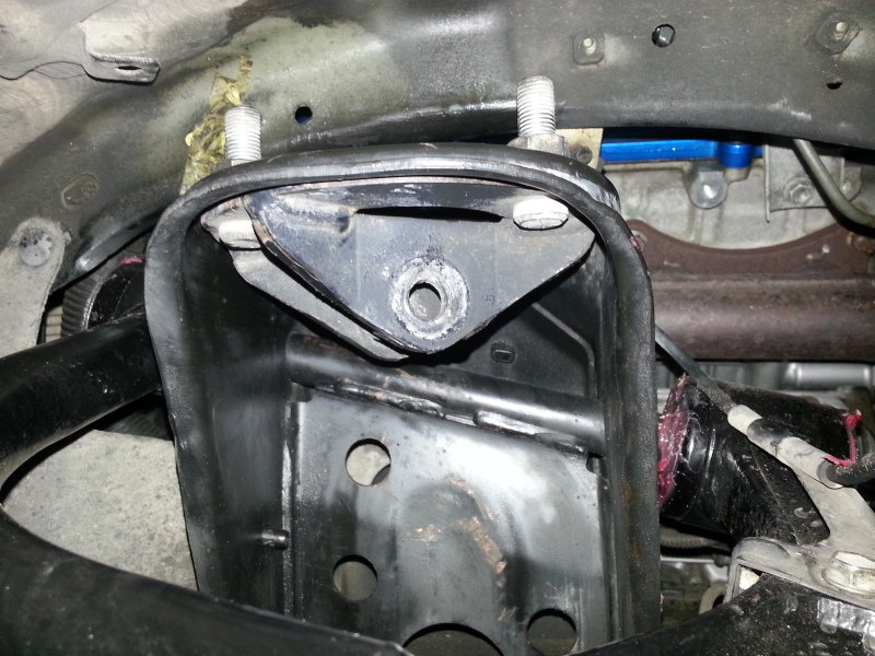

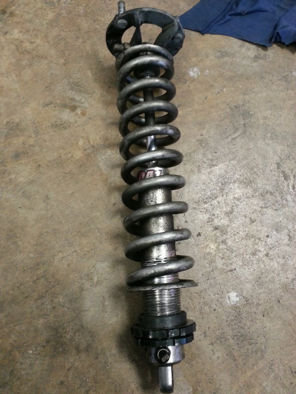

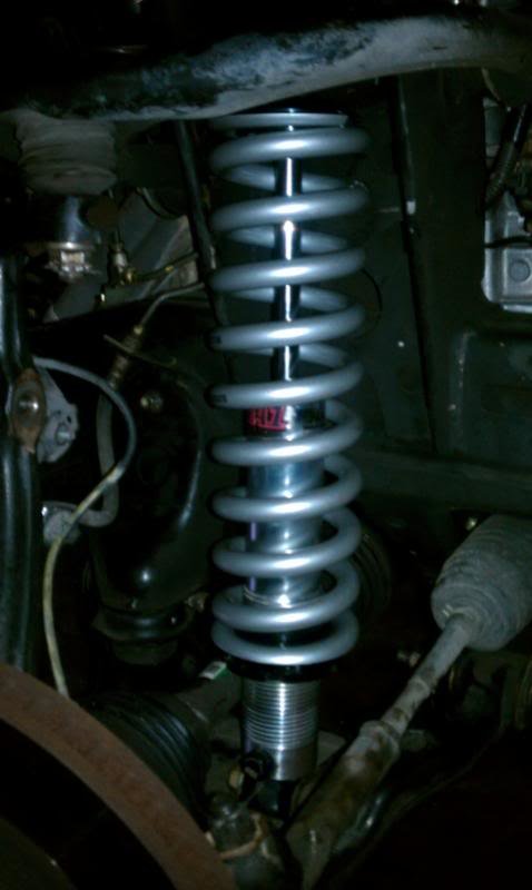

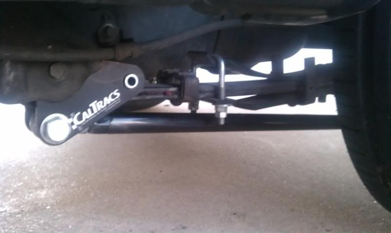

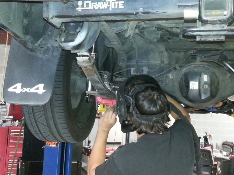

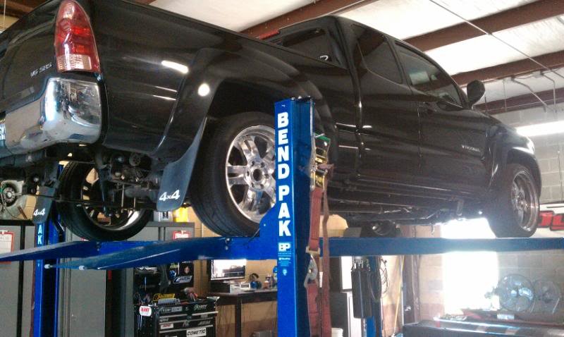

    Been getting a lot of questions about my suspension setup lately. So I am going to post all of the pictures up together, to help out.
    Starting here.
    To here with the Tundra Rear only axle flip kit. QA1 front coil over with ProComp strut adapters.
    Those are Eibach 14" x 2.5" by 600ppi springs. ^^^

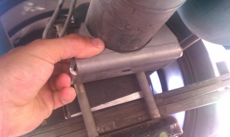

    Had some bad axle wrap, so added on some Caltracs.

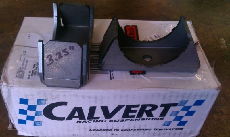

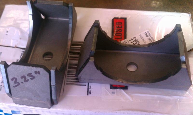

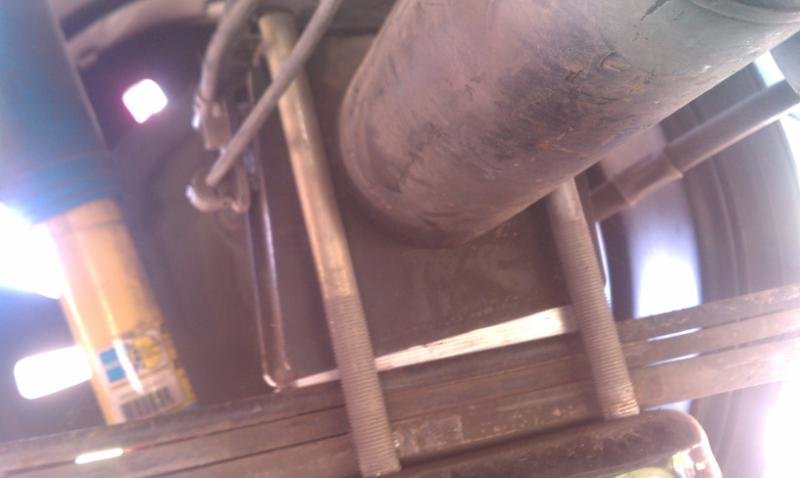

    CAUTION*** Let it be known that these axle perches must be welded together, or the sides will flex and cause the axle to rotate upward!
    Their are other spring under axle conversions available, and their perches are already welded and ready to bolt on. That might be a better option for some people, however, I do not remember where I saw them.

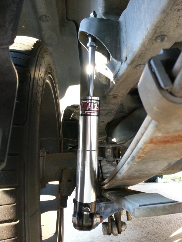

    Back to OEM rear shackles from the Tundra Racing ones.

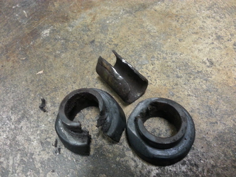

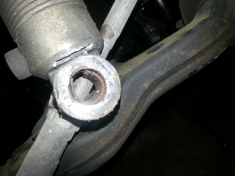

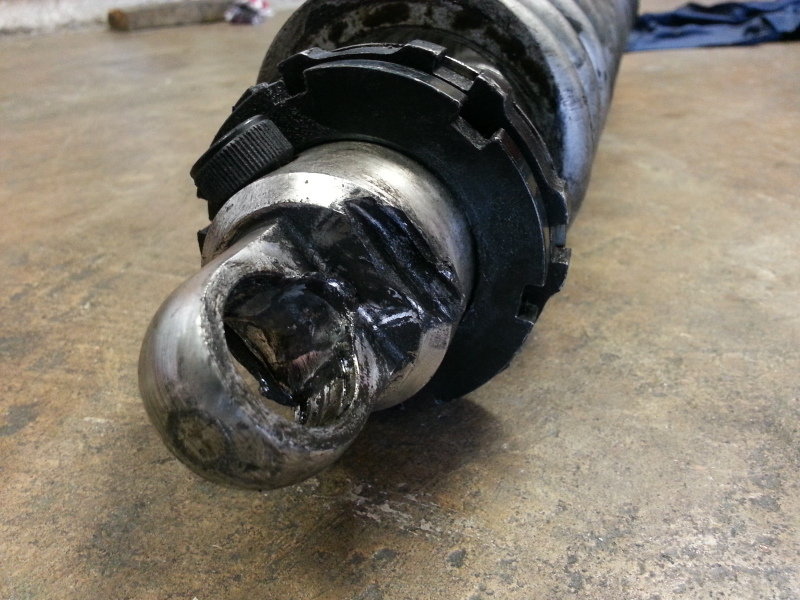

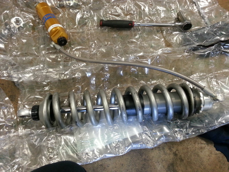

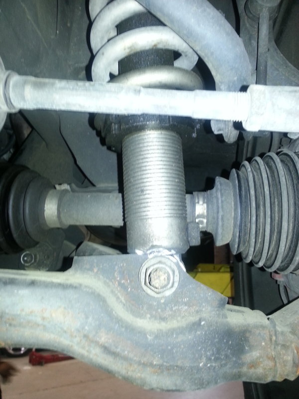

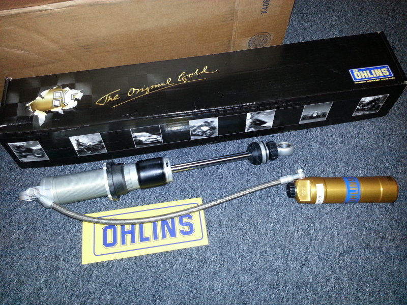

    The QA1 's sleeve never fit right, and this was the damage.

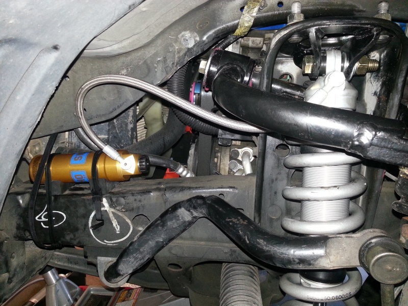

    Upgraded to Ohlins.

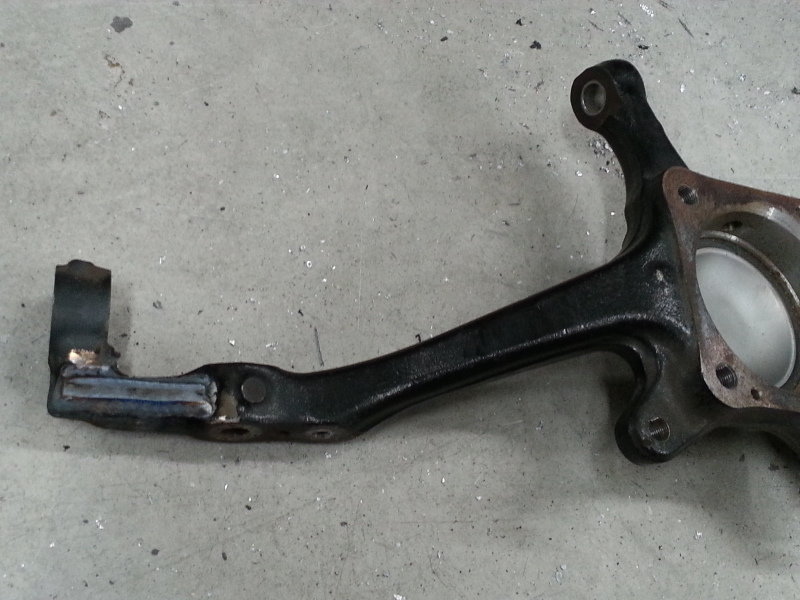

    Took an inch out of the top of the steering knuckles.
    Low pro bumps from www.xiiperformance.com
    That pretty much sums it up, minus the mods needed for the one piece drive shaft, trimming the front bump stops, and front and rear sway bar upgrades. New springs are soon to be 750ppi ftom PAC springs.
