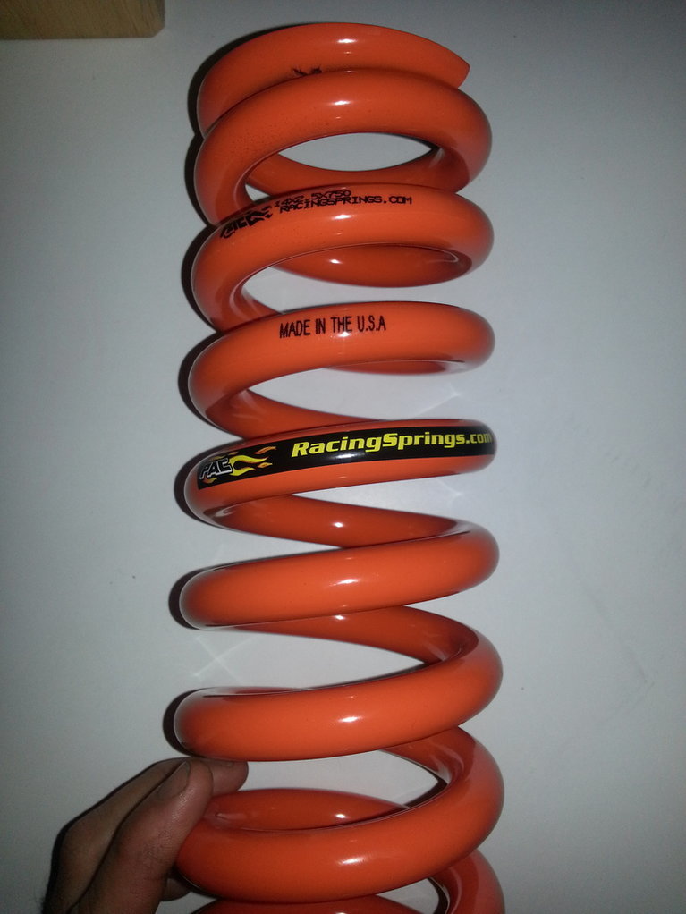

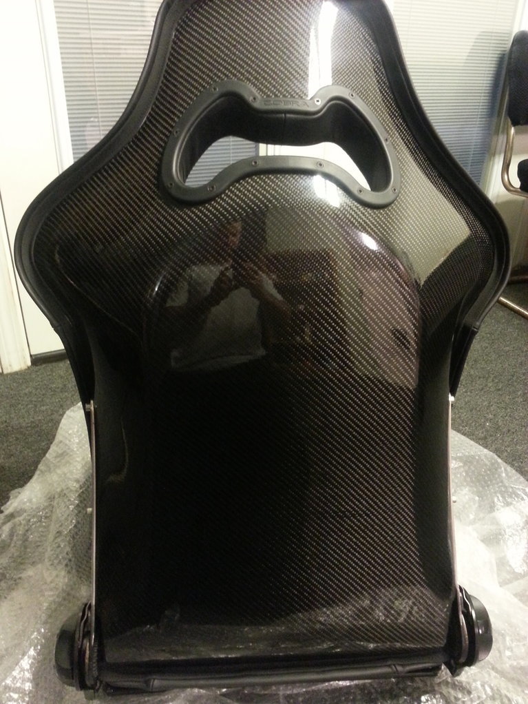

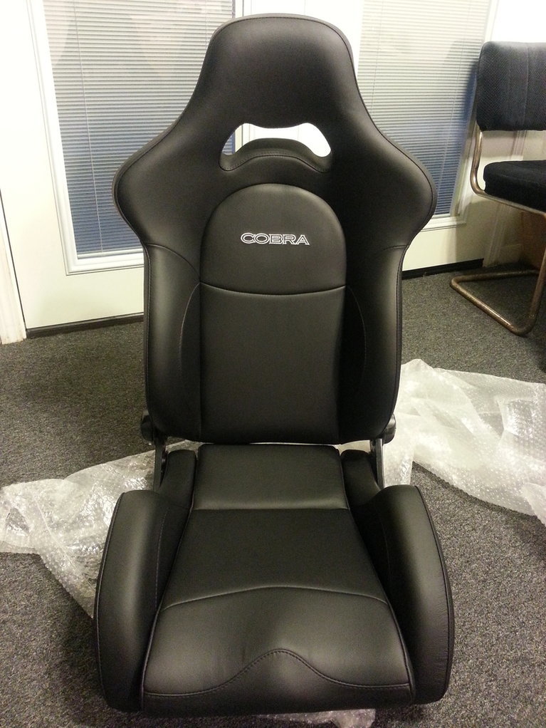

    New goodies arrived today! Woot!
    Now I can swap my springs out.
    And this lovely beauty! :drool:

    That seat is sexy!!

    I see a Markster :spy:
    That seat is bad ass.

    OMG yes! :drool:
    I had the opportunity to order them in different colors. Due to time crunch before the race, I went with what would take less time. As even then, hurdles still pop up...being prepared for those is paramount. Yellow would have been my choice, to match the coilovers.
    Because* ;) They feel very secure on the thighs. That issue of using my knee on the door handle will be alleviated now. However, I feel like I might be in trouble when I start working out again. We'll see what happens when my legs start growing again....
