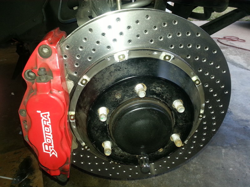

    I'm still running the OEM rear drums. As I have not yet gotten around to the rear disk conversion. It will happen though. I am sure you're referring to the 4Runner rear conversion offered by www.tundraracing.com

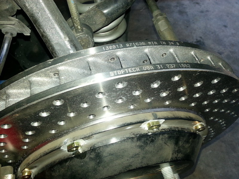

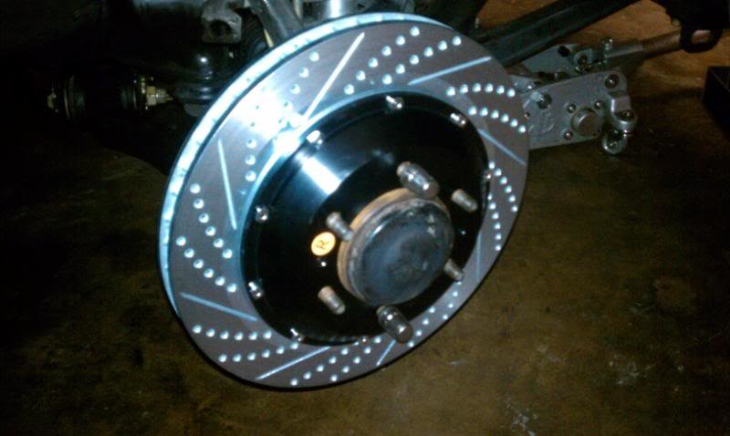

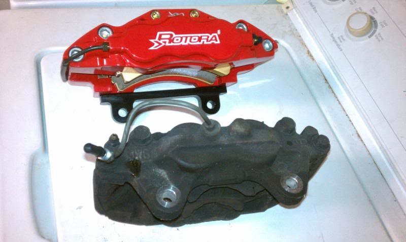

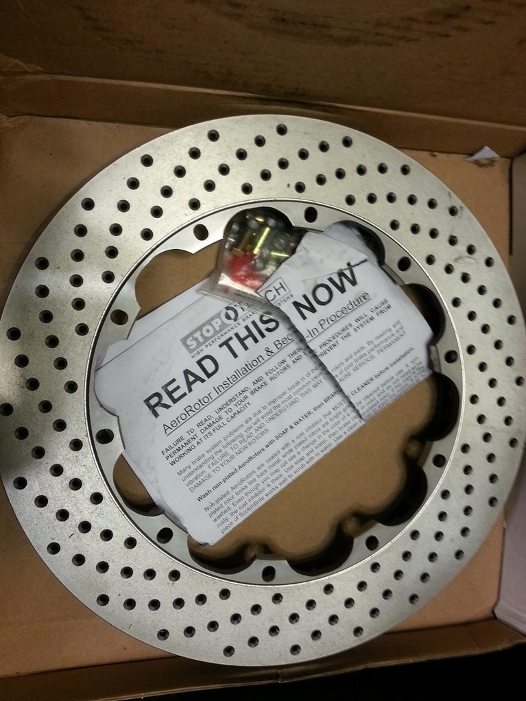

    For the fronts I have the Rotora 6 piston BBK, with slightly modified hats,to fits the Stop Tech rotors. A little cheaper and better quality than the rotors which came from Rotora. They are 355x32 mm rotors.
    The expansion slots on the Rotora disks (just like on the Stop Tech's) started out as pill shape for heat expansion. After three years, they deformed to circles. That meant that the rotors could slide around, in reference to the hat. The iron rotor was softer than the aluminum hat......
    Also as a note* my calipers have been phased out for their newer style. Better forging, better material. Might also encompass the rotors as well. The switch to Stop Tech was due to Made in USA, longer history of quality performance, easier to get parts and/or upgrade.
    Rotora rotor. Drilled and slotted. I wish that i captured pictures of the deformed expansion slots.
    Where I purchased the Stop Tech rotors.
    Here you can see the expansion slots in their natural form.
    A delicate hand with a dremel, and a set of calipers to check. Took material off of the hats for the hardware.

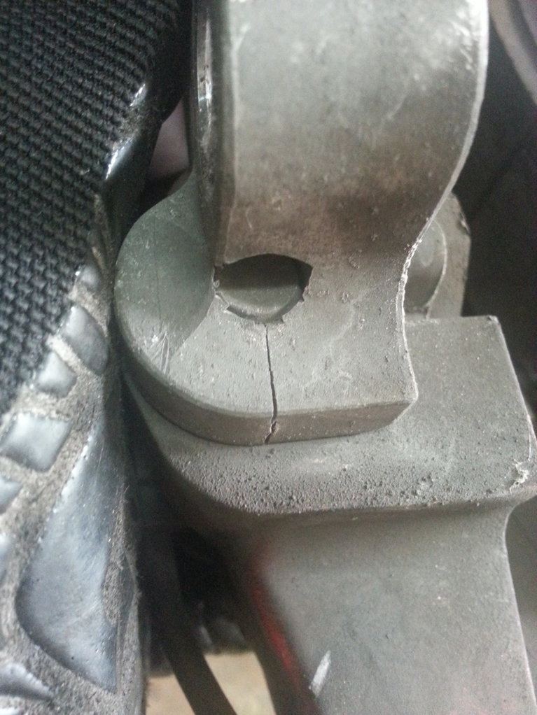

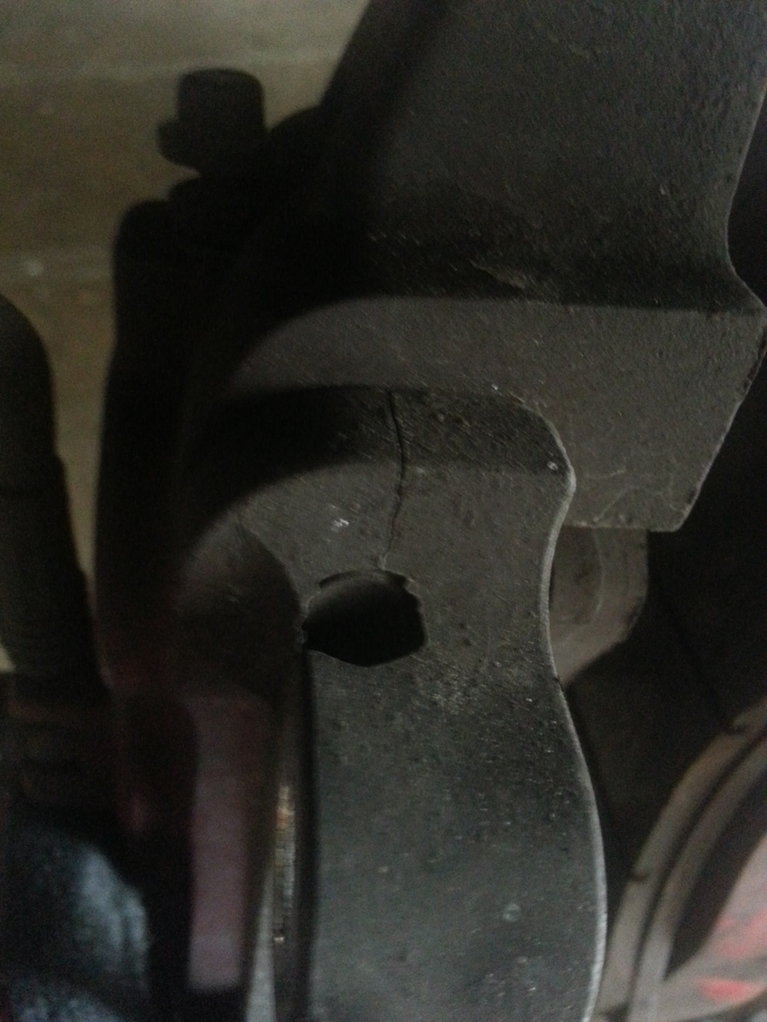

    And the latest issue I found prior to race day. Likely from over torqued. Luckily I had a spare set of brackets. Torque, which recently found out, is no more than 55 lb/ft.
