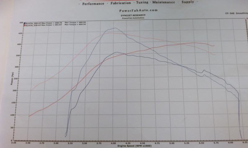

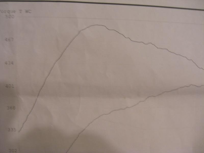

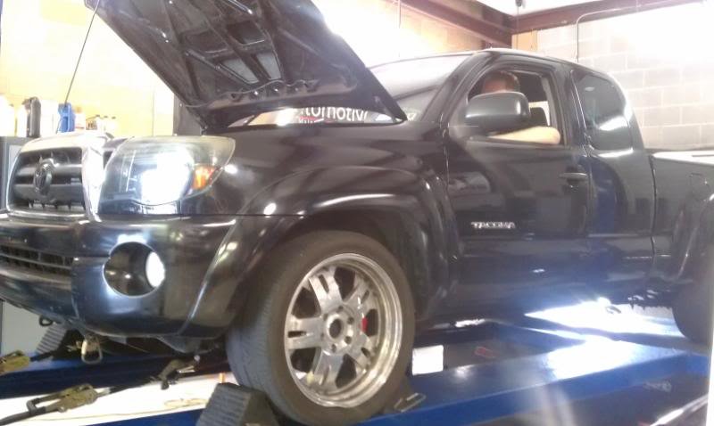

    This video is of the stock (1st engine that came with the truck. lol.) engine, OEM headers, and stock Y-pipe. Map-Ecu2 with 550ccm RC Engineering injectors.
    Made 303 whp and 381 wtq @ 8psi. 3rd gear pull.
    http://www.youtube.com/watch?v=FAS-WGfmb2M&feature=g-upl
    Similar Pull w/ different angle.
    http://www.youtube.com/watch?v=WfUtRdtOcCo&feature=g-upl
    I added the URD Y-pipe and did another dyno. This time in 4th gear.
    Stock engine, OEM headers, and URD Y-pipe. 322whp and 422wtq @ 8psi. 4th gear pull.
    (**No video**)

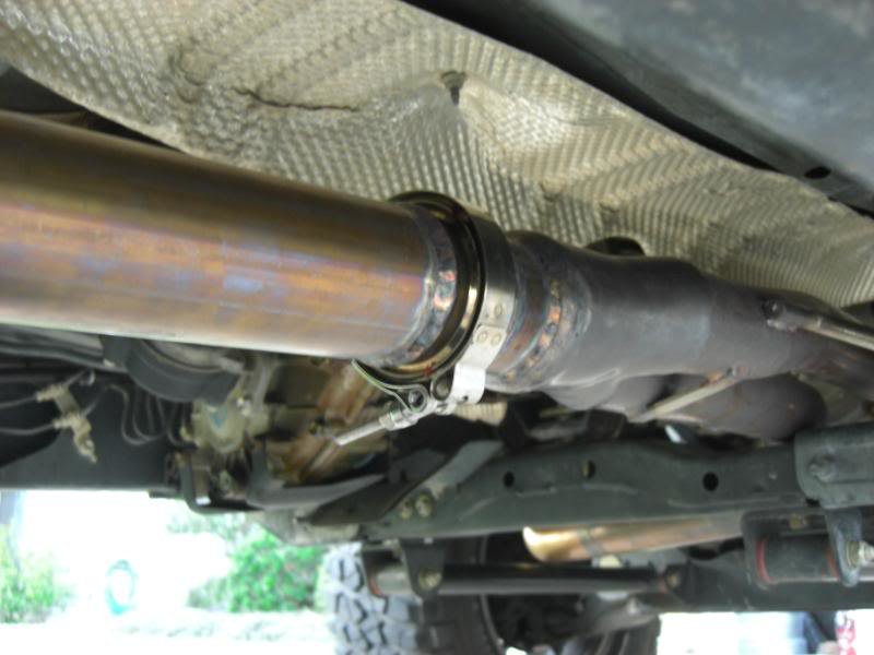

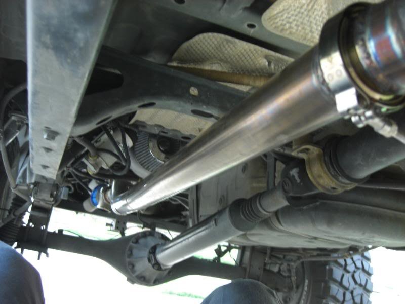

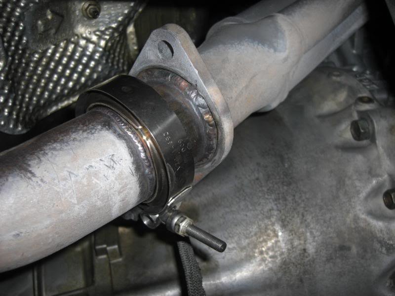

    Modified URD Y-Pipe to fit ProComp lift due to drop brackets.

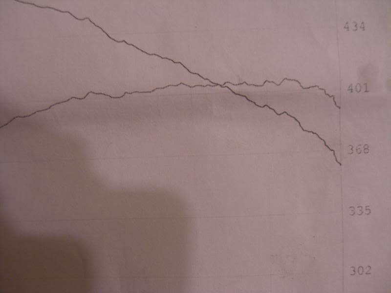

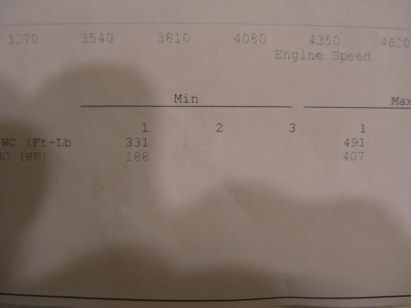

    Engine with JE Pistons( 9.5:1 compression), Pauter Rods, factory heads/gaskets, DTLT's, improved exhaust copmonents. APR X-1
    407 whp and 491 wtq @ 12psi 4th gear Pull
    All exhaust 304 SS, and mandrel bent.

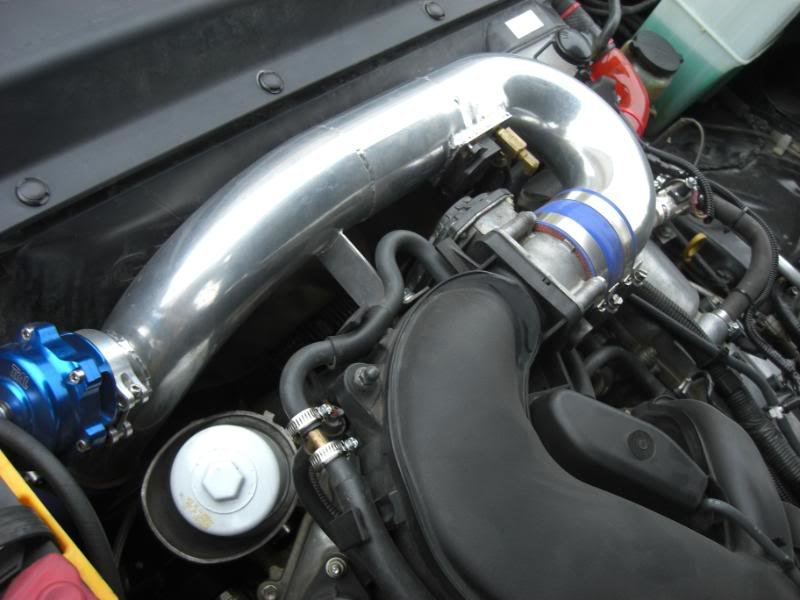

    Also with a "snorkle kit"
    Where the top of the filter is.

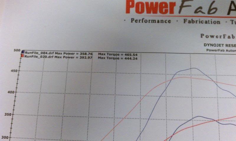

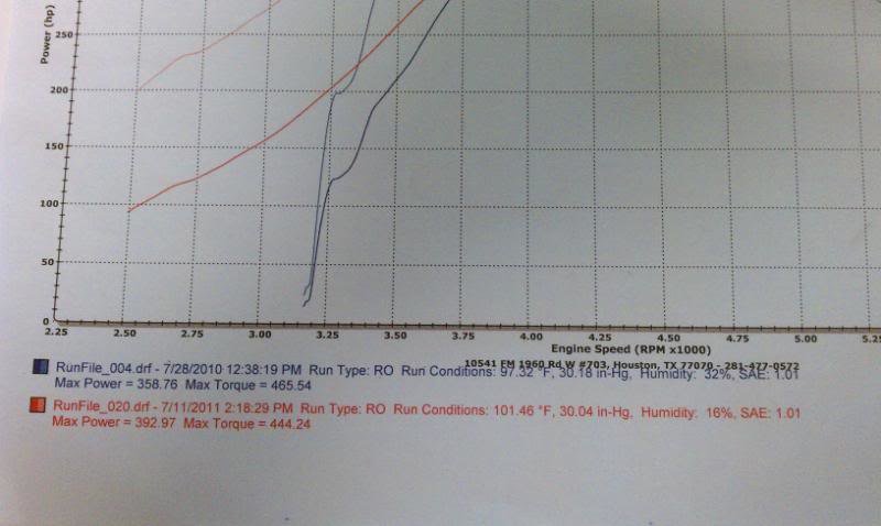

    Second built engine: CP Pistons at now 9.2:1(versus 9.5:1 w/JE Pistons) same Pauter Rods, ARP head studs, Ported and polished heads, dual valve springs w/Titanium Retainers, V-banded exhaust(and still couldn't get the damn leaks out on the setup...FML) APR X-1, DTLT, and upgraded to the Precision 6265 from the 6262 in all the previous dynos. 550 cc RC Engineering Injectors.
    358whp and 465wtq @ 10 psi in 4th gear (Couldn't keep a steady 12 or higher that day...)
    The dyno that is not smooth and has a mountain like appearance is the one in reference.
    And the pics for that dyno:
    http://www.youtube.com/watch?v=zoHcr7dj-bI
    Same dyno sheet as before. With Front mount and ProEFI Pro 128 EMS, same engine as before. Same injectors. Same turbo.
    392whp and 444wtq @ 8.7psi in 4th Gear
