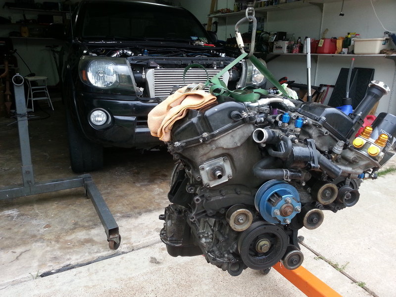

    Alright, here goes:
    - The sleeved stroker and Goldylocks are both at the machinist's right now.
    -Goldylocks getting the deck machined, cylinders honed, and possibly stock crank fixed.
    -Lightly upgraded engine, is in the truck. In the process of being pulled to determine the cause of low compression on cylinder #2. Front driver cylinder.
    -Darton East, which is actually Justice Racing Engines(purchased the rights to use the Darton name) never ordered main studs. I found that the head studs for a 2JZ are the closest match for main studs. However, they have to have the shoulders threaded and length trimmed to fit properly.
    Those studs are at the machisnist's as well.
    Does that clear things up?
    Just dropped the transmission about 15 minutes ago, at that.

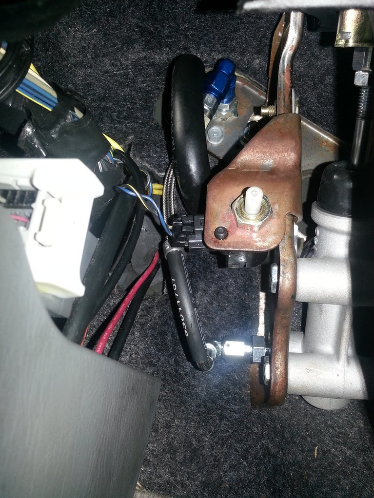

    Not really something big, minus how much a pain in the ass it was to install, but finished upgrading the last line of the clutch system. Now all of the lines are a -3AN from the clutch master cylinder to fire wall. From firewall to clutch, -4AN. I don't remember if I mentioned it a few page earlier, but I replaced the master cylinder as well, not long before the race.

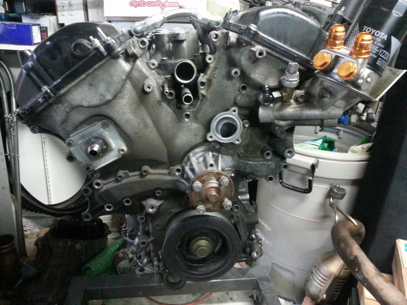

    Been taking my time to get to this point. No need to rush and over work myself. It's been much more stress free this time around, from taking a slow pace. Saturday and Sunday, I leisurely wrenched to pull the engine. Have to inspect #2 cylinder for the reason of its low compression. I do already know that there is a head gasket leak on that cylinder. Might be the only issue. We'll soon find out. If that is the case, then I already know 90% the reason for that.
    ^^^This is a very good picture to see where the turbo's oil feed is. Timing cover is all unbolted. Just need to remove the crank pulley. Then off with the oil pans, timing cover, and heads. I am actually excited to see the what damage has been done. Lol.
