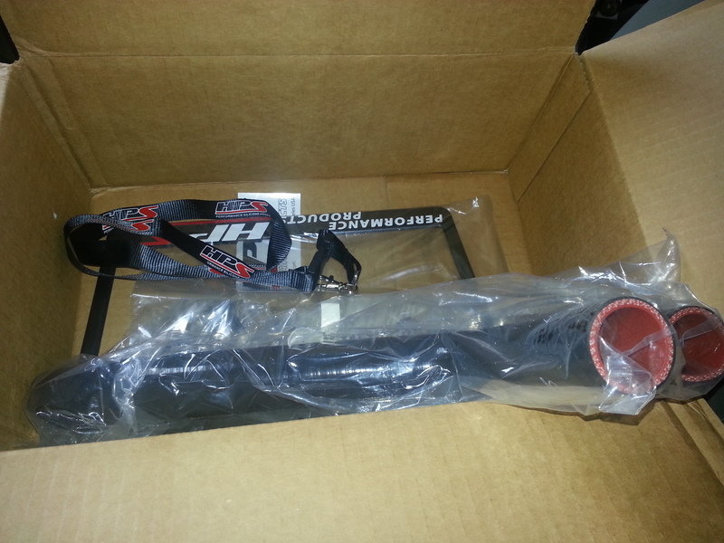

    Had a set of new HPS silicone radiator hoses delivered. Mine are way past their usable life, and showing their signs of wear.

    Ever try a custom steel braided radiator hose? I was thinking about doing that when I swap in my Toyota pick up radiator.

    If I wasn't using the Killer Glass piece, I'd probably have chosen blue. With the coolant being red though, black matches better, for me. Not unique but a better product. :)
    I had actually, and call me a hippocrat , but this is just easier that trying to change the aluminum ends to large AN fitting. As well as adapting the killer glass back into that.

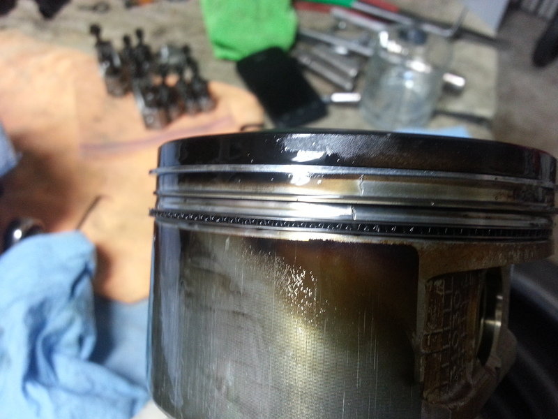

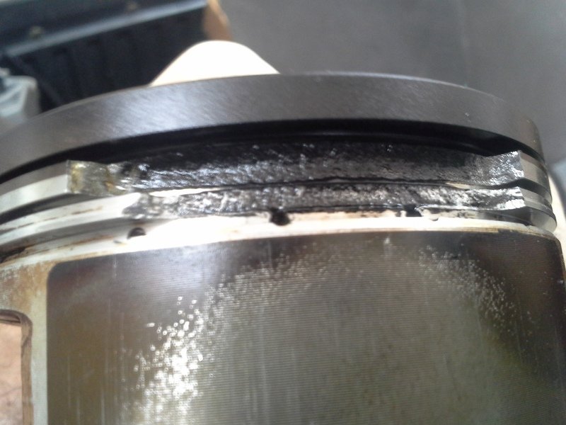

    The broken ring lands.

  14. Jun 5, 2015 at 11:28 AM

    Retorqued the passenger head. A couple of the nuts were loose. The engine is pretty much back together. Just need to install the oil pans.

    What caused that?

    Whoa toasty.

    Bring on the boost!
    Very very likely Hooning around with ~8psi and stock ecu w/stock injectors.....fuel pressure was turned way up but didn't matter and knew it was an eventuality. The addiction is real. I didn't give a damn a needed my boost fix. Ha!
    Sans butter. Good ole 5w-50 saved my cylinder wall.:woot:
