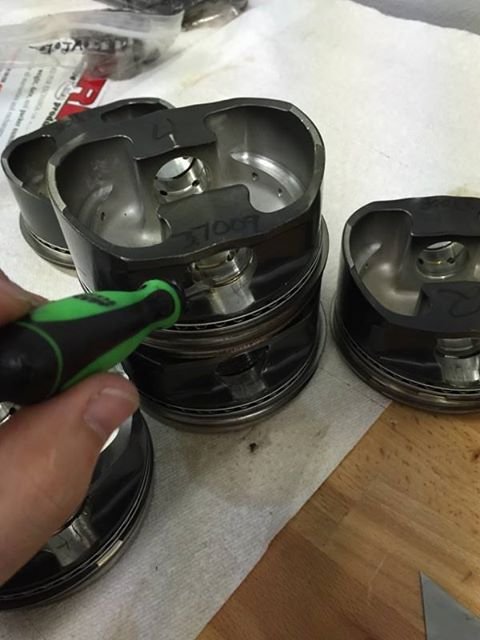

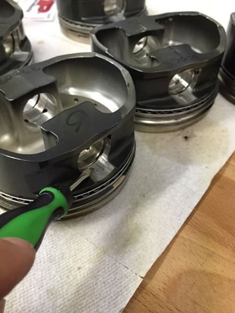

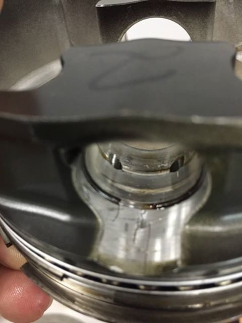

    These pistons came out of Goldylocks. They are my old pistons, prior to going stroker. The wrist pins were deformed/bent, have visible cracking, and collapsed skirts. Detonation destroyed them. New ones are necessary.
    11414795_860329107349405_1369152403_n_zp_d3dac8234d75bb7e9936633f163bd5f0e0e118e6.jpg
    11414657_860329097349406_1608906517_n_zp_24db4283bac530546a97d29f1b5264324b4c6865.jpg
    11421660_860329127349403_315575933_n_zps_2e53f9a3b574bfa321e5b0c3bcc78b68ade1ac83.jpg
    11303414_860329120682737_233909733_n_zps_c09bc1ee6771b67990d1093fb973e7bfe58b32e1.jpg

    Since Goldylocks now needs new pistons, the machinist is determining what he feels a safe over-bore amount. Probably go to 3.800" from 3.701" for OEM.
    I sent the machinist some links about WPC Treatment. He had never heard of it. Did some research and spoke with their President at the office in California. He is very excited to have learned about it and anxious to use it on my engine. Stroker engine is getting the works done, as far as WPC treating goes. Rods, pistons, rings, bearings, and cylinder bores. Very exciting stuff there!
