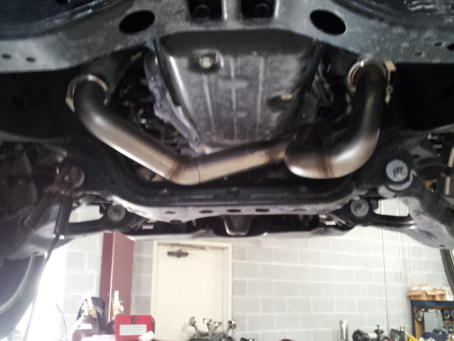

    Toon714 used the DTLT's on his turbo build. Cut the flanges off and used v-band clamps in their place. Properly supported the turbo, and called it a day. They can work. They are 304ss. He was only using ~8psi though. So there would be some heat, but not as much as running more boost. For the level of his build, those were perfect.
    When PowerFab was making a few turbo kits, they basically fab'd shortie headers, then ran straight tubing off of those, merged similarly to the long tubes routing.
    Short tubes can work as well, give you a pitted extra wiggle room, for exhaust routing, and cost less than long tubes. Make sure you get 304ss headers, and make sure you have a support for the weight of the turbo. As well as a flex coupling in the down pipe.
    Since you aren't building a boost monster, the 304 headers will work well and be cheaper than full custom headers. There will still be a lot of fab work necessary though.

    I have the same system as sikx. Headers were already on the truck. It's pretty hard to see how it comes together from under the truck but I'll see if I can find some. 138BCAF9-2E5A-40BB-9827-3B7EC68A9097_zps_08db14b0de30e76c8fe9402b8135a8b9fed7a1ba.jpg

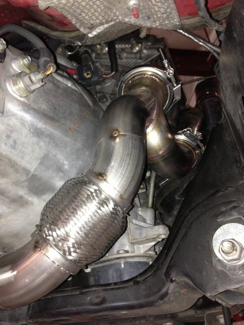

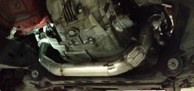

    I also found these. Here's when he was mocking up the system.
    C58B2455-55DA-4A87-90C8-E71FC05C0BB1_zps_d9b6c04edcc7be14dfad3e92471903244cdb70ce.jpg
    50FAE13C-8C61-4D57-A00D-27C35F97E2E2_zps_88cd524faeee8fee43a80a4f96629adc41bf7476.jpg

    is there a benifit to having the down pipe longer as ur pictures or shorter like james? is there a rule of thumb to go by?
