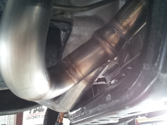

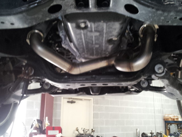

    i meant the pipe that goes down from the passenger side and connects with the rest of the crossover. james' looks to connect about half way down the motor and urs seems to be on the bottom side of it

    That is do to header differences. Doug Thorley long tubes, versus custom short tubes. Working with what was available.
    The long tube version is more of an equal length design, whereas the short tube is clearly an un-equal design. Equal length tubing usually the better, but there are few instances where unequal has better performance. Either, it just depends on what you want to do combined with your spacial limitations.
    Mine is definitely an unequal length as well.
