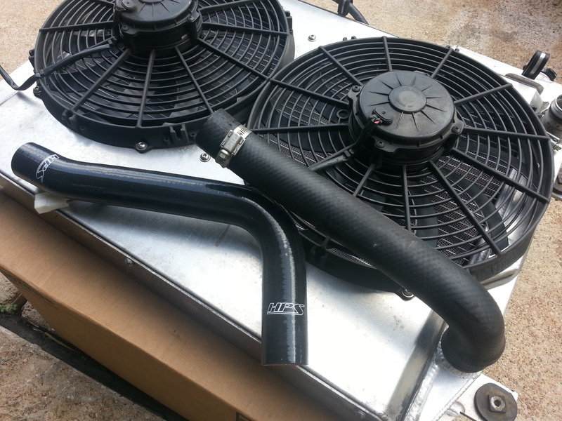

    No big news to update with yet. Engine is installed, and accessories are bolted back on. Went through the process of upgrading the recently upgraded clutch line (in the cab) from a -3 AN to a -4 AN. That way it will all be the same size the whole way through. That line is such a pain in the ass to replace. Still need a stubby 9/16 wrench to finish tightening everything.
    Installed the radiator with the new lower HPS radiator hose. (Which is actually normally the top hose #everythingiscustom) When it was time to install the upper hose with the Killer Glass, I realized that I ordered the wrong size diameter Gates Powergrip hose clamps. The kind which are essentially heat shrink for the radiator hoses. New ones will arrive on Wednesday.
    The HPS hoses are of very nice silicone construction, amd come with all new hose clamps. They were of a better design as well from the older ones which were used.
    Soon enough the transmission will be back in and then on to the new punch list of mods prior to the July 4th MSR track day. That is no small list either.

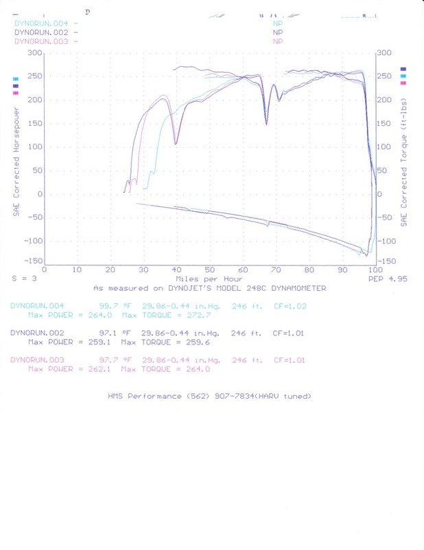

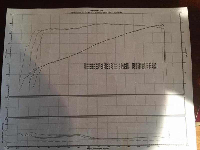

    From his thread >>> http://www.xr-underground.com/forum/showthread.php?t=57083
    I would like to point out how lean the AFR's are.... Even still, it is making very good power for such simple mods.
    Compared to another member's who's more stock setup was barely over 260 whp.

    Wow! So headers and a smaller pulley make that much of a difference???

    I will also throw out there that there will be some slight differences in the two dynos, as well. Within a small margin. However, both exhausts are different sizes, as well as the headers/pulley upgrades.
    Add into the fact that one is an XRunner and the other is a 4x4 with some added weight, and the differences in power will be noticed even further than what the graphs show. Due to power to weight ratios.
    I have never had the TRD s/c, but I have always heard that, "it really wakes the truck up," or "this is how it should have come." Bring on the added boost I say!
    There is a guy on XRU with a 12+ 4x4. He has the 2.55 pulley, NST pulley, Tuned Unichip, meth injection, controller for that extra injector, as well as a few more mods. Out in Cali as well. I would really like to see his truck's dyno!
