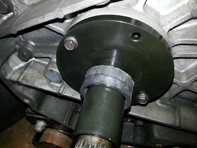

    Ahhh. Now i get you. Yeah. That is a possibility, but you'd need some sort of mounting solution for the TOB. Mine is adjustable, which means a lot of measurements, but do-able.
    The GM style, is non adjustable, but would still need to be mounted somehow and have some measurements taken. That style has the TOB continually riding the clutch springs, with very little spring tension. Then the hydraulics push it to release the clutch.
    I much prefer the straight actuation of mine and the GM style, to the offset actuation of the AY6.
    Any ideas on how to mount it?

    None really. I have lots of research to do yet, and since you were familiar with both transmissions I hoped you may know how straight forward it would or wouldn't be.
    I don't even know how yours is mounted. I supposed it would slide down on the snout, have a set screw or spacer flange it would rest against, then expand to release the clutch. Oversimplified, I know, but I need help filling in the blanks. Weld a flange to the snout for the TOB to rest against? Is there a keyway of sorts to keep it from spinning?

    That is actually the first TOB i purchased. Came with the McLeod Twin disk that I have. After some issues with it, and searching revealed that a lot of people have similar issues, I upgraded to the Tilton T56 TOB.
    http://tiltonracing.com/product-cat...aring/6000-series-hydraulic-release-bearings/
    They have a whole list of them, which could aid in your search, for the proper fitment.
    I am going to look and see if I have any AY6 pictures

    His clutch has a very high release and quite sluggish feel... :(

    Try this >>> http://www.xr-underground.com/forum/showthread.php?t=57057
    As well as adjusting the pushrod underneath the clutch pedal. Those will help dramatically. :thumbsup:
