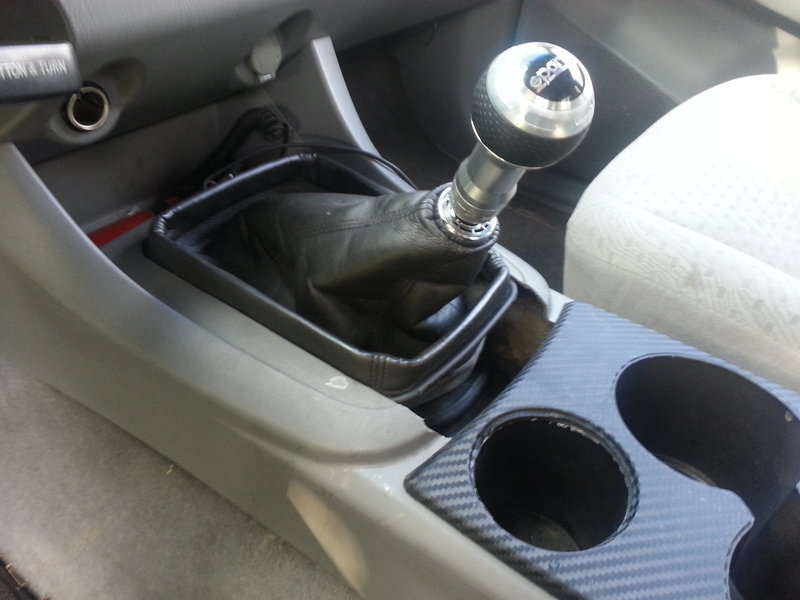

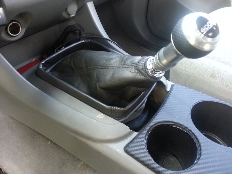

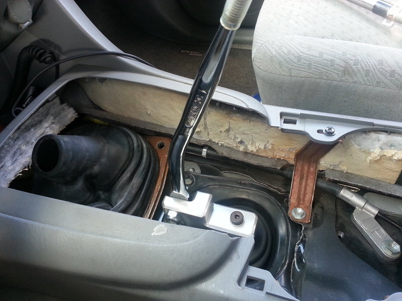

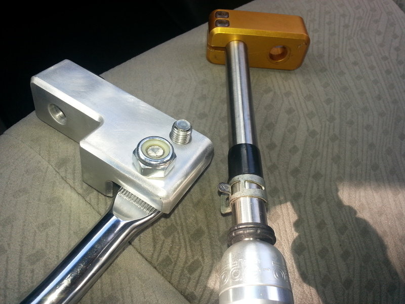

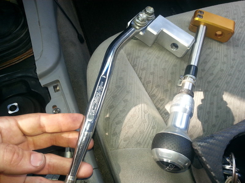

    T56 MGW shifter to Hurst shifter arm adapter.
    Here is a new project that I have been working on. It is the non anodized billet aluminum shifter arm adapter. The MGW shifter assembly's original is the gold anodized piece. It comes with the straight set rod, which sits to close to the back of the leather boot. It became necessary to trim the plastic center console to allow proper shift in in the bottom gears. This adapter no allows me a variety of options of shifter arms, and allows clearance for me to have a proper center console. :woot:
    Been driving it for a couple of days now. I will most likely end up reverting to the style of shifter arm, which is the one I had originally cut. I think over all it will fit just that much better with the center console.
    Neutral position.
    Bottom gear.
    The other arm has a slightly different bend. Should clear the leather cover better.
    The only other issue is when going into the forward gears. The bottom forward most edge needs to be ground down just a hair. To make it have a little more of an angle for clearance. It just barely touches the sheet metal. All in all, extremely happy.
