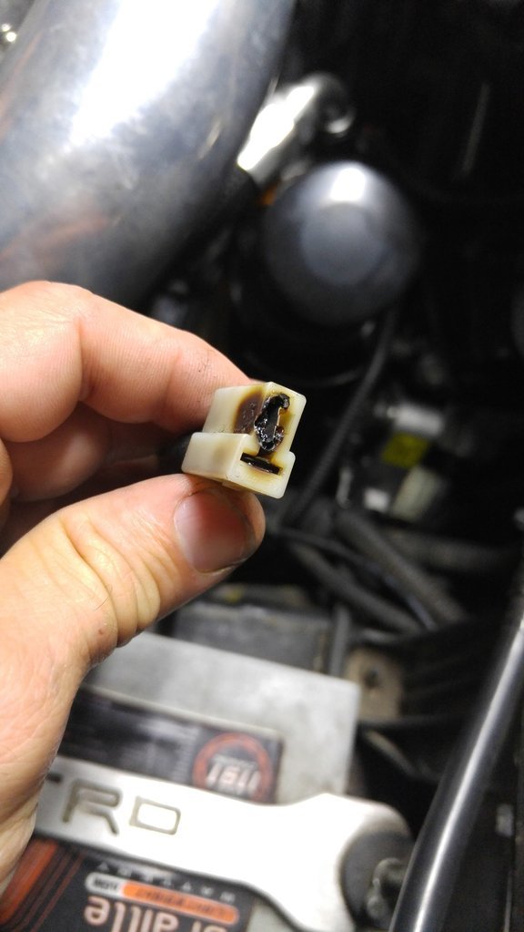

    Ever since I installed the radiator, I have been dealing with the strangest issue. I have attributed it to the Alternator being the measly 80 or 90 amp one that it is.
    When my dual SPAL fans kick on, they draw major current. Enough to flicker all of the lights on the truck simultaneously. If the A/C was on prior to the fans coming on, then the fans reached the tempurature to turn on, it used to blow one of the fan's 30 amp fuses.
    Recently it had stopped doing so. Found out that the connector had ended up arcing and melting, so one of the fans would no longer work at maximum.
    Here is what that looks like
    I had already repaired one connecter. This was the second to go bad and clearly needed to be replaced.
    Come to the rescue of Mouser Electronics! http://www.mouser.com/Home.aspx
    30 amp Delphi connectors, and good to go..Had to select all of the necessary components, but no need to seem as a complaint. Their prices are ridiculously good. I'll snag some pictures of the connectors tonight.
    Sealed Delphi connectors versus these which are not.
