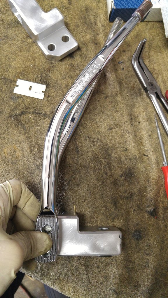

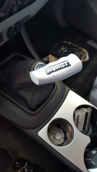

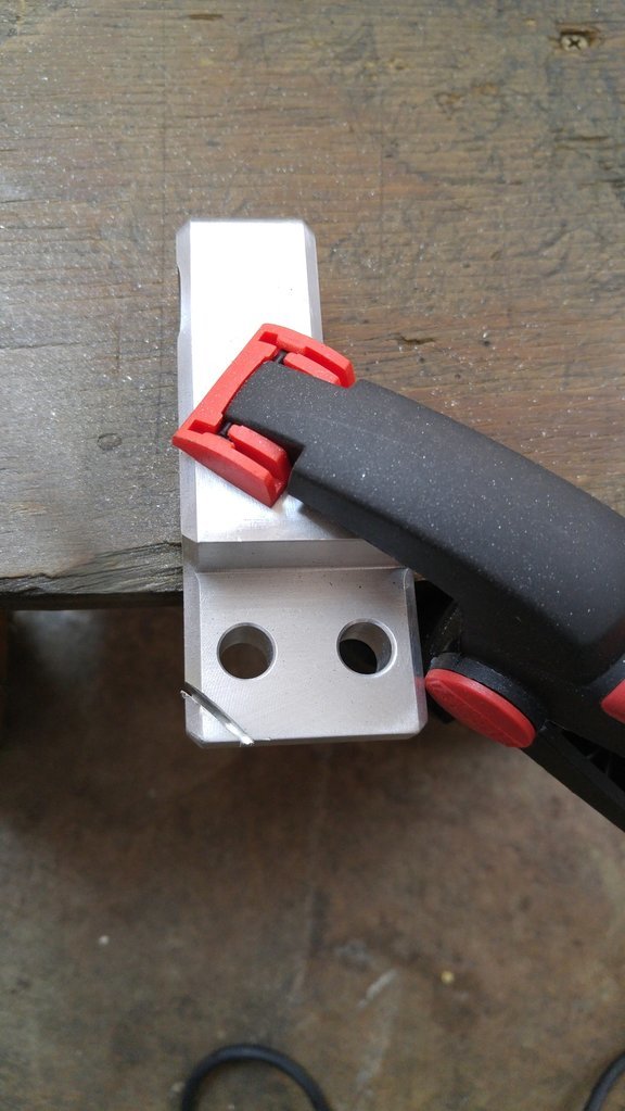

    In the shifter side quest, I've finally got it exaclty where all the pieces fit together like a puzzle. Like a"OEM" puzzle.
    With the added length of the custom MGW shifter arm adapter, the bottom front corner would lightly hit the aluminum sheet metal of the transmission tunnel. That was an easy fix. Grind it off at an angle...
    Problem solved.
    The first Hurst shifter arm was two low at the bend and would hit the leather boot in the even gears. Despite having a comfortable handle location. $75 later, I had another to test.
    You can see the differences in the bends, there. This one had the correct fit for the leather boot and center console, but curved back so far in the even gears, that it sat half way over the cup holder. I had to move my arm out of the way of the center console during even gear shifts. No go.
    $80 later, the next shifter arm came in. Unfortunately I took no pictures of it, so I'll just add a link.
    https://www.amazon.com/gp/aw/s/ref=is_s?k=Hurst+5388009+Shifter+Stick
    That one fits "perfectly." Momma bear shifter.
    You know, if the damn shifters had more thorough specs, this could have been a lot cheaper.... :facepalm:
