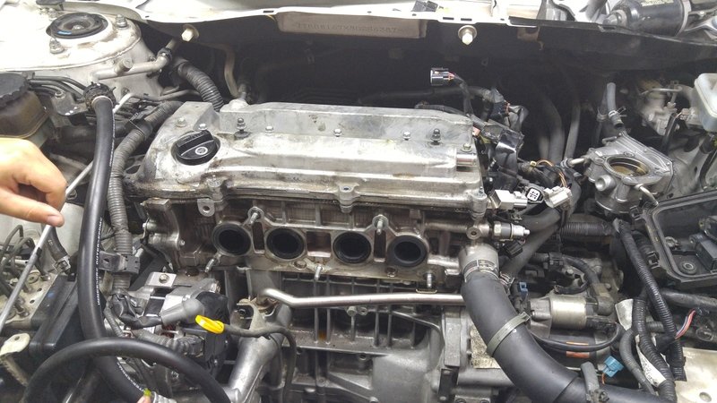

    2AZ-FE head removal. In all of its ingloriousness.....
    Decided to take a "short cut" and not pull the timing cover. No way I was doing that if I could get around it. Point is, if you @HomerTaco or @Moose1988 ever have to deal with a head gasket issue, then these are some of the things you'll encounter.
    After setting up timing this is what we did.
    Had to loosen the exhaust cam gear bolt and thread it out a bit. Then in sequence, loosen the cam bearing caps. Once those were done we slid the cam gear off of the cam and onto the loosened bolt. While also holding tension on the timing chain. Then carefully tilted the cam while unthreading the bolt the rest of the way, making sure to keep tension on the chain and not dropping the cam gear.
    While holding the chain tight the other person lifted the intake cam gear out. We then tied off the chain so that it didn't loose its place on the crank gear.

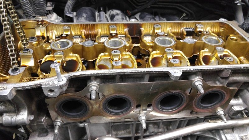

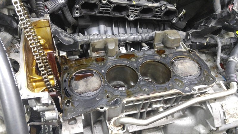

    This is a very tedious project with a lot of hardware in very difficult locations.
    Front engine mount and passenger engine mount were both removed. To be able to get jack the engine front to back so that we could access the intake manifold.
    There are three bolts and two studs which go through the timing cover into the head. The two studs are an E5 external torx socket. They must be removed if you want to pull the head without removing the cover. The cam sensor must also be pulled from the back side of the engine. As it blocks a head bolt.
    Here is the good news. The head bolts are over torqued from the factory. If you go onto Amazon and look for a head gasket kit for this engine, the "Frequently Bought Together" item is a Timesert kit. Since it is nearly impossible to remove the head bolts without pulling out the threads. A kit is made to effectively helicoil repair the holes.
    I had no desire to have to repair those threads, much less buy that kit at roughly $450.
    My method to try to circumvent this problem was to do a multi-step de-torquing process. With a 12mm triple square for the head bolts, loosened each bolt slowly until it "popped". In sequence. It took roughly 15 times of de-torquing each bolt in sequence, until they were all loose and could be removed by finger. It payed off though.
    Nothing on the threads of the bolts and all look perfect in the block. Doesn't mean I'm in the clear yet though, as I still have to reassemble. So far so good though.
    After they were all out, we lifted the head a little and slightly rotated it towards the firewall. To be able to reach the exhaust chain tensioner bolt which attached it to the head.
    Then we were able to pull the head off.

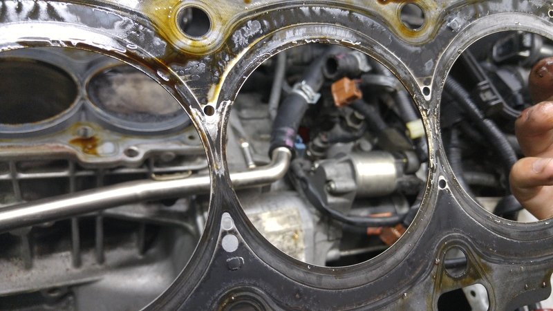

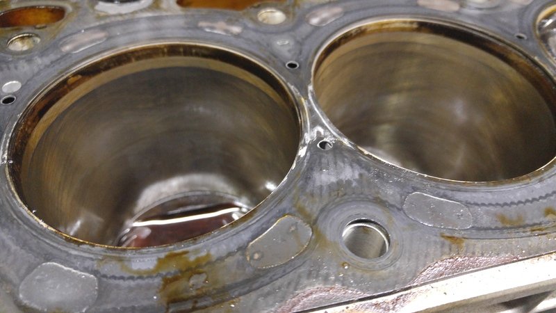

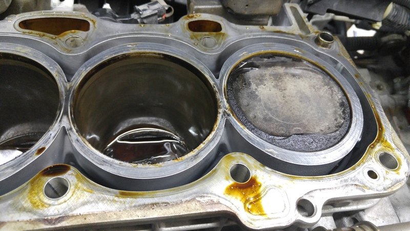

    With the head off, it was easy to see where the gasket had failed.
    Right between the center two cylinders.
    The deck of the block is perfectly fine. Still need to verify with head.

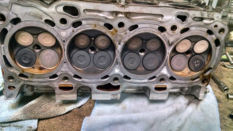

    Next step is to do a back yard approach to see if the head is still straight. A straight piece of metal and a flashlight.
    Torspd[OP] and thekernel114 like this.
  12. Oct 30, 2015 at 1:16 PM
    #3692
    Torspd
    Torspd [OP] Tor-nication
    Sep 18, 2009
    #22958
    26,453
    Tor
    The Great America!
    MMVI 4.4L 4x4 Access Cab
    Torspd Custom Turbo kit [] Borg Warner 9180EFR Turbo [] Haltech Elite 2500 [] TiAL Q BOV [] TiAL V44 Wastegate @ 15psi [] CP Pistons [] CP Carrillo Rods [] ARP Head studs [] ARP Main Studs [] ARP Header - Head Studs [] Ported Heads w/ 1mm oversized valves intake/exhaust [] Brian Crower Forged Stroker Crank [] Darton M.I.D. Sleeved Block [] Kelford Camshafts [] Torspd 160* T-stat mod [] APR Large Fuel Rail [] Walbro 460 LPH E85 Fuel Pump [] FueLab FPR [] APR T56 Conversion Kit [] KP RACING Built T56 [] McLeod Racing Custom Twin Disk Clutch [] One Piece Aluminum Driveshaft [] MGW Shifter [] Custom lowering kit [] Ohlins Front Coilovers [] QA1rear shocks [] Custom Ron Davis Radiator [] Dual SPAL Electric Fans []
    Precisely straight
