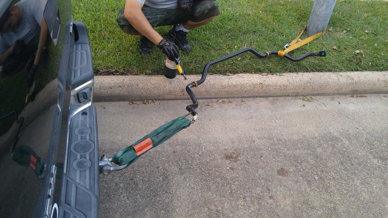

    Also. Forgot to add this update. A little "suburban engineering" per say. :anonymous:
    The Addco sway bar was already extremely close to the Eibach 600ppi springs. So much so, that it would rub the spring during full droop. When I installed the stronger PAC Racing 750ppi springs, there was no possible way to make the sway bar bolt up as-is. So I drove around for a few weeks without it installed. Debating how to go about overcoming the issue.
    This is what I finally decided on. Enjoy our "Roadkill"-esque modery. :laugh:
