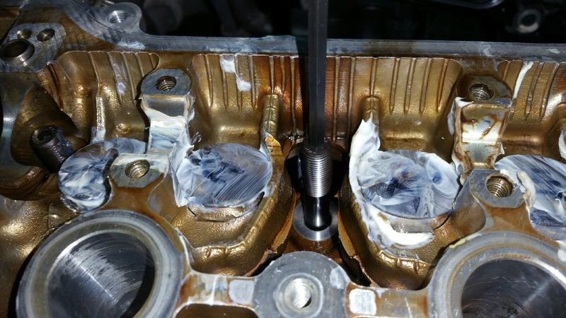

    Encountered another problem with the Scion tC last night. We ordered ARP head studs from Summit racing, for the 2AZ-FE. Received them yesterday and installed the head. Proceeded to install the studs and then I noticed this....
    Bottomed out, the shoulder sticks out this far above the surface of the head.
    Definitely will not work. Apparently Dezod is the only place which sells them at the proper length.
    I did come across something interesting though. It looks like the head studs for the 1GR are a direct drop in to the 2AZFE. Since the head bolts are the same. I just need to grab a stud from the machinist to verify.
