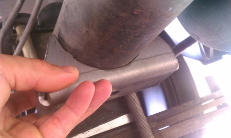

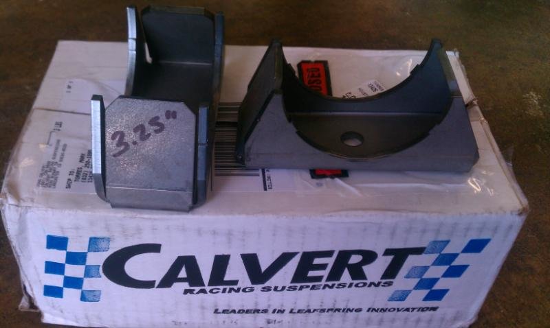

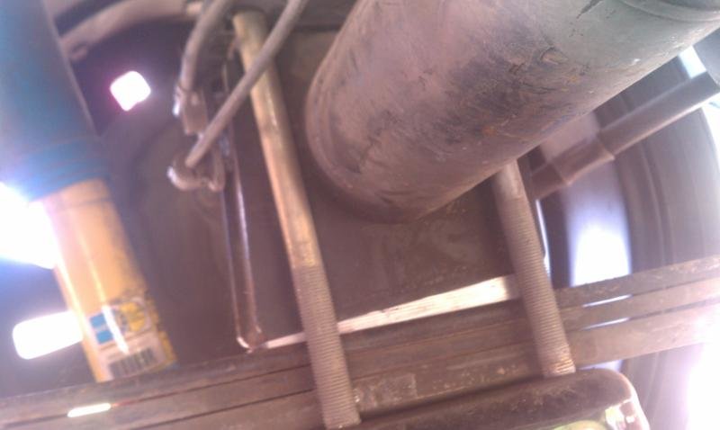

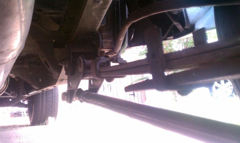

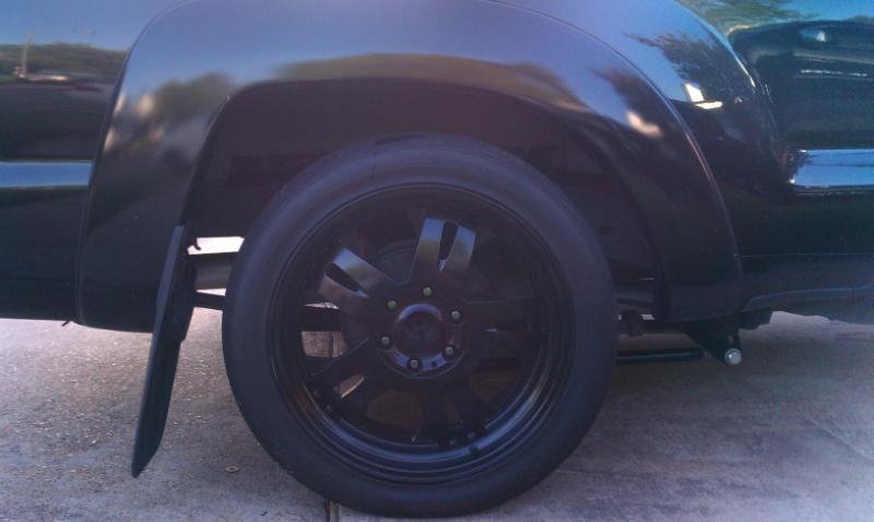

    Here are the HD axle perches that I installed this past weekend. From Clavert Racing.
    Sitting next to the Tundra Racing perch.
    Tundra Racing perch with a shim.
    Still need to properly adjust the traction bars, but I will wait until I have all of the weight in the truck.
    And lastly a pic for reference.
    Also note, that I had to swap the Tundra Racing shackle out for the factory one. Otherwise it would have been a lift. The main reason for these Calvert racing perches is that with the Tundra racing drop kit, my truck always sat about 3"+ higher in the rear than Toon's did. And I installed the same drop on his truck.
    Most likely due to his leaves and being a '09, versus mine being an '06.

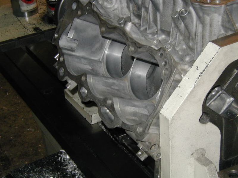

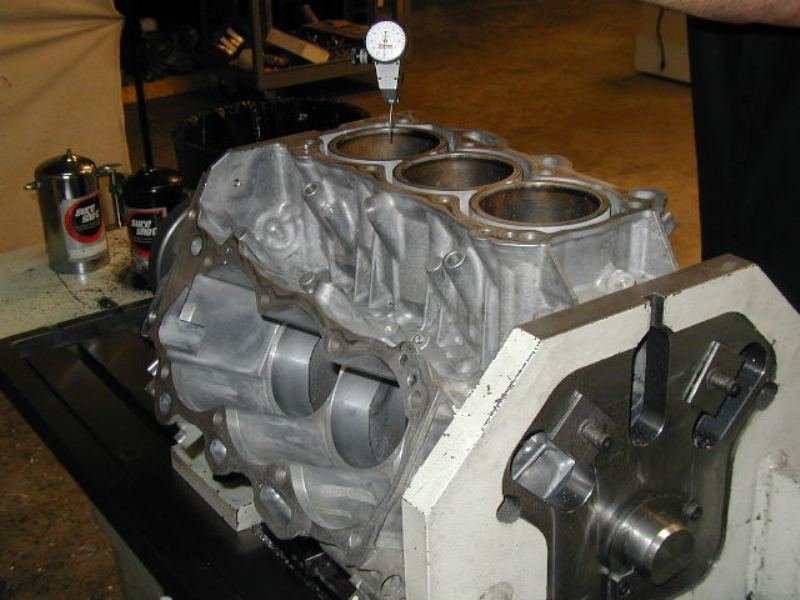

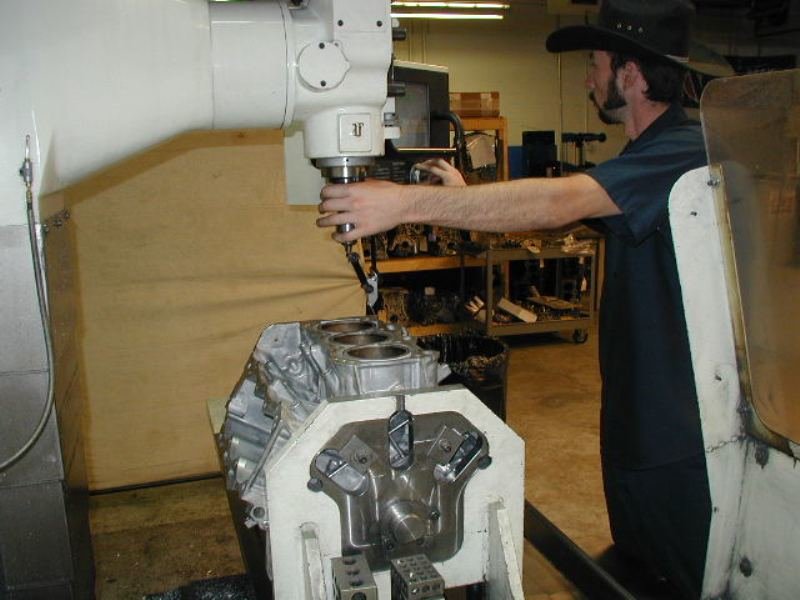

    Still need to get the time-line of pics up, to get everything caught up to today.

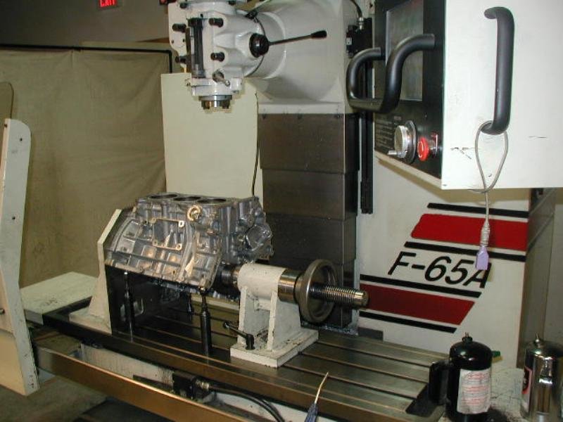

    But here are some pictures that couldn't wait. :D
    Courtesy of Jim at Darton East.
    And a close-up of the sleeves all machined out....This is getting very exciting!
