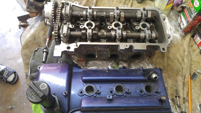

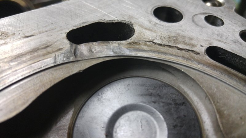

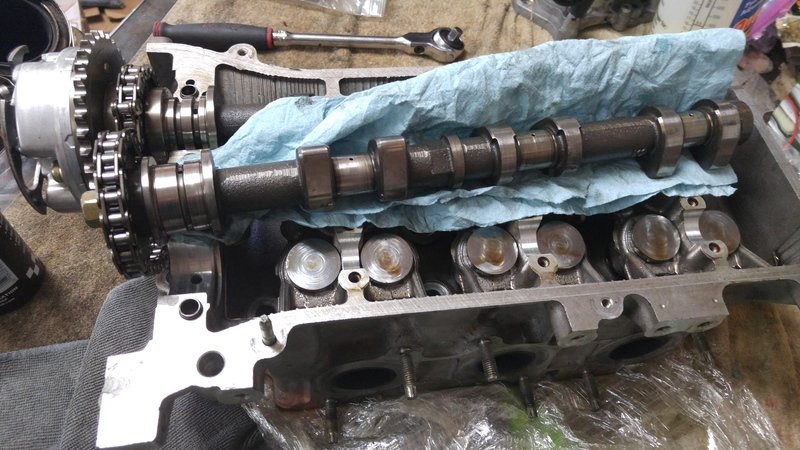

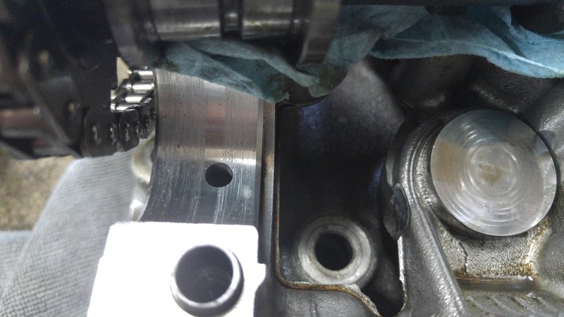

    Pulled out the heads to inspect and clean last night. The set which came with Goldylocks. The driver side's mating surface was perfect. The bearing caps and cam recesses however, showed some wear due to low oil or loss of oil. The passenger head.....that one is in far worse shape.
    Here is the driver side, bank 2, head.
    There is an example of the driver side.^^^

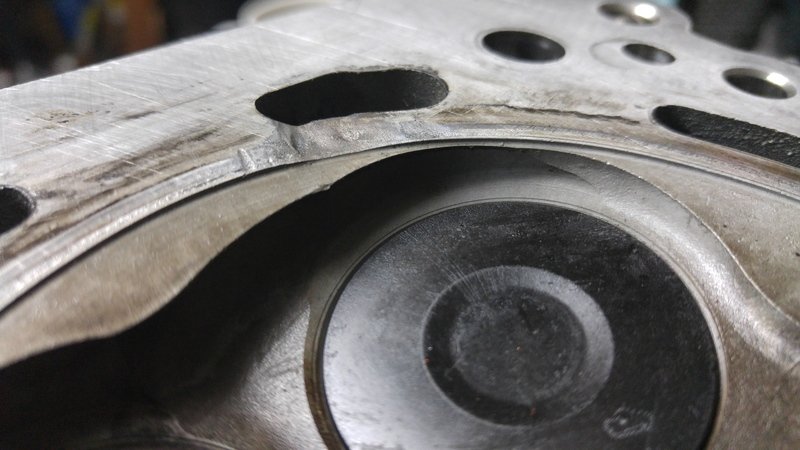

    I need to get some more pictures of the passenger side bearing caps. For now, these two pictures will give a representation of the shape it is in.
    Fortunately, I've amassed a treasure chest' s worth of spare good heads. So going to swap out the valve springs and retainers and be good to go.

    In those pictures of the passenger head, that is the #1 cylinder. That deformation is due to extensive detonation. My determination is from to much timing advancement. As seen by the damage that the pistons and wrist pins suffered.

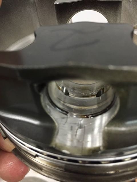

    Here are the stress fractures on the pistons.

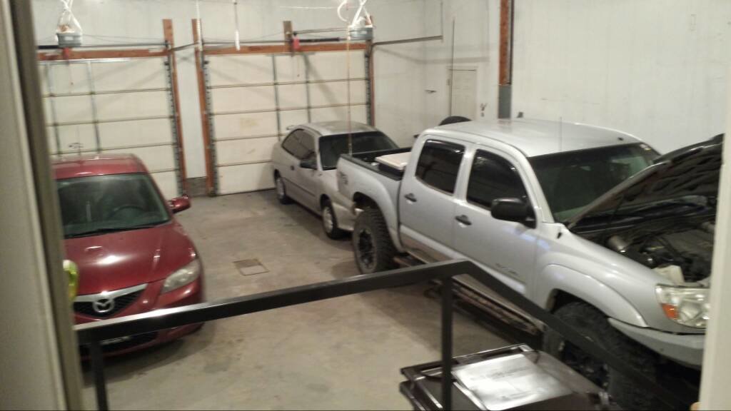

    I won't be able to make it Brady, but Face-time is the next best thing! Cheers and beers!
    At least you have all of that room. My garage is much smaller. :pout:
