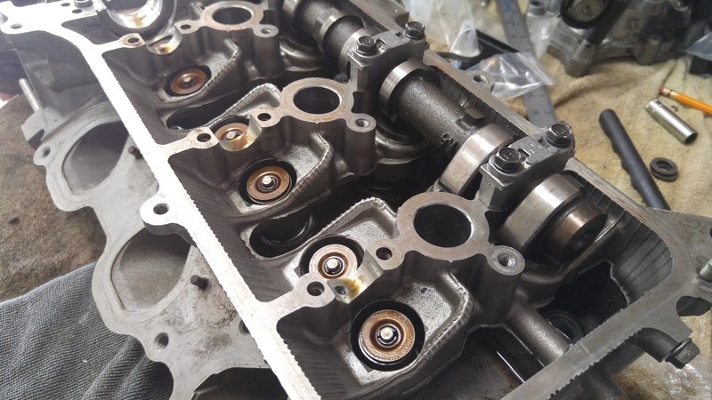

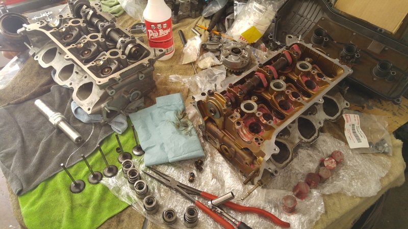

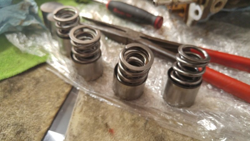

    Rob and I have put in some work, on the valve spring swap, over these past few days. New valve seals on all valves, cleaned up one valve which had some burnt oil on it. Swapped all of the springs over, and checked the clearances for the lash.
    Here are the 1GR valve lash specs. Hastily written, and compliments of Rob.
    And my cheat sheet scribbles.
    Those numbers signify a change of two even numbers, as labeled in the bucket shims. Example. One of the buckets has a #40 on the underside. Going to a #36 would then be a two # change, and net me that much of a tolerance change. #40 bucket being .2252" thick, and a #36 bucket being .2236" thick.
    OEM swapped into the ex Goldylocks head.
    Dual springs swapped into the original head which came with the truck.

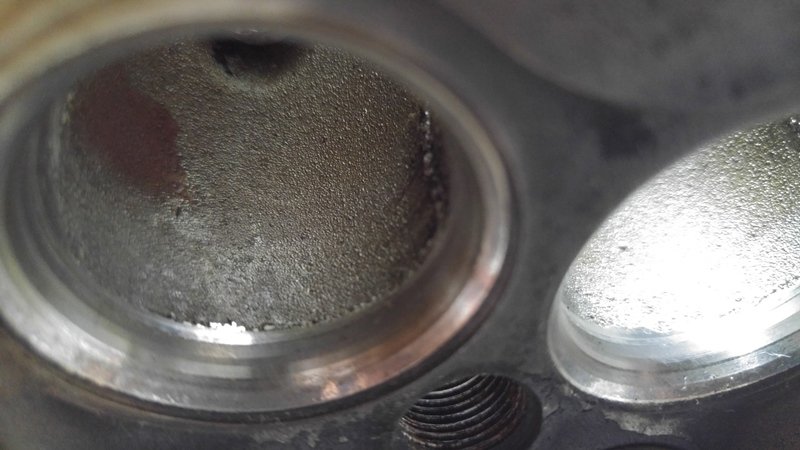

    These intake ports have a very poor porting job from the factory.

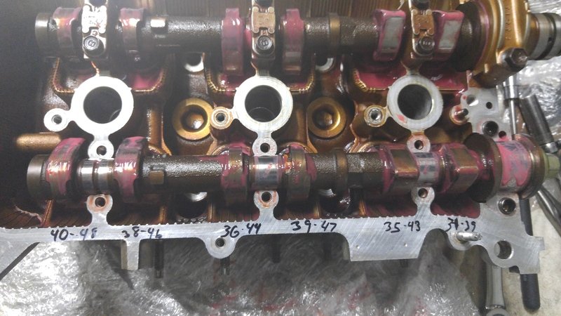

    Current bucket designation on the left. Needed on the right. Minus some possible wear, these were all installed at the loose end of the tolerance spectrum.

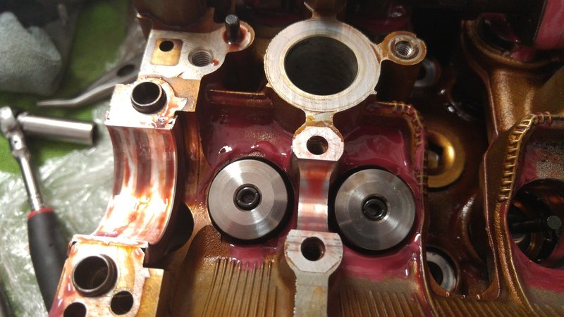

    Finished that head last night. Played musical chairs with the buckets to get most of them right where I needed the lash. Those numbers in the above picture were all at the tightest possible tolerance.
    Since my feeler gauge only has increments of .010", .012", .014", and .016", I swapped out the exhaust buckets until I was at a snug .012" Closer to minimum tolerance and maximum lift. More turbo spool!:woot:
    For the valve on furthest left, I had no bucket that high in #. So I scrounged around the other heads for one which originally came with a #36 bucket. (Lower bucket number equals thinner bucket, which equates to a taller valve.) Pulled it out, measured the differences, swapped it in & checked it. I ended up with a #37 bucket in that location, after all of that work. Instead of having to go and ordering numbers 46-48.
    One head completely finished and ready to go.
