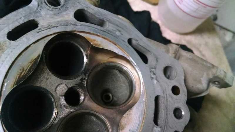

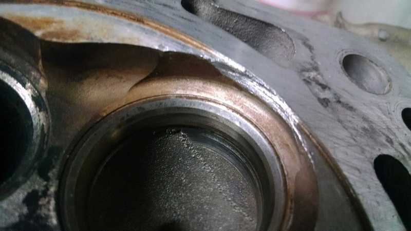

    Pulled the driver side head down from the attic last night. The head from the truck's original and hydro-locked engine. Pulled all of the valves and springs out and thoroughly inspected it. That Valve Master tool is absolutely terrific to have.
    In the pictures, you'll notice an area near one the top right intake valve. There was some slight damage done when the valve bent and hit the edge of the combustion chamber.
    I cleaned that up as best that I could, in preparation to drop off at the machinist today. I removed a couple loose fragments, and very carefully filed the area by hand.
    Going to have them go over the surface just to clean to up, at it isn't warped.
