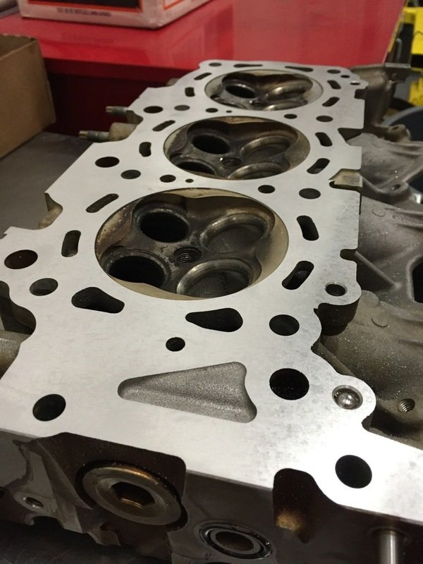

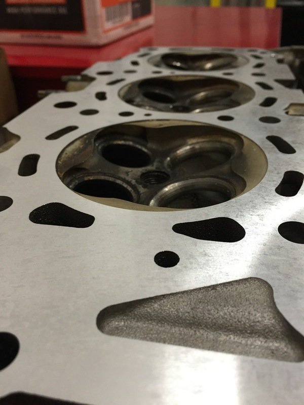

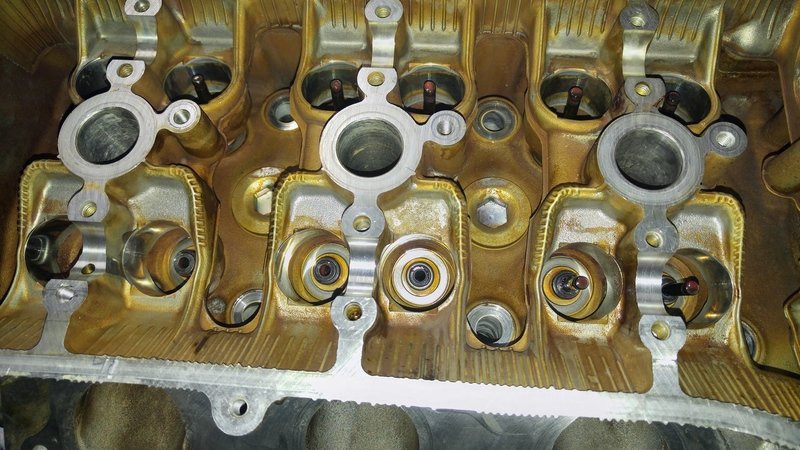

    In other news. Got a picture of the machined head, which I recently dropped off. Perfect!

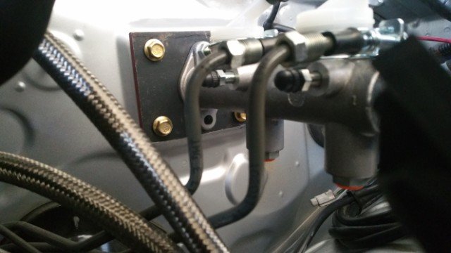

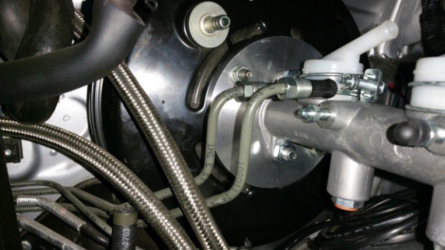

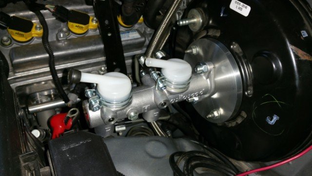

    It was running great until I tore apart my brakes, made an adapter plate to mount a willwood master to the stock brake booster, still need to plumb new lines. Have all the lines and fittings, need time to finish the job.

    O_O. Have any pictures of how it currently is?

    With booster
    Without booster, not going this route yet...

    Is this for your front and rear brakes? I cannot remember correctly, but think you have an automatic transmission?

    Yep, the plan is to bypass the ABS unit and run straight from the MC to the calipers with a splitter for the front and into a proportioning valve to a splitter for the rears.

    I am not sure how that will work without the brake booster. What I can offer, is to test drive it with the brake booster/Wilwood setup. With the vacuum hose attached and then blocked off. To give you an idea of how the brakes react to imput.
    When I was troubleshooting an issue, I removed the booster vacuum hose. Within less than a mile, the force necessary to stop was unbelievably high! Had to turn back around and re-install that hose immediately, lest I wanted to flirt with a wreck.
    Keep that in mind as you go through the process. As I am interested in the adjustable proportioning valve as well.

    That's exactly what I was going to try before deciding on whether to eliminate the booster completely. The MC I chose is supposed to be able to be used either boosted or not, depending on brake pedal ratio. There is room in the bay with the MC on the booster, so there is really no reason to remove it other than to clean it up a bit.

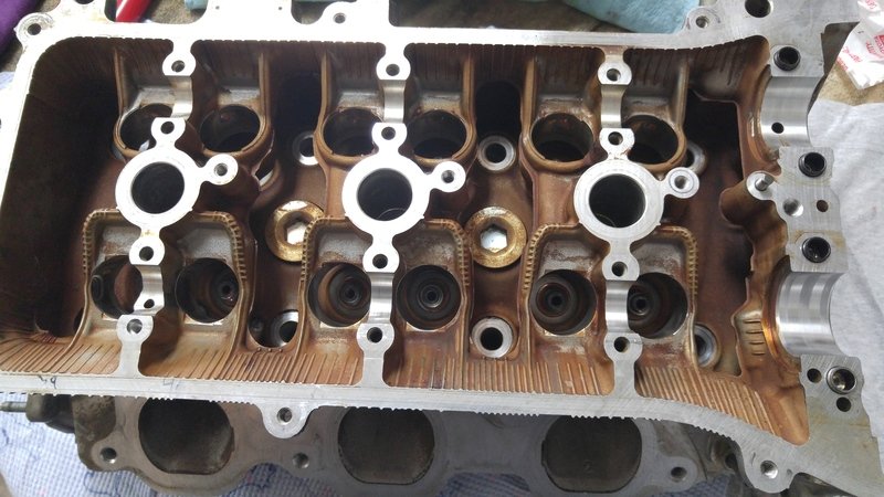

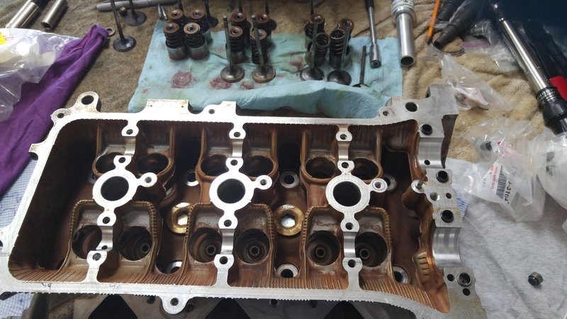

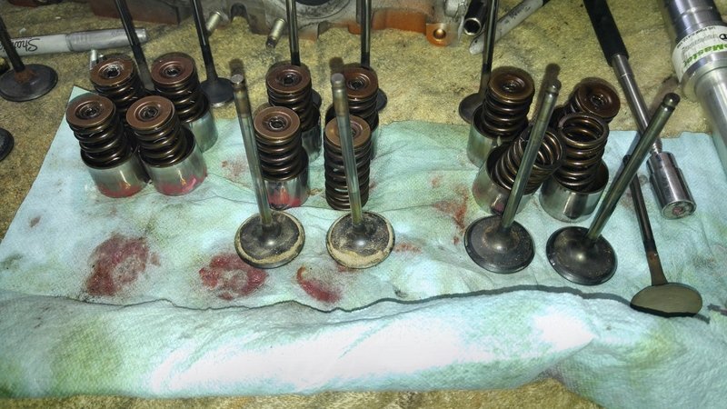

    A few more updates. Up to my ears in wrenching on vehicle projects right now. Started the process of swapping the dual valve springs and retainers, out of the driver side head that came with Goldylocks, into the head which was recently machined. It had been sitting idle for a few days since I picked it up.

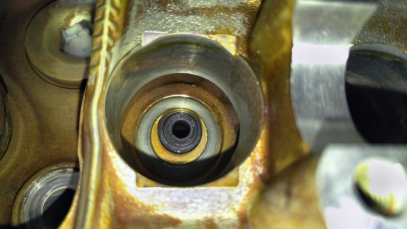

    Installed all new OEM valve seals on this one as like, like the other head. A lot of brake clean and compressed air was necessary to remove all of the left over machining shavings, from all of the oraphaces in the head.
    There is a close up up the seal installed. I added a little oil into each seal prior to installation. Some of the valves, in the upper picture, were replaced with newer OEM valves. Due to cleanliness and less mileage.

    Such as these filthy intake valves from cylinder #4, and the bent intake valves from cylinder #6.
    All of the exhaust and a couple intake valves installed, with a thin coat of oil prior to being inserted through the guide and seal.
    I have all of the exhaust valve springs installed, but no pictures as of yet. Stopped by and spoke with the machinist yesterday as well. Despite dragging on, there were a few things which we had to discuss to overcome. One being the rear main cap.
