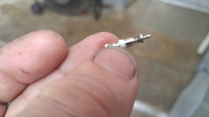

    Well I have great news to share. My engine didn't have a head gasket leak after all. Turns out that valve in the new Snap-Op compression tester, had gone bad. The spring on it had blown out, so it wouldn't hold pressure. Figured that out while working on another person's vehicle. So retested my suspect cylinder, with a new valve installed. Low and behold, 175 psi compression. Here is the bad valve, with the exposed spring.
    All cylinders testing good, there had to be a leak somewhere else. Sure enough, when pressurized, the radiator had a steady small sized stream coming out of the bottom of it. So it has a crack in it somewhere near the top. I have a video of it which I can post later.

    Only the radiator needed to be swapped back to stock, but my old one was trashed some time ago, so I ran by Advance Auto and picked up a new one. Problem solved.
    Then came trying to figure out why I had lost boost, if it wasn't the head gasket. Well while cycling the coolant, I pulled off the intake filter. What do you know, the turbo was actually sitting still while at warmed engine idle. Sitting STILL... Do a quick check on it, and sure enough the shaft has play. No yay. Well that there completely explains the loss of psi. Plain and simple. That will now be the second Precision journal bearing turbo to go out just by operation alone. At very low boost at that. Glorified Chinese turbos, and I'll leave it at that.
    Had an oil additive that I have had on the shelf for a while. Figured what the hell, let's do an experiment.....
