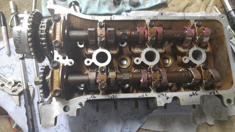

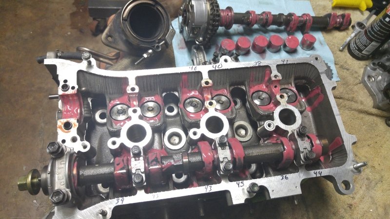

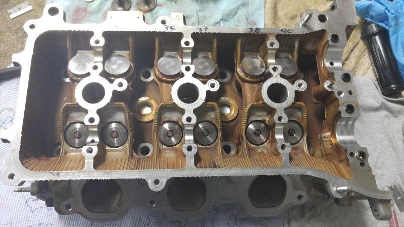

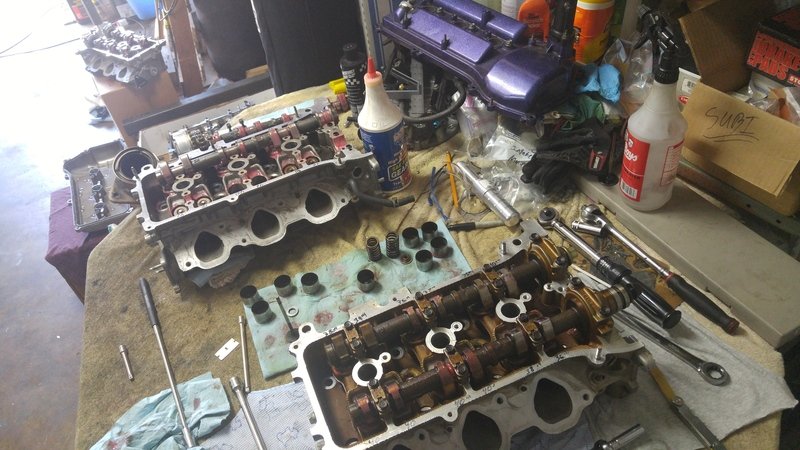

    Been a long weekend. Missed adding a few updates. Here is the rest of the build process of the driver side head. All finished up finally, as of yesterday.
    This is everything swapped over and ready fo check the valve lash. Interestingly, the valves on the exhaust side were all equally setup with the maximum allowable tolerance. Every shim bucket had to be replaced to get it to the minimum tolerance. For maximum opening.
    All finished up.
    Here is a glimpse of the heads. Sacrificing themselve. All for one.
