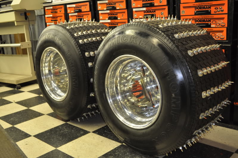

    Maybe these will keep the ass from kicking out on you! ;)
  5. Jan 25, 2016 at 9:53 AM
    #4025
    Torspd
    Torspd [OP] Tor-nication
    Sep 18, 2009
    #22958
    26,477
    Tor
    The Great America!
    MMVI 4.4L 4x4 Access Cab
    Torspd Custom Turbo kit [] Borg Warner 9180EFR Turbo [] Haltech Elite 2500 [] TiAL Q BOV [] TiAL V44 Wastegate @ 15psi [] CP Pistons [] CP Carrillo Rods [] ARP Head studs [] ARP Main Studs [] ARP Header - Head Studs [] Ported Heads w/ 1mm oversized valves intake/exhaust [] Brian Crower Forged Stroker Crank [] Darton M.I.D. Sleeved Block [] Kelford Camshafts [] Torspd 160* T-stat mod [] APR Large Fuel Rail [] Walbro 460 LPH E85 Fuel Pump [] FueLab FPR [] APR T56 Conversion Kit [] KP RACING Built T56 [] McLeod Racing Custom Twin Disk Clutch [] One Piece Aluminum Driveshaft [] MGW Shifter [] Custom lowering kit [] Ohlins Front Coilovers [] QA1rear shocks [] Custom Ron Davis Radiator [] Dual SPAL Electric Fans []
    Holy fawk! For my arctic land speed record, I'll grab a few of those!

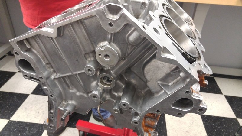

    Still don't have the engine back, but I can truly state that it is being worked on and fast. Ends up being a good thing that I didn't pick up the engine on Monday. It was my plan, and I went there with every intent to retrieve it. A proposition was made to correct their extended time frame, which was fair.
    Where it comes out in favor of me not picking it up, is that an issue with the pistons was found. Yesterday, as they were assembling the pistons, after gapping all of the rings, they found that some of the piston rings were not fitting as correctly as they should. They were effectively too thin.
    The main bearings were in, all ARP studs ready and the 4 for the rear main cap were machined. Including the rear main, to allow the ARP nut & washer combo to fit underneath the oil pan. Block was thoroughyl cleaned, which meant removing the freeze plugs. Crank was installed, and that is where they stopped.
    Here you see the front of the block, where the custom freeze plug was removed. As well as on the opposite end.

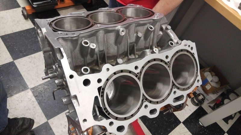

    Here is the fresh, smooth, clean, sparkling deck.
    No worries of uneven surfaces causing blown head gaskets this time around. :thumbsup:
