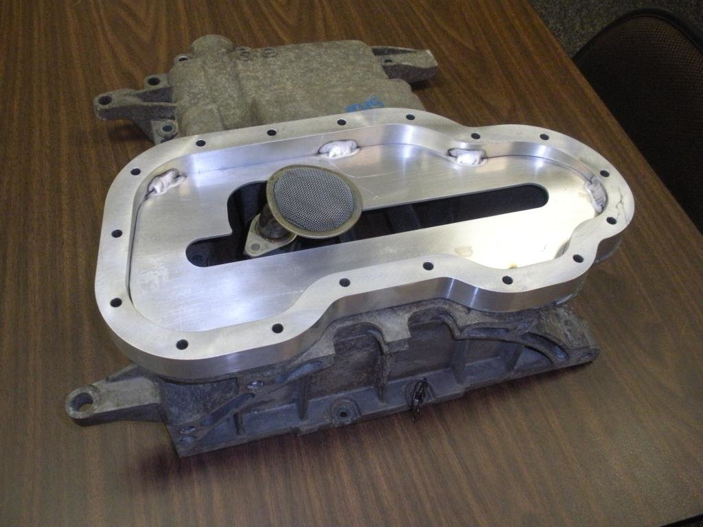

    Here is what the lower oil pan spacer looks like. This one was modded by Grumpy years ago.
    Damn near a necessity for those with the shallow oil pan.

    What's the volume of oil you run?

    Currently with the 4x4 pan and the oil cooler, I use 7. That pan with that spacer makes the capacity go to ~7. With the oil cooler it will be approximately 8. To top dot. :cool:

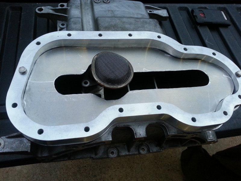

    This is what my new version of this looks like.

    @Torspd more info on spacer? And how will it benefit the rest of us? Should I look into it?

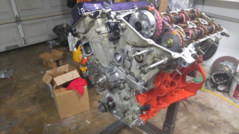

    I've always wondered, when torquing the heads, what's the sequence used for re-torqueing them so its not needed to put it through any heat cycles?

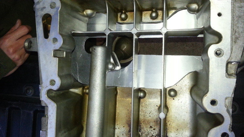

    It is only available for the shallow oil pan. Which primarily comes on the XR, but has also been found on some PreRunner models. Compare your pan to this one in the picture. If they are the same design, I cannot stress how important it is.

    These studs have been heat cycled before, as well as torqued. At these torque levels there won't be any more constructional stretching. Just elastic. Combined with that of the compression of the head gaskets.
    I employ the method of torqing, then waiting a day and re-torqing. The second day is just at the same final torque spec as the first day.
    To heat cycle the new studs, I get them to engine temp, in hot water. Carefully sealed in a bag. Heat and cool.

    Heads re-torqued, cams installed and torqued, and timing set.
