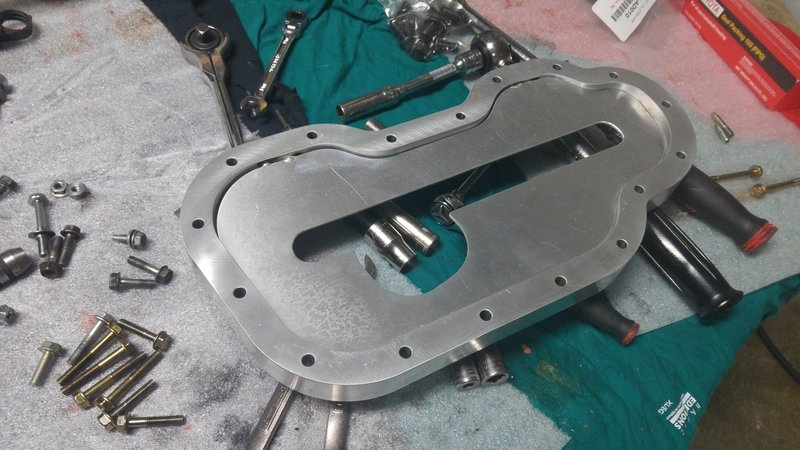

    @HomerTaco should remember this grilling... (in the background)
    This beautiful piece of static machinery! Thank you @Coupe. It has taken many years to come full circle from the time of the idea, to actually installing one. Fitting none the less. :thumbsup:

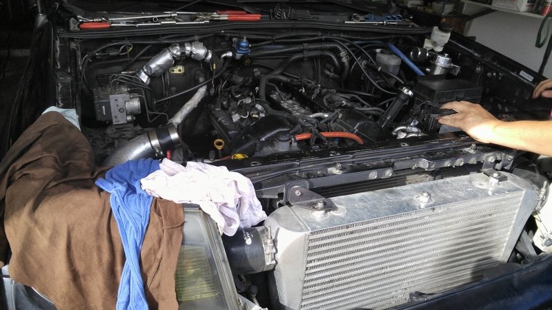

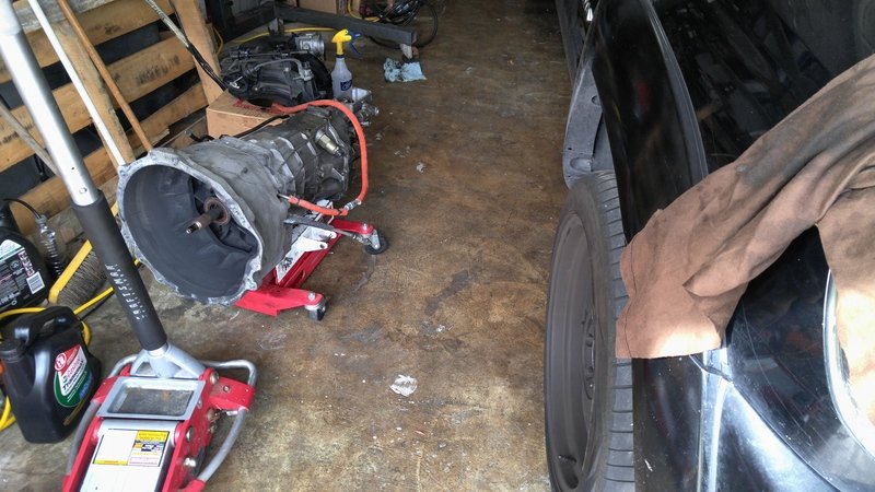

    A few of this weekend's accomplishments. Had to work Saturday and couldn't get started until after 4 p.m.

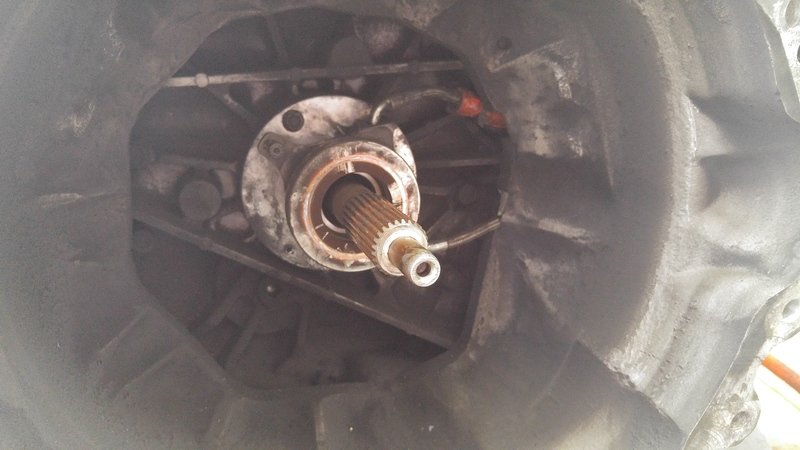

    Goldylocks is in the engine bay as of last night. Ran into issues with a pair of bad pilot bearings. Just returned from the store with some quality new bearings. What a F'ing hassle that was. Could have had the trans bolted up, if not for the delay. Just about to get wrenching to get this project rolling!

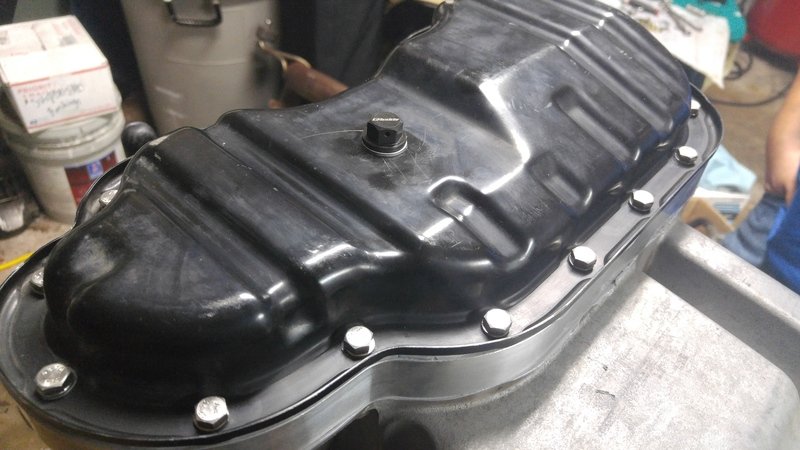

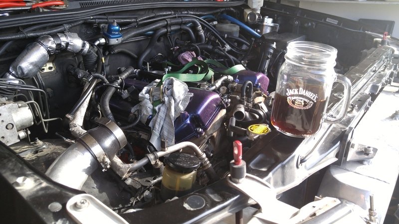

    Cup of coffee to get started this morning. Swapped out these valve covers with the other ones. That way I can get these painted or powder coated differently.
    Pretty much all buttoned back up. I have to have the accessories on, as well as that charge pipe, before I proceed with stabbing the transmission. Otherwise I will be fighting the angle of the engine as it leans backwards towards the cab.
    Since my TOB is not a continuously riding tob, I had to re adjust the gap between it and the clutch's springs. A lot of double checking.
    Right now, I just finished with the transmission fill, and clutch bleeding. About to install the headers and y-pipe for the start-up.
