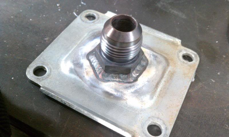

    hey can you post a pic of where your oil and coolant lines go to from your turbo? and any tips for someone who is about to put one on?? the one i got is a smaller guy, im not goin to crazy... yet lol:burnrubber:

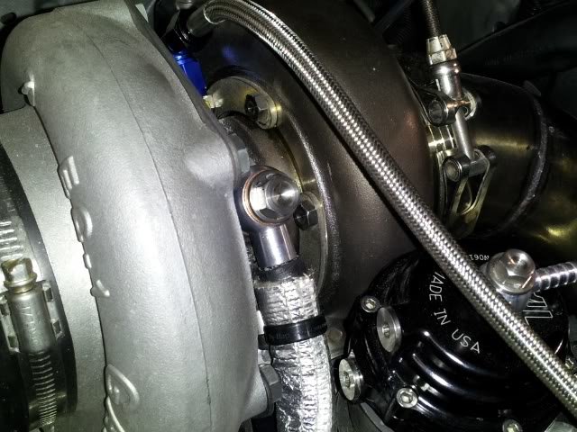

    Since my turbo is journal bearing, I didn't have to run any water lines.
    As for the oil line, here is the where the return line goes back into the block.
    That is the inspection cover on the timing cover. On the passenger side. It is a -10AN return line.
    Let me look for the feed line location.

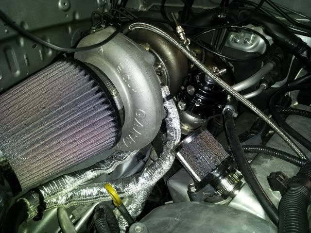

    thank yah man, where do you think i should run my coolant lines from and to? sorry kinda new turbos

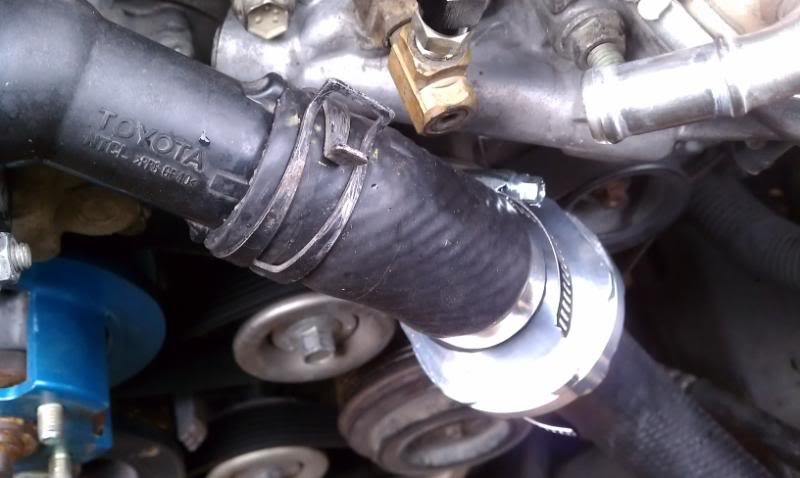

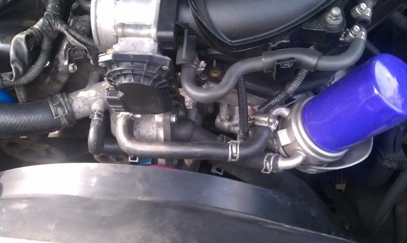

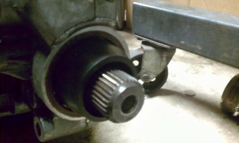

    Sorry about the delay. These aren't the most helpful pictures, as far as where the lines are coming from, but at least they are something cool to look at.
    This is off of Toon's truck. 2012-01-20151341_94531f7f20d77f3f3dad39c860267e628f932e72.jpg
    Since his truck has the OEM Oil cooler, the lines that were used to feed that, were then used to cool the turbo as well. Basically just added it in series with the cooler.
    This picture will let you see the lines that go to the OEM oil cooler, that I was referring to, if you don't have it.
    Where the top hose comes out of that head unit, to the port on the Oil cooler closest to the engine, and then the return on the bottom, there is a marking for where they need to be drilled out, if the truck came without an OEM oil cooler. It is a circle, in each location of where they would be.
    In this picture, you can see where the oil feed source is for the turbo.
    Don't mind that piece in the radiator hose. It was from a failed experiment.
    Here is another older pic for additional reference.
    Right next to the oil filter, underneath the Oil sensor.
    Hope that helps you out AK Toy. :thumbsup:

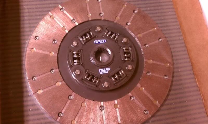

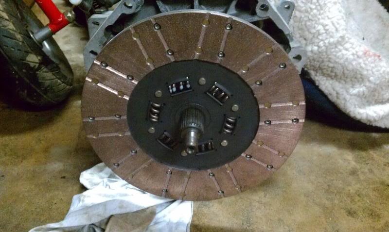

    Thank you for the compliments on being a bit of an inspiration. Those factory clutches from '08-10 or '11 were just weak and junk. They changed from the LUK brand to the Aisin brand and kept having a problem where he hub would shear from the disk. Not good. So at least now you have one necessary mod done.

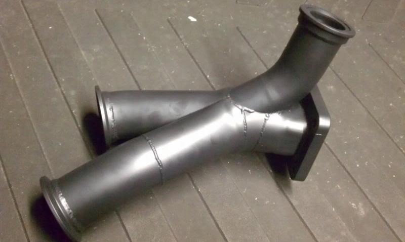

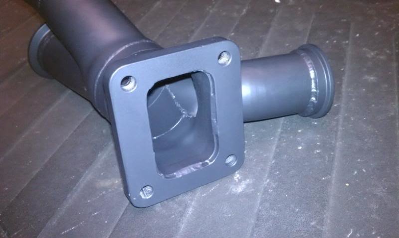

    In the mean time, since the turbo was off of the truck, I had the perfect opportunity to finish up on some punch list stuff that I had wanted to do earlier.
    Such as ceramic coating the exhaust components.
    Went with the black ceramic coating offered by Polydyn,www.polydyn.com, here in Houston. The tout it as their strongest and most durable coating.
    To complement that part and aid in extra cooling, some of this was ordered to help things out.

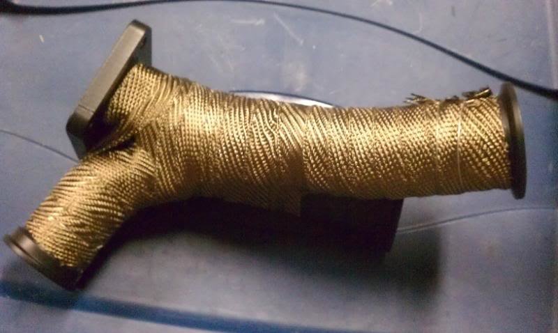

    All wrapped up, this is how it tuned out.
    I took special care to make sure that there was a half overlap in the wraps. Makes it go through very quickly though.......
    That was November 8, 2011.

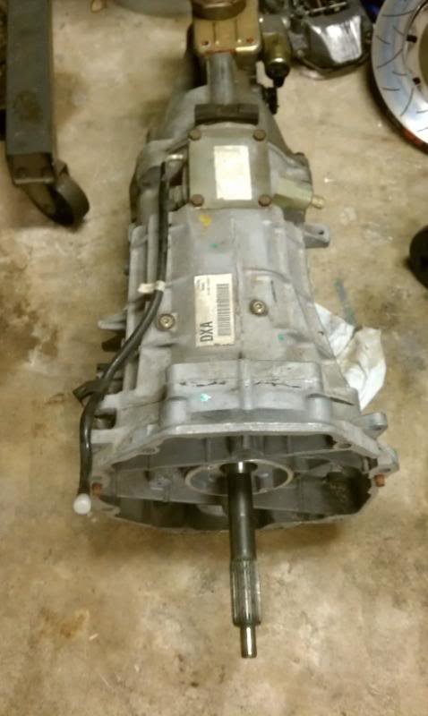

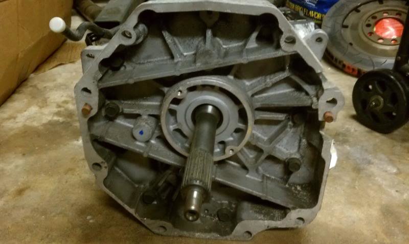

    After that, then next big thing to happen was that I found a T56 transmission finally. One that was built, and also for an Awesome price! It was a Rockland Standard Gear, www.rsgear.com, Tranzilla built T56. I had approximately 500 miles on it and was in storage for about 5 years, since there was some fallout on a build. So I became the lucky purchaser. Woot! Got it for a steal of a deal at $1800 compared to the normal $3400 +$500 core. That was in the first week of December '11.

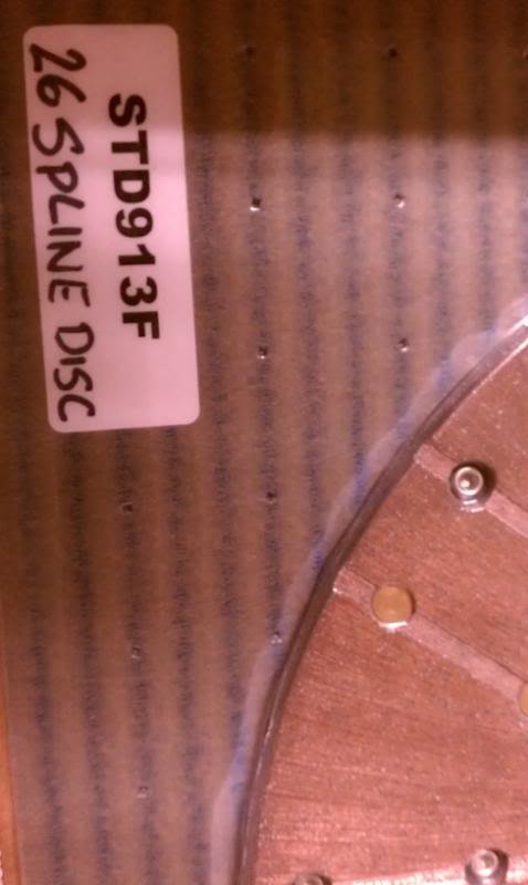

    My Spec Stage 3+ Clutch disk to match.
    Interestingly, the clutch disk for the '98-02 V8 Camaro, is the same as for the '05+ Tacoma. Minus the hubs having different splines.
    Slashaar likes this.
