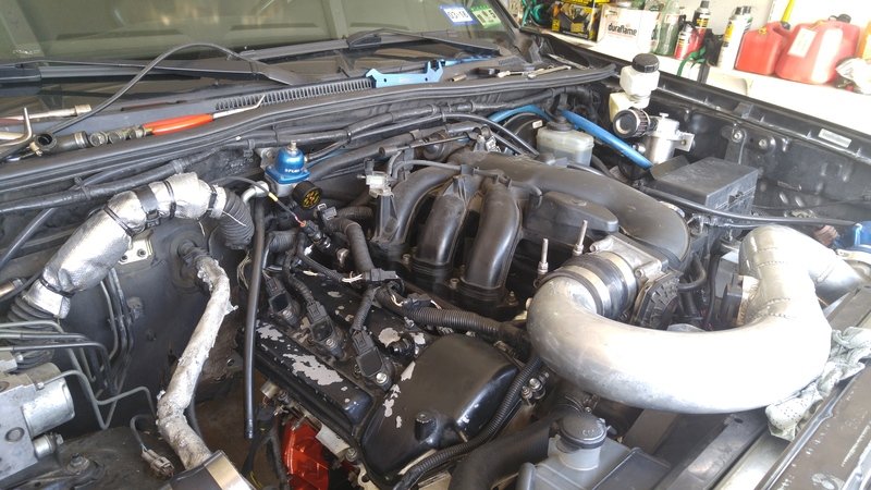

    So its been confusing keeping up with all your motors. Its like "who's on first." What has been done to this motor? Is this the one you got all the friction reduction treatments for?
    Can you give me (and everyone else that's slow like me) and run down on all the motors you have and what condition they are in and what your plans are for them. And if you haven't developed carpel tunnel by then, what your ultimate plan for the truck is, IE, what is the motor you really want to take around the track and what are you power goals?

    Alrighty. This engine is Goldylocks. It is THE FIRST sleeved 1GR from Darton Sleeves. It has Darton ductile iron M.I.D. sleeves, Pauter Rods, Wiseco pistons which are coated on the skirts, ARP head studs, and Cometic Head gaskets. The only thing done to the heads was upgraded valve springs and retainers.
    This engine was originally started by Gadget, then purchased by Doublld. At minimum, it should hold 600 whp. This one was purchased by me for strong nostalgic reasons. Since my scored cylinder walled block was used as the sacrificial block to make sleeves for the 1GR.
    The engine on the stand is my Frankenblock. Cobbled together with parts from 3 engines. It is my stock swapper. Lol.
    The stroker engine should be capable of safely handling 800 whp. That is my power monger build. Which is getting WPC treatment on the rotating assembly. It also has Kelford cams. That one is built for power.
    What do I want to do with all of these goodies? Have some fucking fun and race the slut of them.

    9.0:1. I have a feeling that it is a little lower than that. Due to the new thickness of the newer head gaskets. Over come by increased bore.
