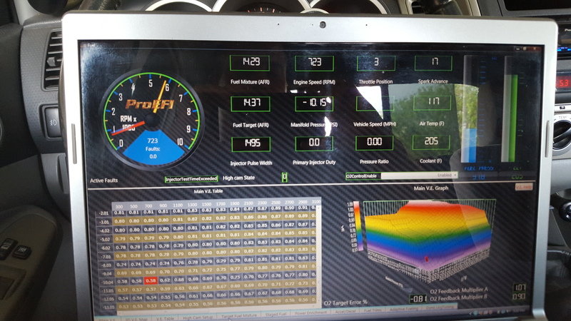

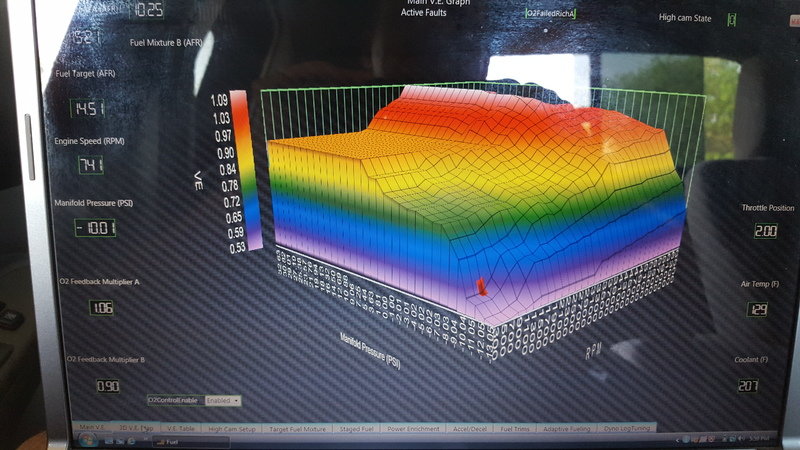

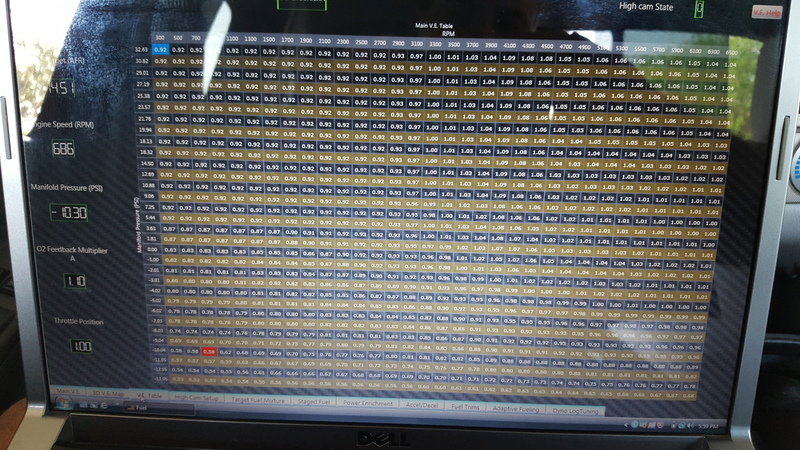

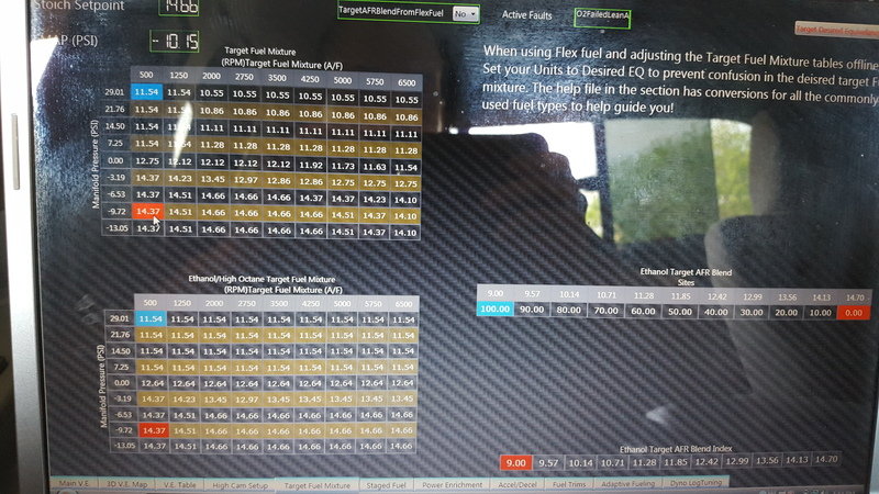

    Took some pictures of my settings prior to any adjustments, as an additional safety precaution. Here is a sample of what some of the fields look like.
    Target AFR fields. Used in conjunction with the V.E. map.
    V.E. table only.
    And 3D V.E. map.
    Spent about an hour adjusting the idle tune. Inlcuding timing and AFR. While at it I also addressed some some of the cruising cells. Where it used to be around 12.5 AFR at 65 MPH, it is now in the mid 14's.
    Going to try to get some road tuning done this weekend, and see about ironing out some other improperly rich spots.
    First test drive was my drive in this morning. The changes made significantly noticeable response improvements, and cruising was much smoother. Felt a lot more in-line with how the engine runs with the stock ecu.
