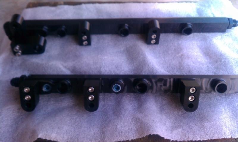

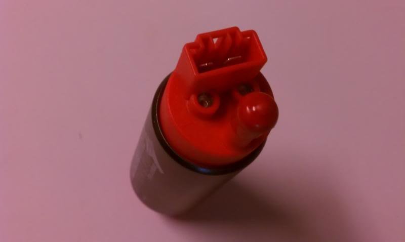

    I am running the Aeromotive Stealth.
    Have a larger fuel rail in waiting for future fuel requirements...
    That fuel rail is -8AN in and out. WOOT. So it has tons of extra capacity over the OEM one, for the soon to be added fuel requirements.
    Once my Fuel Lab FPR gets in and I can install it, then I will be able to take some measurements of the length of fuel line I need.
    I am planning on doing what you are talking about though, as well. It will just be a few more months down the line. I still have to order the flex fuel sensor as well for my Pro128. I would rather have that then have different tunes. Feel safer with it, versus having separate tunes. Plus it is a very nice conveniece factor. Lol. And still need to grab a new set of ID's. 2000's this time around. Won't have to worry about getting close to the max IDC, even with E85, on those injectors. Ha.

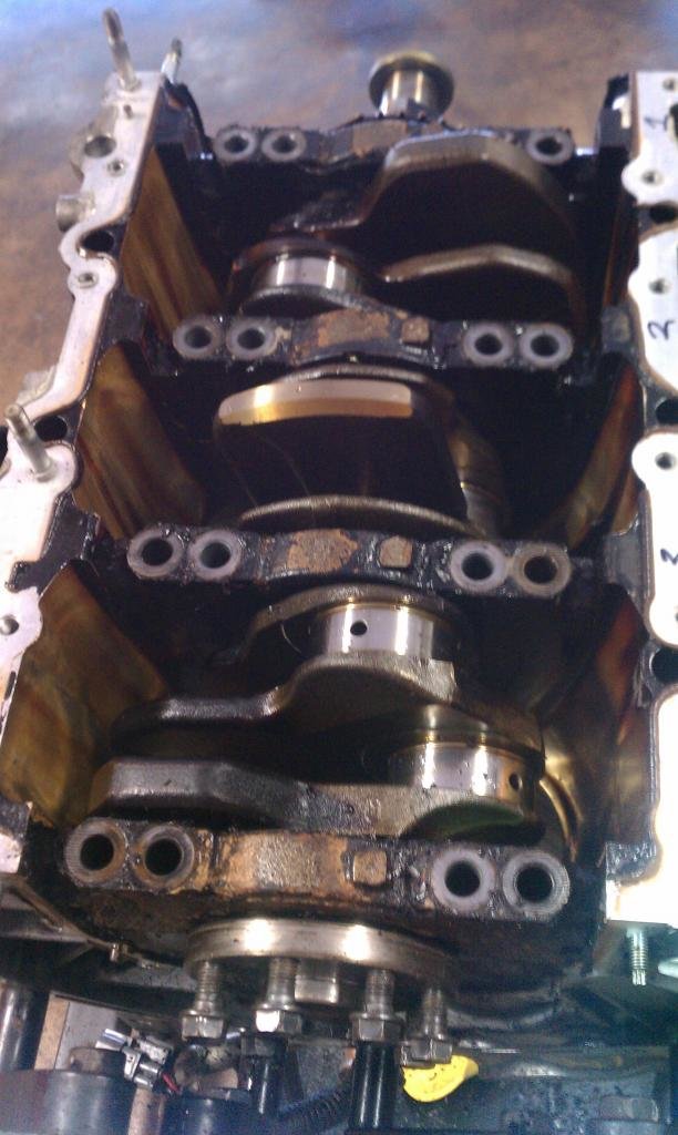

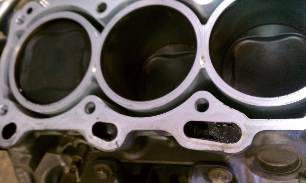

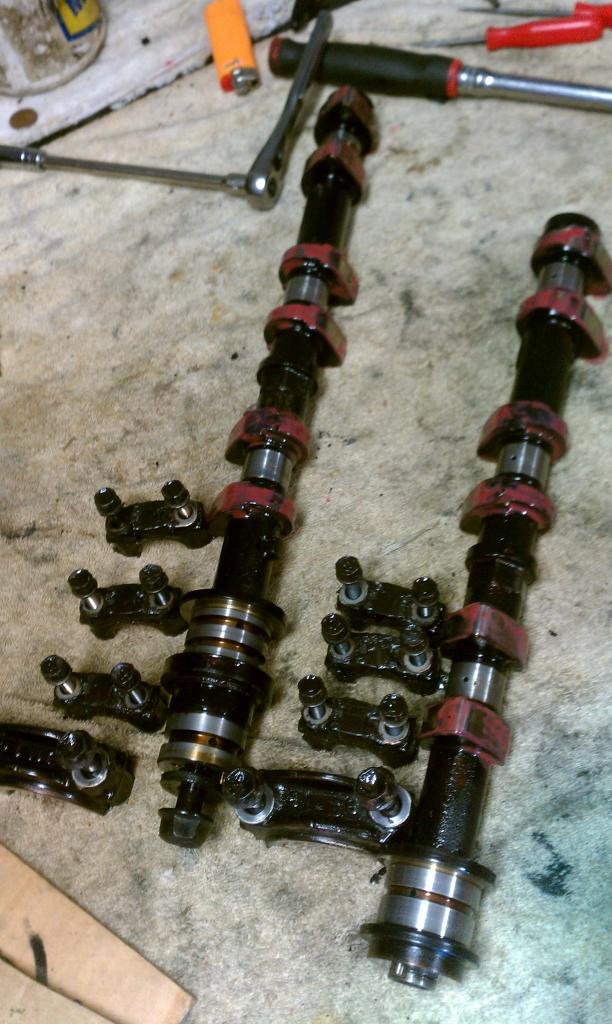

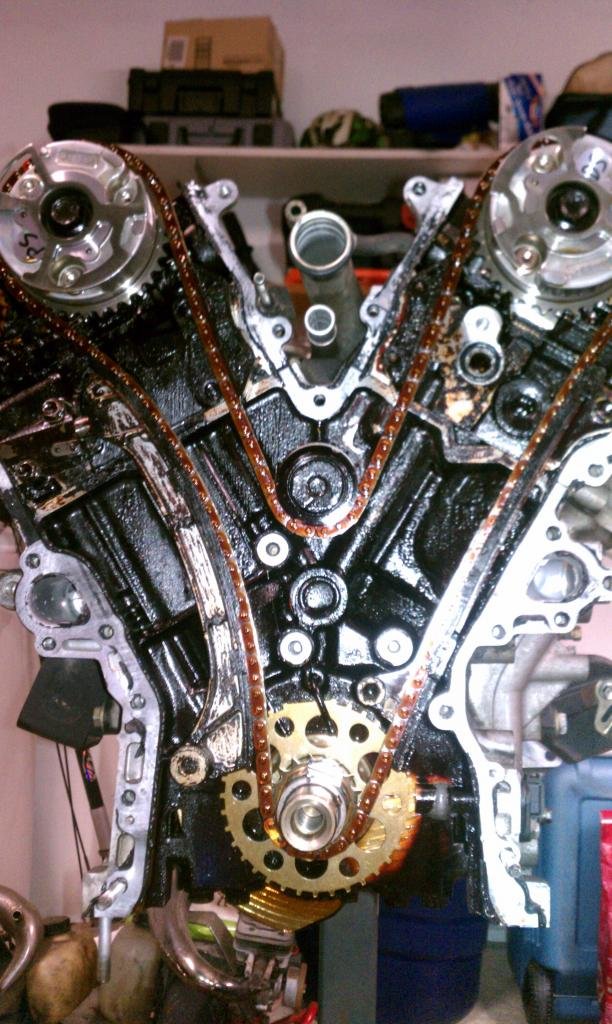

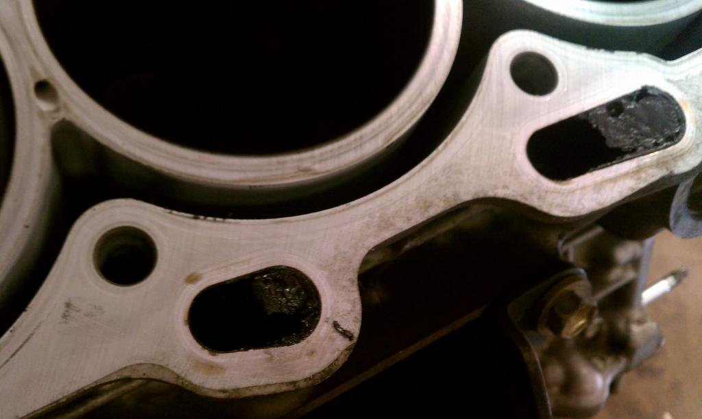

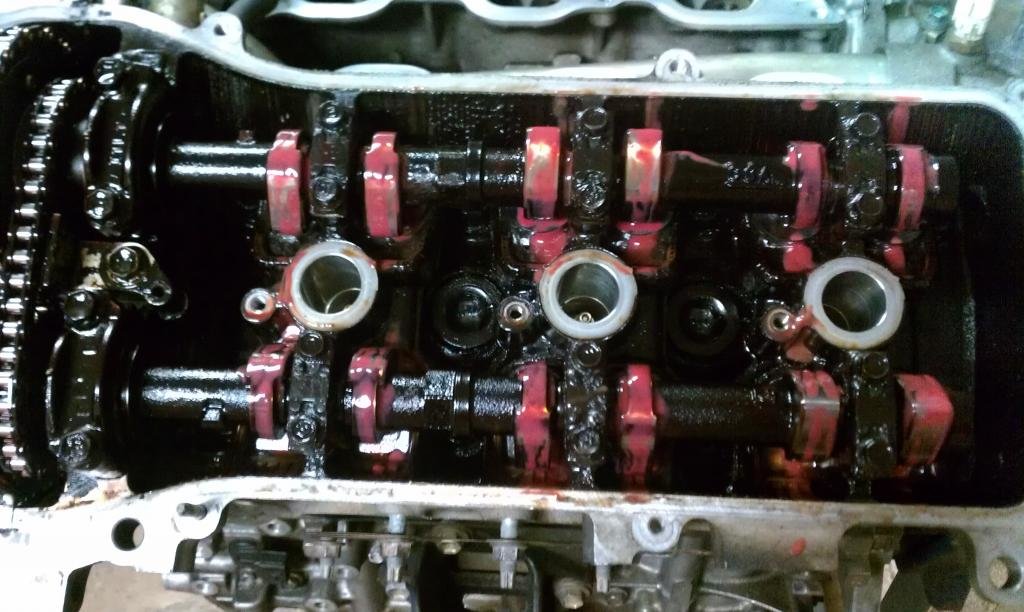

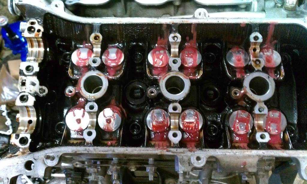

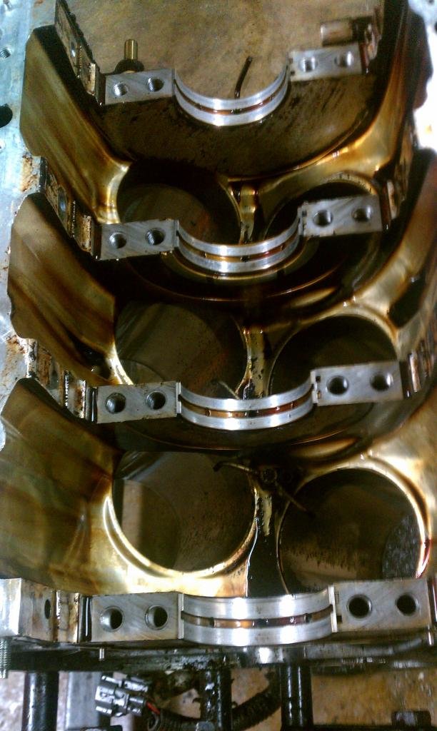

    Going to skip ahead to last week. 10-13-12

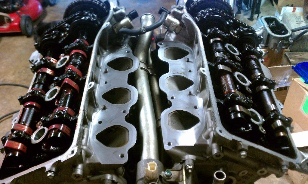

    Here is the latest from Darton East. My built engine with torque plates on it, and sleeves installed. Waiting to be bored & honed. :D

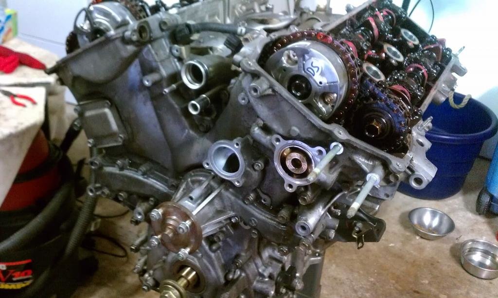

    Also, here is the current state of my used engine.....
    All torn apart. Sent out the crank to be turned on a journal that had rod knock. Figure I should clean things up a bit before it comes back.

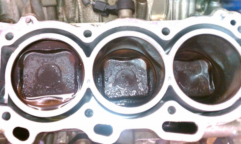

    Timing cover off, in all of its burnt nastiness...
    Some sludge I found. Huge thanks to the prior owner..... :/

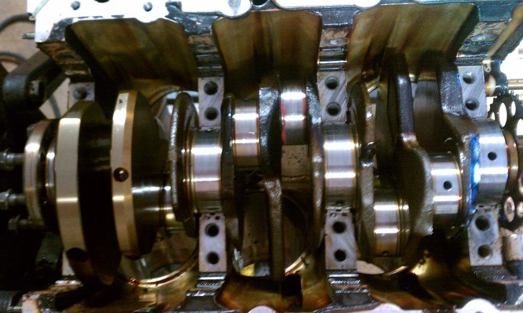

    Main bolts removed, but main caps still on. Second pic is with them off.
    Crank removed

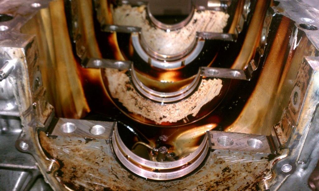

    And where some of the burn oil was scraped away...

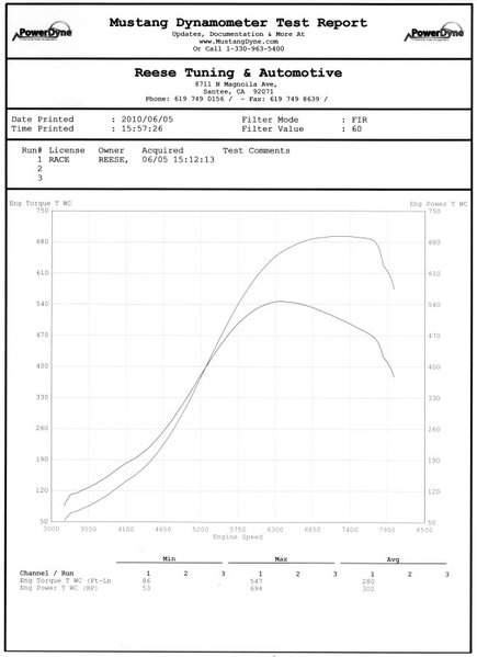

    well that is sick that some people run e85, have you guys thought to run a stand alone. at first i ran my stock ecu, but i had to take my labtop with me because i had 5 tunes on my computer so i would just changed tunes when i needed too. then i went to the aem ems stand alone. it made my life great when i was running speed density. lol but the id 2000 hands down are the best injectors ever. i ran thous in my evo.
    well no it wasnt at 700. it was at 694 on the mustang dyno. aka the heart breaker dyno. if i put it on a dyno jet it would for sure be high 700. she was a lot of fun. i miss it. but i am going hopefully going to build another next year. i put the graph for you to see.

    Yes sir. My self and Toon are the first two people to run the ProEFI (www.proefi.com) standalones on the Tacomas.
    The other guy I mentioned, Xroller, is running a plug n play AEM standalone from Dezod. http://www.dezod.com/pd_dezod_motorsports_aem_ems_standalone.cfm
    Your car reminds me of Gate311 Evo X.
    And yeah, 694 on a Mustang is good enough for 700 whp. ;)
    I actually took a few ques from Ryan Gates when I got to talk with him at The Texas Mile, last March.
    I tell you what though, that is a hell of a curve right there. Makes me wonder how many passengers you had, that pinched a hole in the seat when there butt puckered from the power? Lol

    yea if you guys are running the ProEFI or the aem. you guys should be good, you guys can get your tune more spot on. but when you were at the texas mile. was ryan gates in his blue and white evo x or was it all blue?
    that curve is turbo lag. lol but when it hit it was nasty.. the best was taking girls on a ride and see there faces. lol

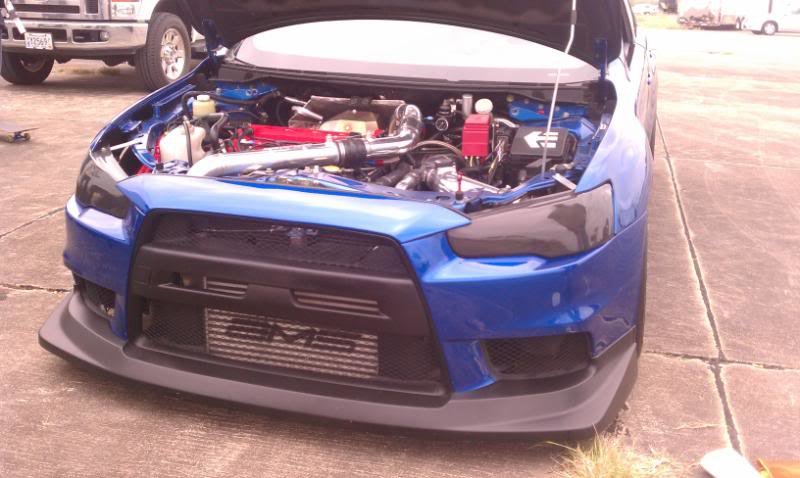

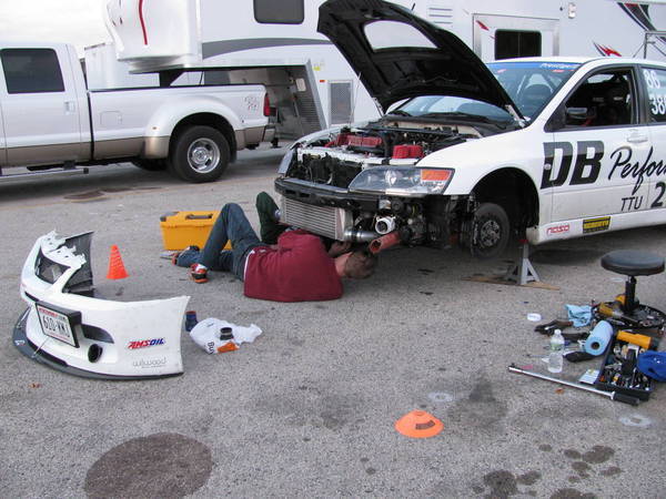

    Since evo's were mentioned above, I'll play :) Picture of me working on the track car between sessions. Intercooler pipe connection failure...
    ~M

    It was his all blue one. Sick ass car. Let me get in the driver's seat too, which was really freaking cool. He is a good man. Informative, friendly, and non boastful. I have some specs on his blue car as well, but would have to look them back up. I do know that he was running a custom Precision Turbo. Said it responded like a GT35, but had the power of s GT40. And it revved to a ridiculously high rpm. I have a feeling that he or some other AMS people will be there this weekend as well. So i will try to snag some more pics. :D
    Why do I get the feeling that that isn't the occasional Track Dayz car? ;)

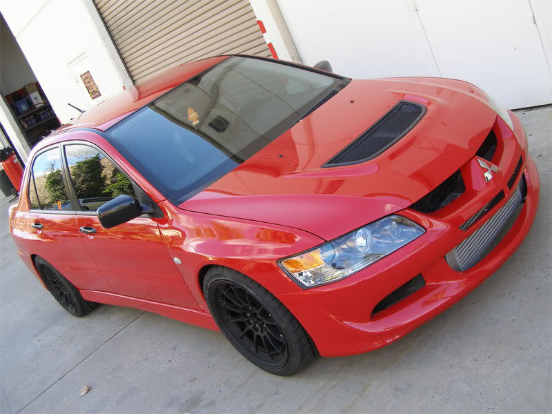

    i have an 2005 evo 8 rs. with the turbo is in the front, but the red evo in my sign is a 2005 rs aswell. but with a front facing turbo. but on the evo x the turbo is right by the firewall.
