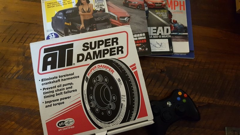

    Other note. Looky what arrived today.
    Just in time for dyno day.

    Wish they made one for the 5VZ :pout:. That cast crank has me worried and a $90 Denso part is probably inferior to the OEM.

    What is this Denso part you speak of?
    Denso is an OEM supplier.
    How many stories have you seen of people snapping cranks before rods?

    Your crank will be fine. Just don't push the rev limiter and your rods will thank you. Dorman part doesn't look bad, but that is only me going off of a picture.
    If your pulley is coming apart, best to replace it.

    What will the damper do for a truck with header back exhaust and intake. Or will it not do anything at all??:confused:

    It dampens torsional vibrations. It works regardless. The "improvements" might be noticed more so on a highly modified engine.

    So would you recommend this to me as something to get or just kinda more so your self as you have some crazy engine things going on:drool:

    @Torspd dumb this down for us simple folks.... lol
    Will the dampened pulley do any good? I have the light weight machined pulleys on mine.

    OEM pulley provides dampening to keep the harmonic vibrations from weakening your crank which can ultimately cause it to fail. The light weight pulleys generally don't provide and dampening effect and you sacrifice engine longevity for a smidgen of performance.
    ATI and other performance dampeners are generally a "best of both worlds" in that they are generally lighter than OEM but also provide a better dampening effect. I'm not sure how companies such as ATI accomplish it but I think they use some kind of internal fluid that balances the pulley much like beads can balance a tire when rotating fast enough (not exactly sure)? I think OEM balancers just use a very heavy pulley to absorb the vibrations. Tor might be able to help out more in this department though.
    I know I don't need a "performance" balancer, but man do I want one. I'm sure the Dorman is ok, I just hope its been balanced IAW OEM specs, that's all.

    Makes me think I might want to switch out the one I have....

    Google is my friend:
    http://www.onallcylinders.com/2014/01/16/harmonics-101-understanding-harmonic-dampers/
    http://www.fluidampr.com/what/how-does-a-fluidampr-damper-work-55/
    TBH, I didn't get the alu one they sell for the 5VZ for this reason but Ive seen people run them for a long time with no issues :notsure:. Would I change it out? Yeah, but I wouldn't lose sleep over it. The ATI one is $350 which isn't bad but not cheap either.

    So basically why your saying is that we should all get one? :p But that was an interesting read. I like it!

    ATI's for everybodies!

    How much are these things!? I'm kind of interested in it
