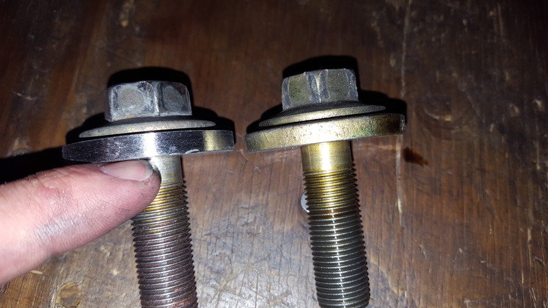

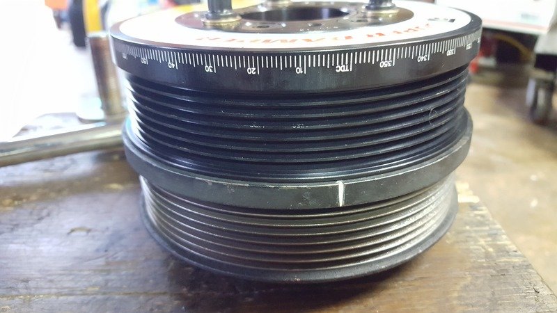

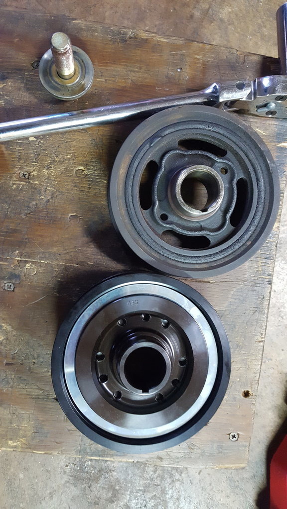

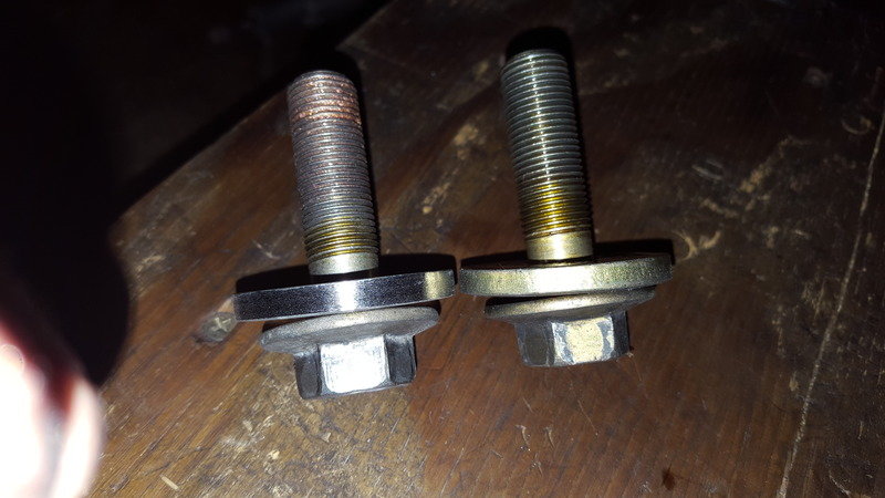

    This is how the evening started, around 1840.

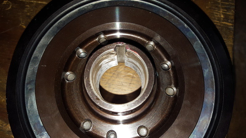

    Then it became a chore.... The cycle continued, of "I mod my mods."
    I had to hone out the I.D. to fit the crank shaft. The tolerance was to tight.
    Similar to how the original batch of NST lightweight pulleys were, after anodizing.

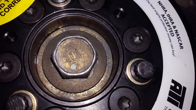

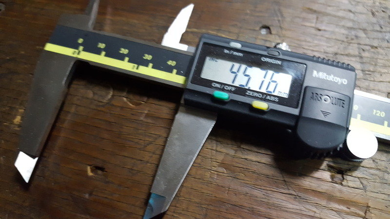

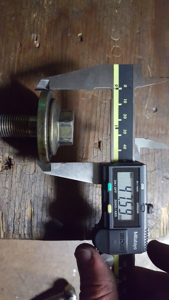

    Then I had to grind the O.D. of the washer to fit inside the crank pulley.
    Stock diameter of the washer.
    The I.D. of the pulley that the washer must fit in.
    And the finished product. I trimmed it down to 45.5x mm, and it slid right in.
    I will be sharing the information with ATI today. As well, I believe that a steel sleeve will need to be installed over the portion of the pulley which contacts the front main seal. Again similar to what was later installed on the NST pulleys.
    Overall, after those modifications, this pulley has already proven its worth from how smooth the engine runs now. From start-up to driving through the RPM range. If they implement the changes to the pulley, I will highly recommend it.

    So just got off of the phone with ATI. The pulley is supposed to be an interference fit. Luckily I made it to where it was a tight fit only and not as loose as the OEM. When all else fails, read the instructions. ;) Only way I can recommend installing it, that being the case, is freezing the crank shaft snout. Dry ice or spray.
    They did take note of the washer, as they had not known about that.
  10. Mar 30, 2016 at 9:29 AM
