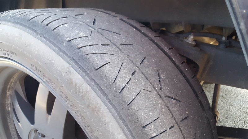

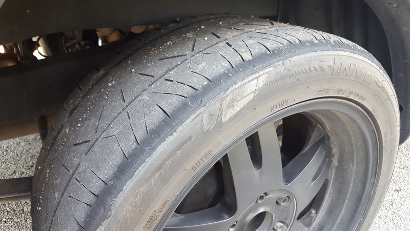

    Couldn't have had a better way to roast off these tires. It was a heck of a lot of fun!

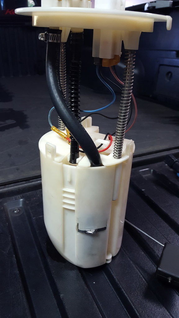

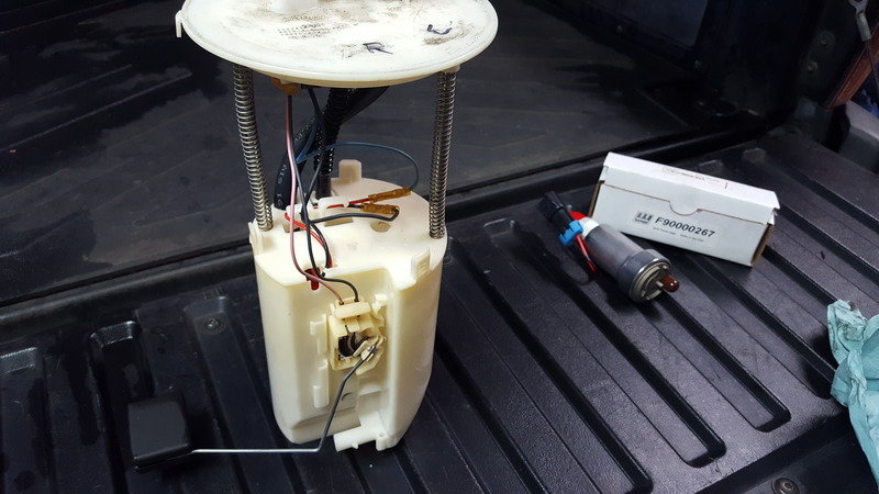

    Torspd Custom Turbo kit [] Borg Warner 9180EFR Turbo [] Haltech Elite 2500 [] TiAL Q BOV [] TiAL V44 Wastegate @ 15psi [] CP Pistons [] CP Carrillo Rods [] ARP Head studs [] ARP Main Studs [] ARP Header - Head Studs [] Ported Heads w/ 1mm oversized valves intake/exhaust [] Brian Crower Forged Stroker Crank [] Darton M.I.D. Sleeved Block [] Kelford Camshafts [] Torspd 160* T-stat mod [] APR Large Fuel Rail [] Walbro 460 LPH E85 Fuel Pump [] FueLab FPR [] APR T56 Conversion Kit [] KP RACING Built T56 [] McLeod Racing Custom Twin Disk Clutch [] One Piece Aluminum Driveshaft [] MGW Shifter [] Custom lowering kit [] Ohlins Front Coilovers [] QA1rear shocks [] Custom Ron Davis Radiator [] Dual SPAL Electric Fans []

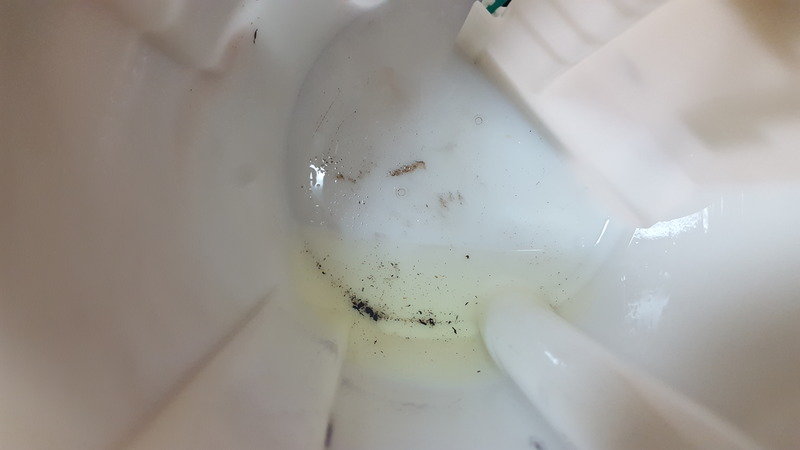

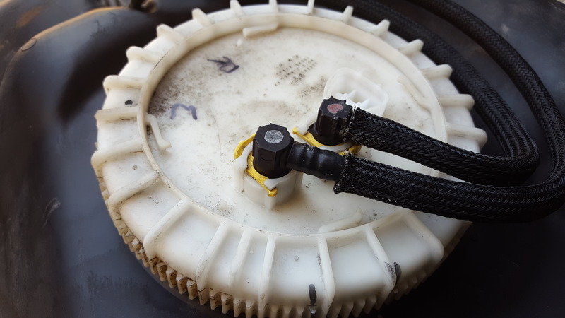

    Tackled the Walbro fuel pump install yesterday. Took quite a while, as I noticed some rust from where the gas tank met the frame cross members. Added some padding to the top of the tank in the contact areas, as well a POR 15'd a lot of the frame in the surrounding area.
    Marked and ready for the big flat head.
    Fuel pump assemble with Aeromotive 340 stealth inside.

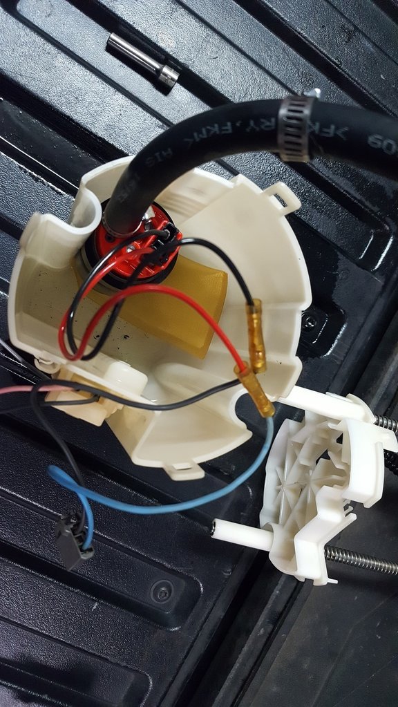

    This Walbro comes with a a male plug attached and a female pigtail. So I decided to upgrade the intank wires. The OEM wires were showing some signs of heat too.

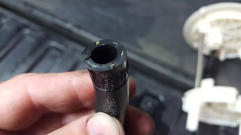

    Found some little splits in the line.
    And some flavor crystals.
