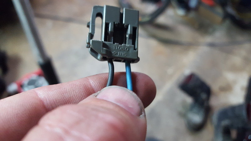

    OEM connector which you normally splice into.

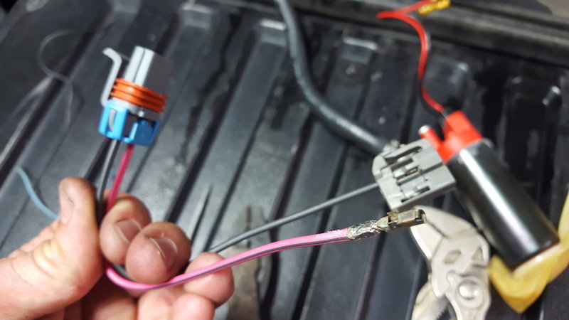

    Female pigtail spliced in. And yes, it seems backwards for me to call this the female end. It goes by the female pins on the inside.

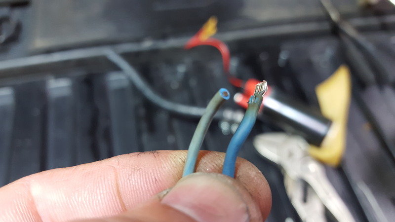

    OEM wire with heat evidence.

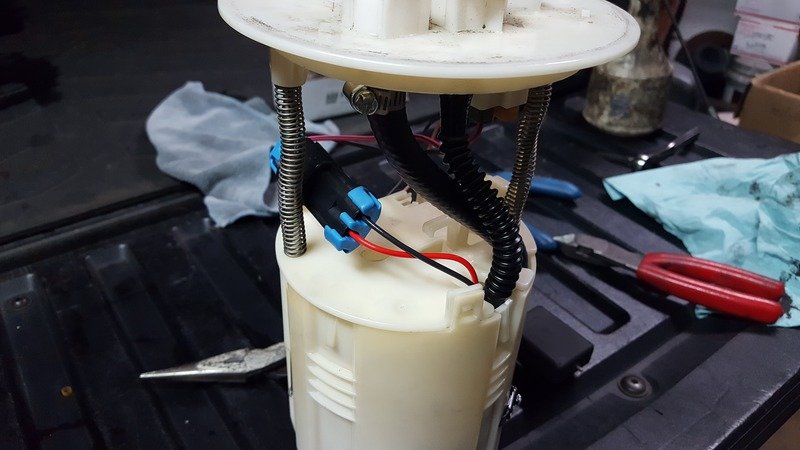

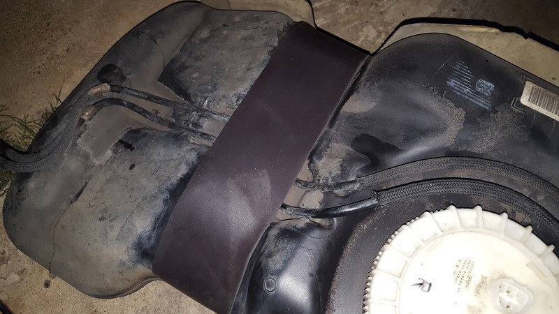

    Here is the padding which I spoke of.
