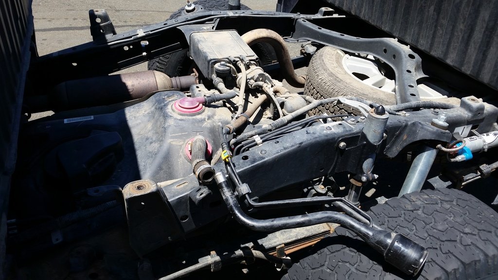

    This is why you should had just taken off the bed instead... or lifted it up, like a lot.

    Maybe this will help you on how the hoses should be hooked up and routed if you got a kinked line. If you have a gross leak though, a kinked line will not be the cause of that code.

    I'm pretty sure it was just stuck on the retaining ring, otherwise I would probably have nonstop pressure issues on the tank

    You did? I didn't know that. It would had been better that way. So you could see everything.
    Also. Do you have fuel leaking out when you top off? Or when you top off the gas pump just clicks off and that's that?

    No fuel leaking for me. The gas pump just clicks off.

    Your ring is sealed then. You are having evap issues due to redneck mechanic work. ;)

    Probably that pain in the ass large hose on the top of the tank. I hate that one. I use WD-40 to help it slide back together. When working under the truck. Also check your small vacuum hose next fill neck. Just to be thorough.
