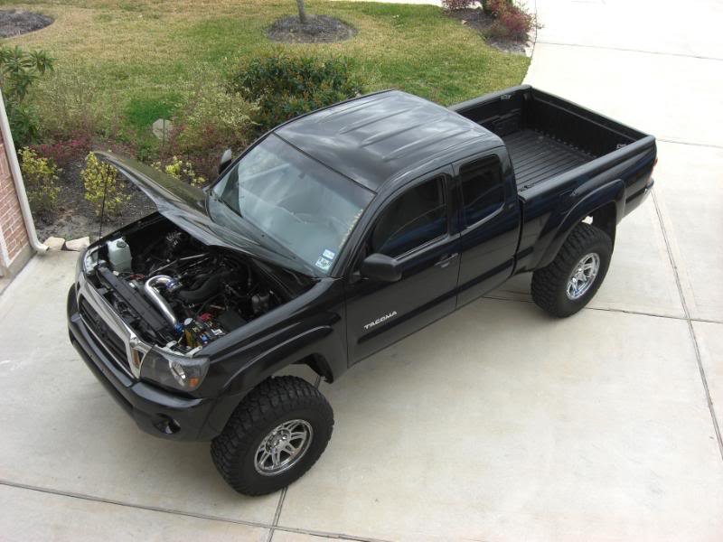

  15. Apr 25, 2016 at 10:18 AM
    #4535
    Torspd
    Torspd [OP] Tor-nication
    Sep 18, 2009
    #22958
    26,477
    Tor
    The Great America!
    MMVI 4.4L 4x4 Access Cab
    Torspd Custom Turbo kit [] Borg Warner 9180EFR Turbo [] Haltech Elite 2500 [] TiAL Q BOV [] TiAL V44 Wastegate @ 15psi [] CP Pistons [] CP Carrillo Rods [] ARP Head studs [] ARP Main Studs [] ARP Header - Head Studs [] Ported Heads w/ 1mm oversized valves intake/exhaust [] Brian Crower Forged Stroker Crank [] Darton M.I.D. Sleeved Block [] Kelford Camshafts [] Torspd 160* T-stat mod [] APR Large Fuel Rail [] Walbro 460 LPH E85 Fuel Pump [] FueLab FPR [] APR T56 Conversion Kit [] KP RACING Built T56 [] McLeod Racing Custom Twin Disk Clutch [] One Piece Aluminum Driveshaft [] MGW Shifter [] Custom lowering kit [] Ohlins Front Coilovers [] QA1rear shocks [] Custom Ron Davis Radiator [] Dual SPAL Electric Fans []
    Found an old picture that I wanted to include in the build thread.

  18. Apr 25, 2016 at 11:31 AM
    #4538
    F75gunslinger
    F75gunslinger Ka like a wheel
    Mar 27, 2012
    #75759
    938
    Christian
    Rochester,NY
    SWB '10 Doublecab TRD Sport 4x4
    Cluster and Radio LED swap,Westin bull bar,2nd set of bed tie downs,URD SS,K&N filter,weathertechs
    What kind of wheels are those Tor ?
  19. Apr 25, 2016 at 11:54 AM
    #4539
    Torspd
    Sep 18, 2009
    #22958
    26,477
    Tor
    The Great America!
    ProComps of some sort. 8 spoke.
  20. Apr 25, 2016 at 11:55 AM
    #4540
    F75gunslinger
    Mar 27, 2012
    #75759
    938
    Christian
    Rochester,NY
    Cool...thanks !! Like those....
