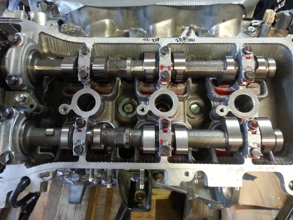

    I found a dealer who would be willing to do a gb for cams. He is calling kelford later today when they open and will get back to me with details.

    So I have a little bit more detail 4 my friends cams. I will update in a few minutes.

    So what he's found is that the '03-'04 1GR heads, from the 4Runner, have a thicker casting than those of the '05+ Tacoma 1GR. 4Runner 1GR engines are made in Japan. So there are slight differences than the Tacoma 1GR's. I am not sure where the Tacoma 1GR's are made. The point is, that the first year model 1GR's have a few differences and need to be checked, for clearances sake.
    That being said, the lobes on the Kelford Cams are obviously taller than those of the OEM cams. His build is on an '03-'04 1GR, and therefore the casting of the oil retention areas around the shim buckets, needs to be clearanced. As referenced in this picture.
    Might no be necessary on the Tacoma 1GR. It would still need to be checked to be thorough.
    Now, this is not a recommendation. This is a requirement. Beehive or dual springs are REQUIRED!!!!
    During testing of clearances, to check valve lash and operation, the oem springs fatigued. This from simply rotating the cams by hand. They did not return to their full stroke or height. OEM springs cannot handle that lift of these cams which I posted the part number for. Valves are fine, but springs MUST be upgraded. Either from Kelford or SuperTech. Regardless of year model 1GR.
