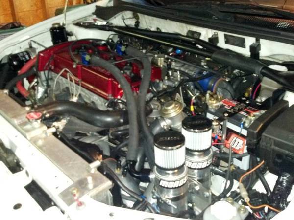

    haha I know what you mean when a boosted tubing transition decides it's had enough ;)
    We actually blew a fuel pump fuse that weekend as well, that was a little more of "oh SH*& what the hell is that" at 160 down the straight. The car is a princess if you ask me but it's all worth it when you get on the track.
    Yea, we've run the evo the last few years with NASA in the TTU class. Had fun but really just enjoyed driving it more than "racing" or time attacking. Now we primarily just hit track days and enjoy flogging it all day not worried about time or other cars times, just about who can run the cleaner lap :) Road America in Elkhart Lake is an awesome track, It is where those pictures were taken.
    We are pushing roughly 500 at the wheels on DB-Perfs AWD dyno, which is not a dynojet. We keep our HP down (relative to what we could be running with our setup) since we aren't dragging the car, but running it WOT for hundreds of miles around a track. Basically we just want it to keep running as long as possible, and 500 at the wheel is a very nice number in that car for road track driving.
    I'll see what I can do for pictures.

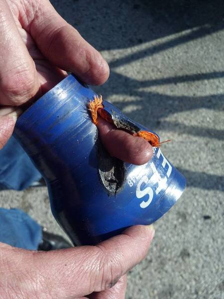

    The heat wrap on our wastegate downpipe unraveled and melted the coupler and then it was only a matter of time before it blew through...
    Sometimes boost is a pain in the ass!

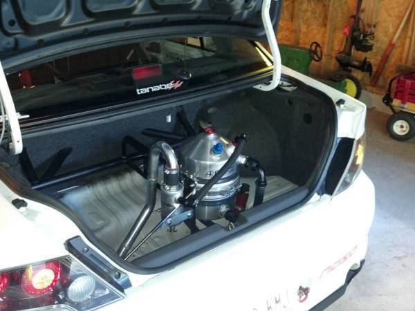

    Thanks for the pics Sconnie! Got my interest peaked with that tank in the trunk. Is that your guys surge tank? If so, what brand is that?
    Going to need something since I plan on doing the Texas Mile next year, so still taking ideas.

    The trunk tank is our reservoir tank, it's by ARE. The sump system is by AP-Tuning (http://www.ap-tuning.co.uk/EvoDrySump.html). The ARE products are second to none IMO, everyone who runs dry sump at the track runs ARE tanks, from high end vettes to our little four banger ( by the way there is nothing better than rippn past a vette down the straight and eating their bumper in the corners in our cereal box car :D)

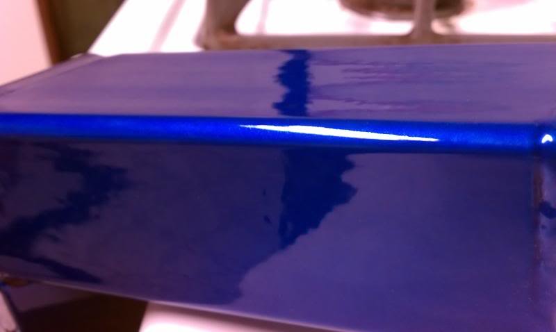

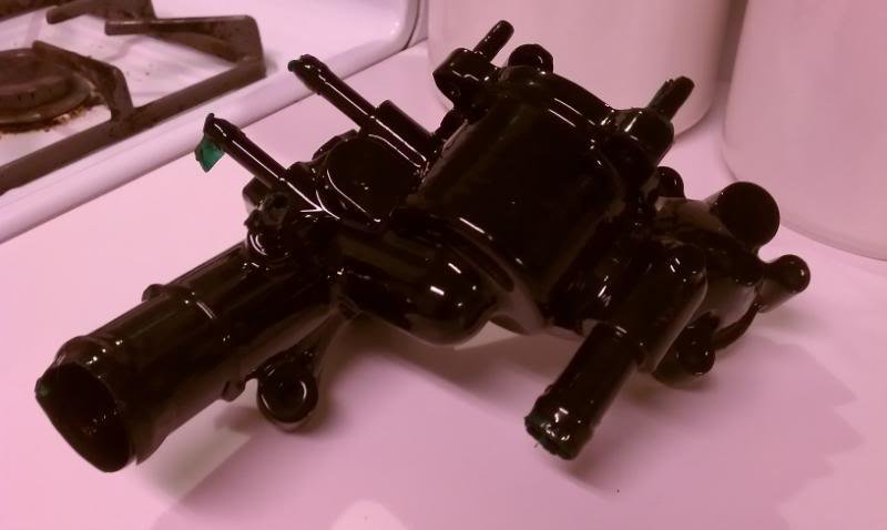

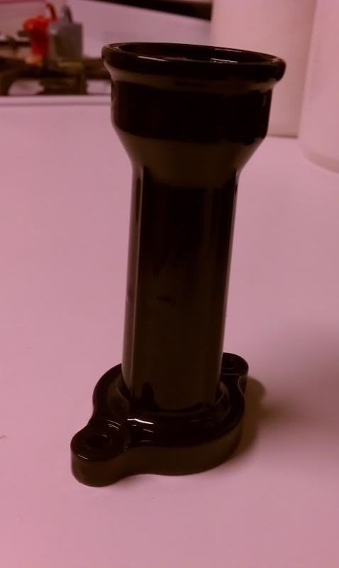

    I had dropped off my FJ oil fill neck to the poweder coater, to get it in gloss black. The FJ fill neck is made from aluminum, versus the Tacoma one of plastic. I received all of these goodies on the 28th of Dec.'11.
    Here is the thermostat housing. The black is suuuuch a better look than the dirty brown it used to be from all of the stains from mudding.

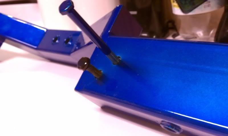

    Lastly, is the T56 cross member. Coated in Jollipop Blue. Came out so much better than I had imagined. I also used it as a test piece, to see if I liked the color. Since I was really wanting to do the valve covers in a blue color. After seeing how it turned out, I was sold on PCing the covers the same way.

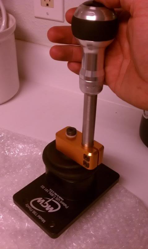

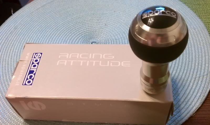

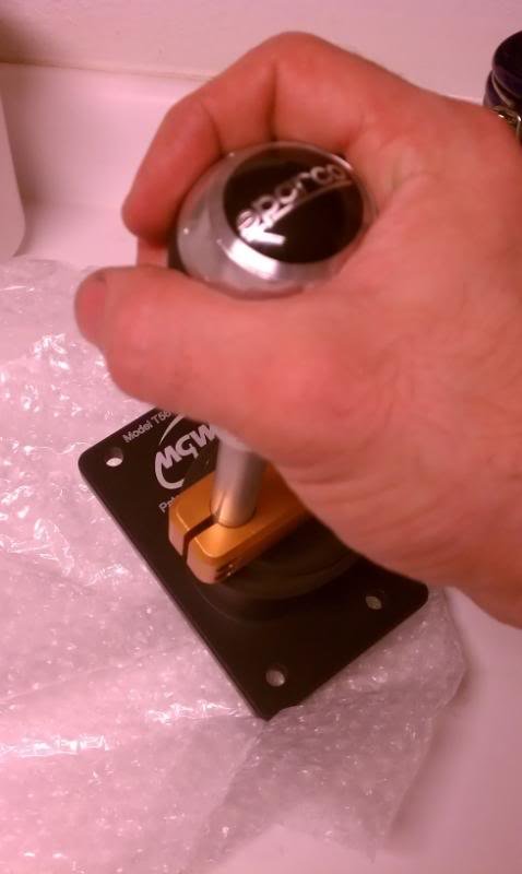

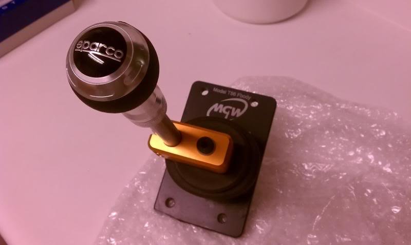

    And not to forget, was the Sparco shift nob from my girlfriend. I had to have the Sparco shift ball in hand first, before I could order the MGW shifter for my T56.

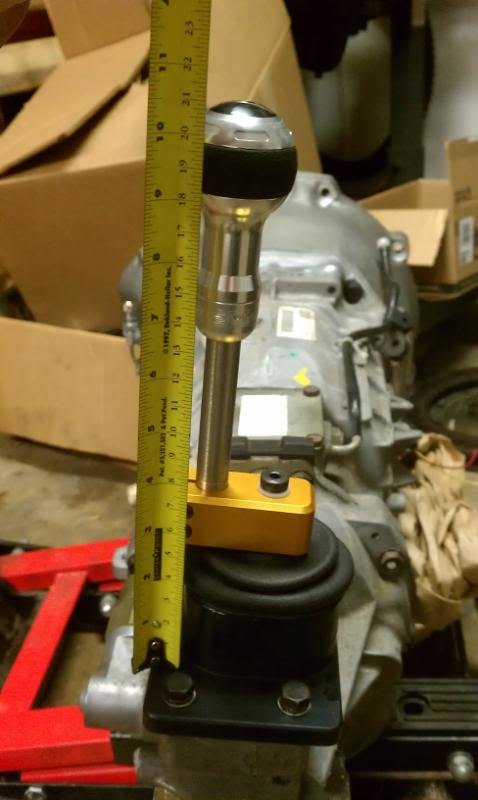

    MGW offers two shifter handles with differing diameters for different sized shift balls. With the Sparco, I could measure its I.D. and the select which option for the shifter. It was the 12mmX 1.75 pitch that ended up being the proper choice.
    http://www.mgwltd.com/camaro_short_throw_shifter.shtml

    Come the 10th of January '12, my sweet shifter had arrived, from MGW.
    A point to add about this shifter, is that it is a short throw shifter, in reference to the 98-04 Camaro's. At this point, I wasn't sure how much that would affect the it fiting in my truck, with the swap kit, but honestly I didn't care. I had a Fvcking T56 going in!!!!

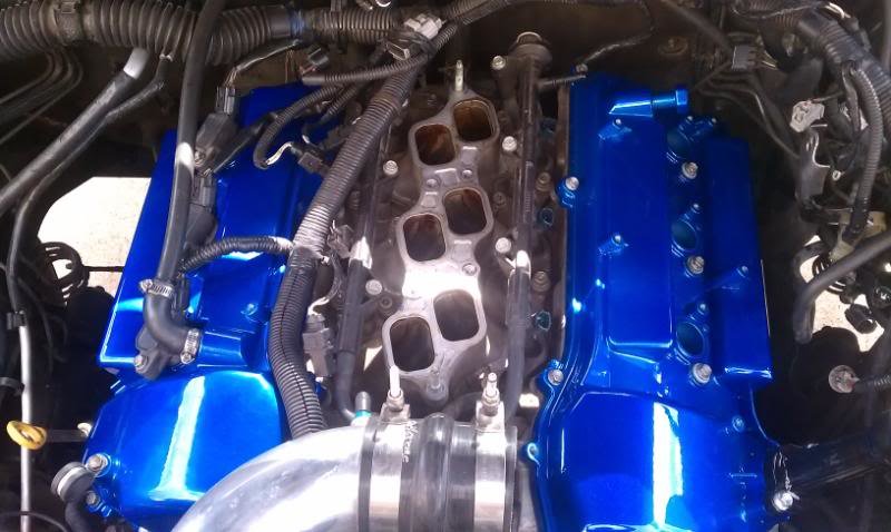

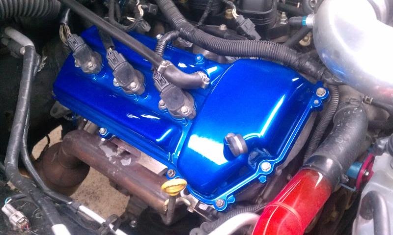

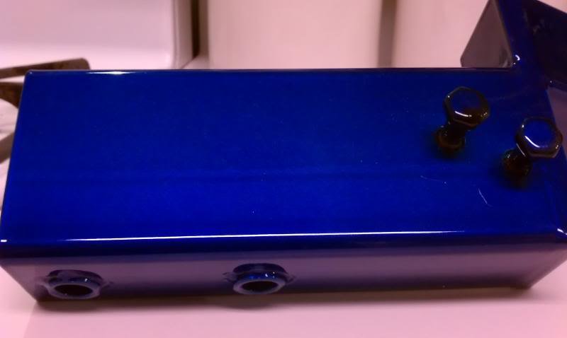

    After seeing how well the cross member turned out, I dropped off the valve cover. That Jollipop turned out fantastic on them as well, I think.

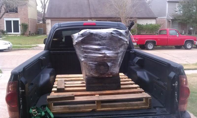

    And then of course this picture of my to be re-built engine. Ready to be delivered to PowerFab Automotive, so that it could get shipped out to Darton East.

    So you're going to have one built engine, one semi built engine and one stock motor or am I mis-counting?
