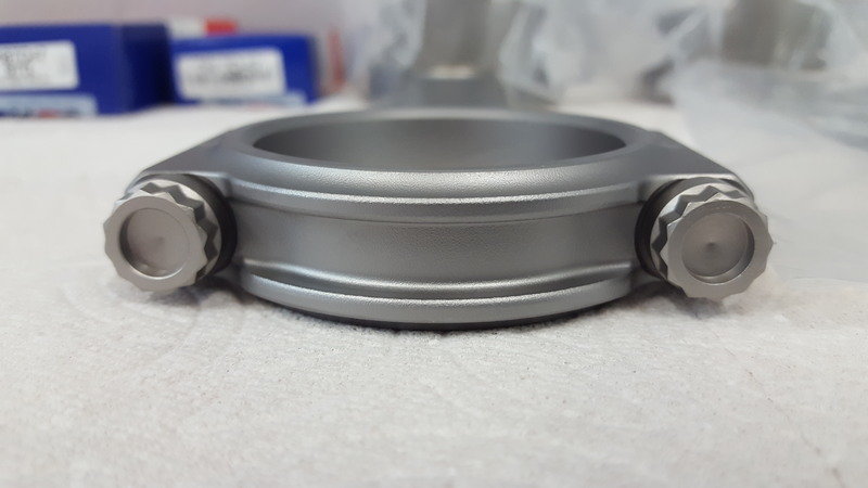

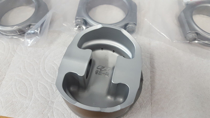

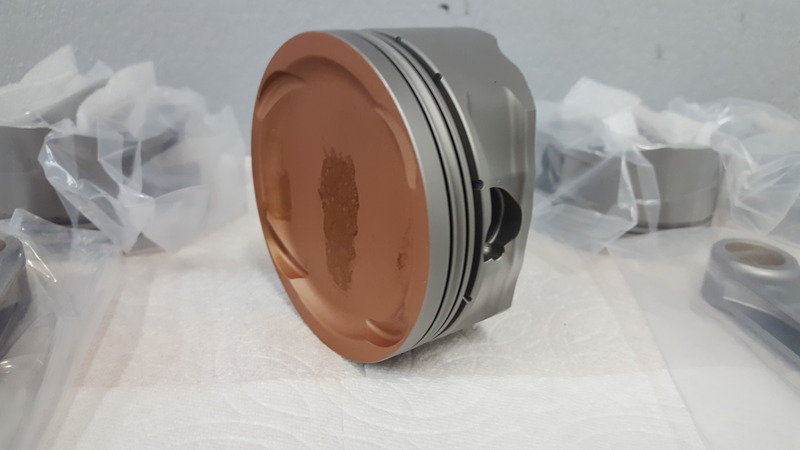

    That WPC treatment looks so damn sexy. Home much did it cost you if you don't mind me asking?

    $946 including the shipping. Rods, pistons, wrist pins, crank, and all of the bearings.

    Less than I thought TBH. Why not you cams?

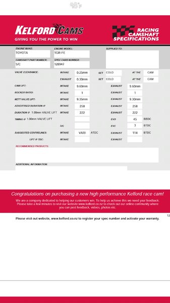

    So kelford suggests that the L49 or L103 would both be too large. This is what they suggest for me.

    Did you find that calculator on their website? It looks like it is in the Racing Camshaft section.

    I am not finding what you are referring to.

    That picture which you posted. They came up with those numbers for you?
    They also seem pretty similar to the numbers in the P/N L132x.
    Also, related to this topic. I dropped off my intake cam gears to Kozmic, to have them cnc some lobe stops, inside the cam gear. To better limit is attempted VVT movements. To more adequately lock their positions, versus the one screw. Whenever I receive them back, I'll post up the pictures.
