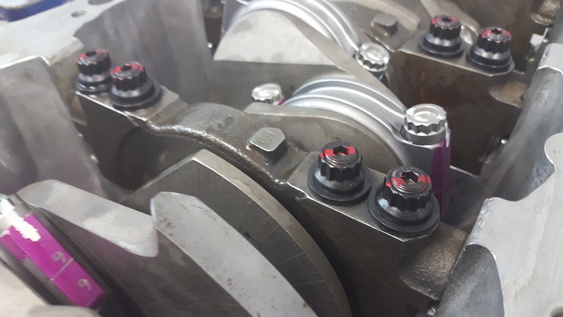

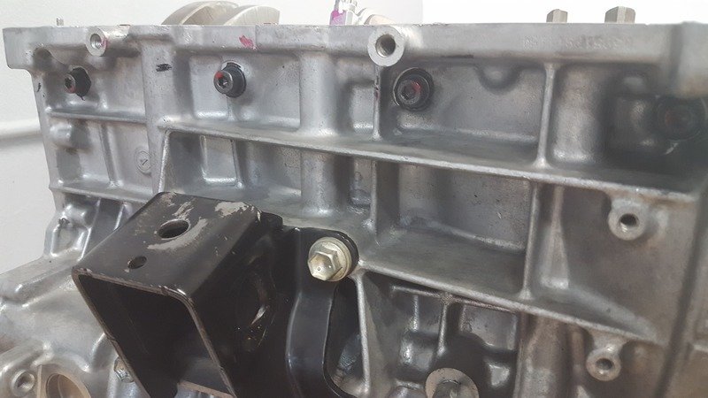

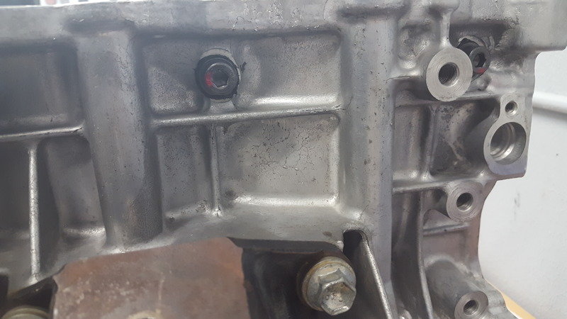

    ARP bolts for the sides of main caps.
    Head gaskets should be here next week. Woot.

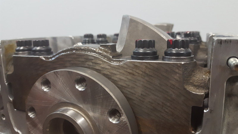

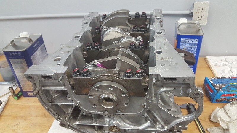

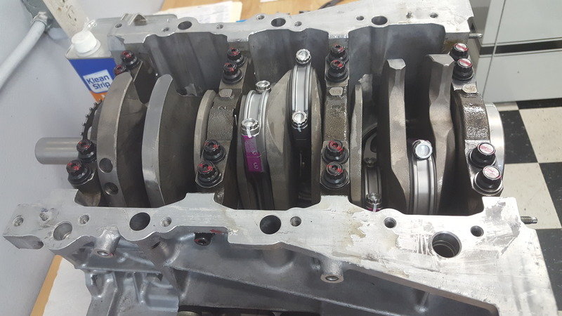

    2JZ-GTE head studs, are the main studs for the 1GR-FE. Which are installed in the pictures above. The #4 main cap had to be trimmed so that that nuts and washers would fit while clearing the upper oil pan. As well as did the top of the studs.
    CP Carrillo rods with A1 Technologies rod bolts. Of equivalent strength to ARP Aged 625+. CP pistons with valve reliefs and 9.0:1 compression ratio.
