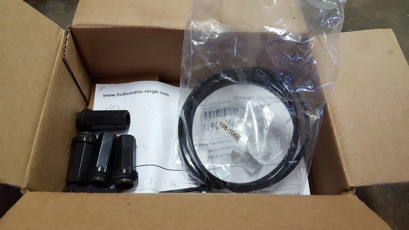

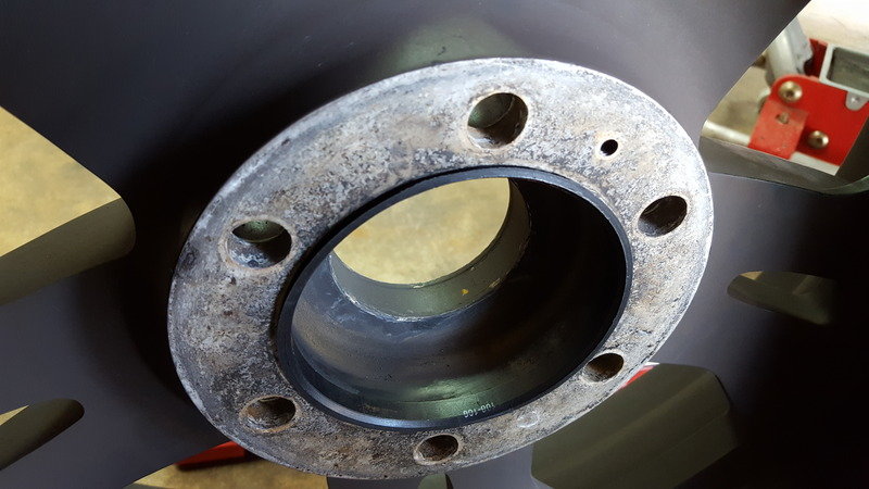

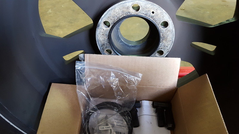

    Thank to @Jimmyh , for a link which he posted in another thread. I now have a set of hub centric rings.
    I always had to be very meticulous during my wheel installations. Didn't ever think to look for the rings because I simply figured that the difference in wheel diameter to hub diameter was too close. Until I scrolled through the link he posted.
    I left it out just a tad, for the picture.
    My wheel diameter is 108mm. Whereas the hub is a 106mm.
    Now they slide right on and centered. Even being as careful as I could during all of my previous installations, the truck drove better with the rings installed. :thumbsup:

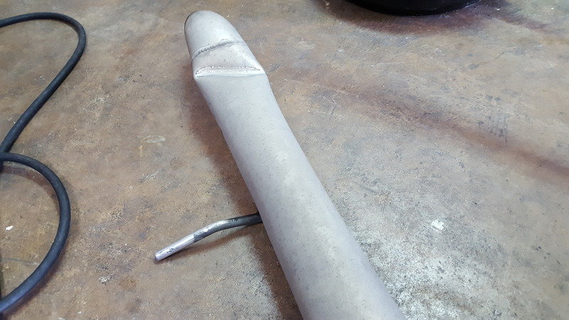

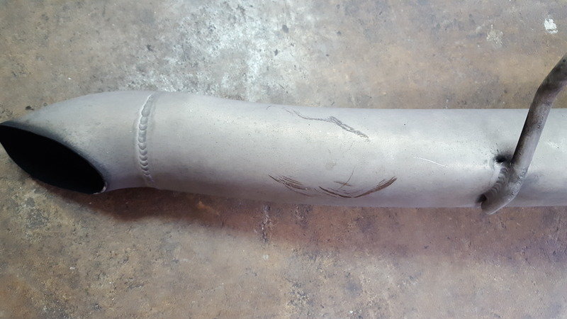

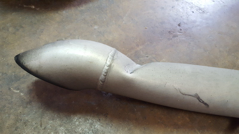

    While I was down there, doing the right rear wheel, I noticed something strange with the exhaust hanger closest to the rear bumper.
    The right license plate light was also hanging.
    I had an unavoidable encounter with a piece of shredded tire on the freeway, over the weekend. Seems that it hit the rear of the muffler and bent it up.

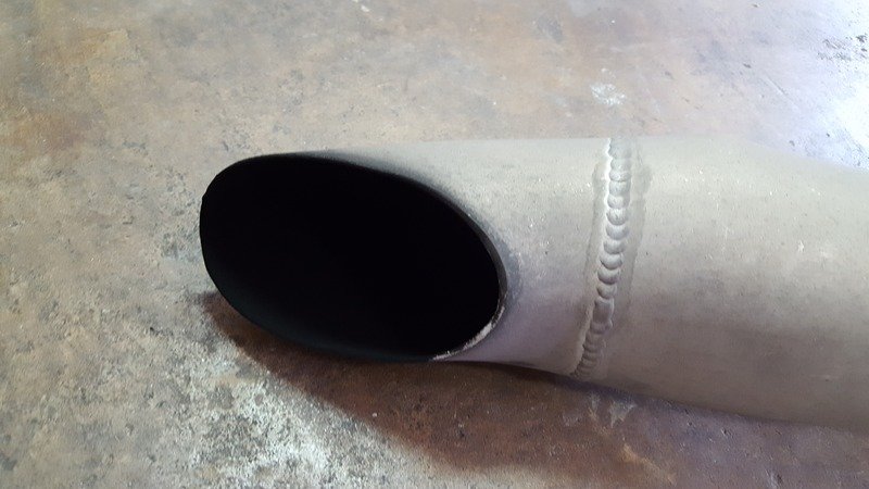

    The 3.5" tubing outlet is ovalized.
    Bent by the spare tire frame.
