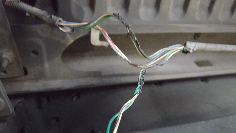

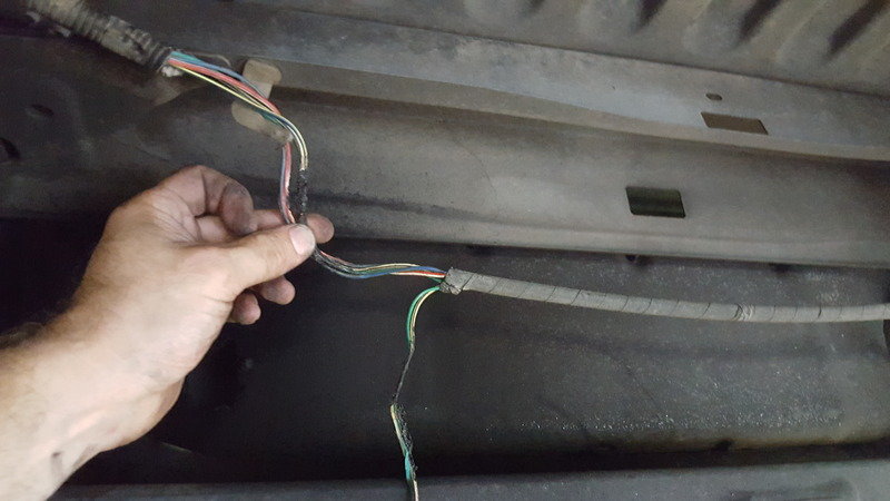

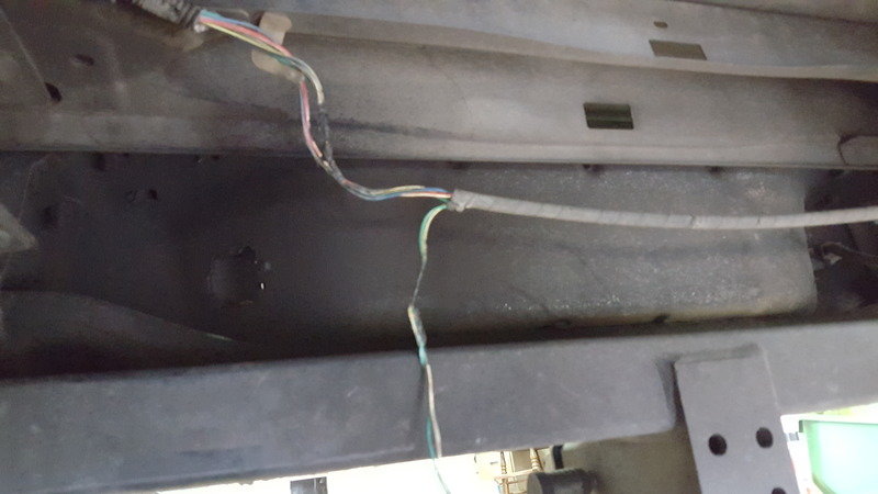

    It bent the tip up to aim it directly at the the wiring harness at the rear bumper. Very fortunate that I noticed it before it became worse.

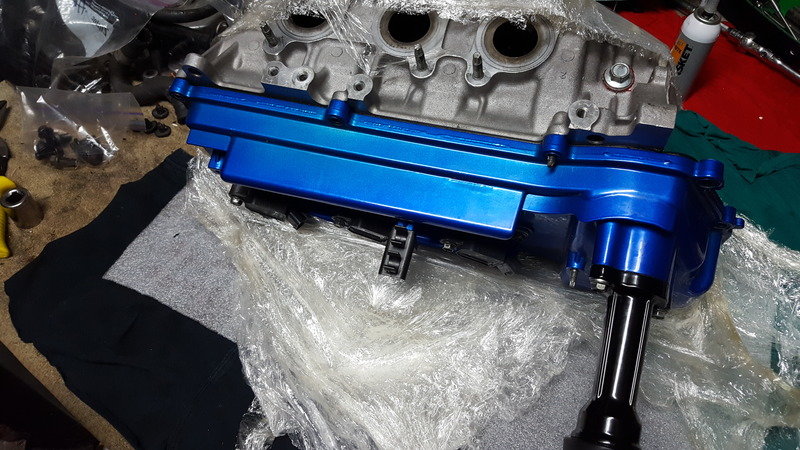

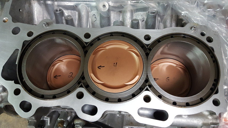

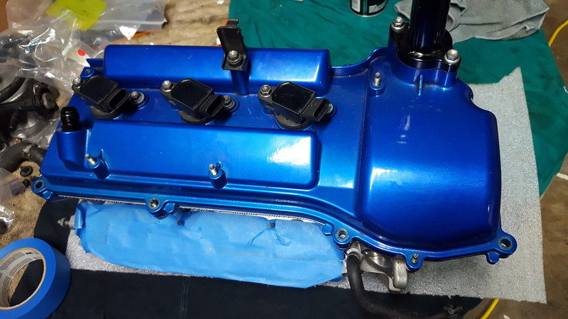

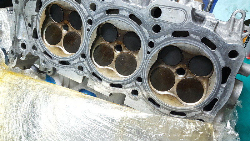

    Took a few pictures last night, before the cleaning of the mating surfaces. Hoping to install at least one head by tonight.
    The unwrapping after over a year.
    Mmmm. Oversized valves!
    Oil is slightly visible on the plastic wrap.
    As it sits, awaiting tonight and cams removal.

    Dupont Jollipop blue. Some powder-coaters call it candy blue.
    I absolutely love the color. Reminds me of a deep iodized blue.

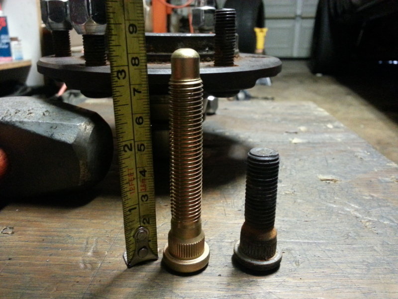

    I thought i read somewhere that you have arp wheel studs? If so did you use the 1007718 or the 1007715?
  17. Jun 14, 2016 at 2:58 PM
    #4677
    Torspd
    Torspd [OP] Tor-nication
    Sep 18, 2009
    #22958
    26,477
    Tor
    The Great America!
    MMVI 4.4L 4x4 Access Cab
    Torspd Custom Turbo kit [] Borg Warner 9180EFR Turbo [] Haltech Elite 2500 [] TiAL Q BOV [] TiAL V44 Wastegate @ 15psi [] CP Pistons [] CP Carrillo Rods [] ARP Head studs [] ARP Main Studs [] ARP Header - Head Studs [] Ported Heads w/ 1mm oversized valves intake/exhaust [] Brian Crower Forged Stroker Crank [] Darton M.I.D. Sleeved Block [] Kelford Camshafts [] Torspd 160* T-stat mod [] APR Large Fuel Rail [] Walbro 460 LPH E85 Fuel Pump [] FueLab FPR [] APR T56 Conversion Kit [] KP RACING Built T56 [] McLeod Racing Custom Twin Disk Clutch [] One Piece Aluminum Driveshaft [] MGW Shifter [] Custom lowering kit [] Ohlins Front Coilovers [] QA1rear shocks [] Custom Ron Davis Radiator [] Dual SPAL Electric Fans []
    I do, and used the Celica GTS studs. The knurled portion is longer and the studs are shorter than the Lexus studs. I have no knowledge on the Evo studs. I did create a sticky on XRU though.

    So the 1007718 is celica. Would it matter wich one I get if I'm going to cut them down so I don't have to run open ended lugs? And to be able to use them with a rear spacer? I'll have to go look for that thread and read through it on XRU
