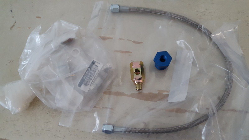

    The two fittings are for the engine. A Tee for the oil feed and OEM sensor. The blue fitting is for the oil pressure gauge. It is an Earl's 1/2" NPT male with 1/8" NPT female, for the oil pressure gauge.
    The gauge fitting can be seen here.
    The braided line is from Speedway motors. http://www.speedwaymotors.com/T56-Re...der,41385.html

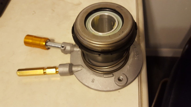

    I already have a bleed line from my current two adjustable TOB's, but since I decided to try and OEM GM TOB, I needed a new line to replace the short factory solid one. Seen below.
    Now I have done some measuring and compared to the notes I have take, and so far it looks as if this GM TOB will fit with my twin disk clutch. The only concern I have now, is if the input shaft sleeve will have enough clearance to the closest clutch disk's hub. As I have not taken a measurement for that before.
