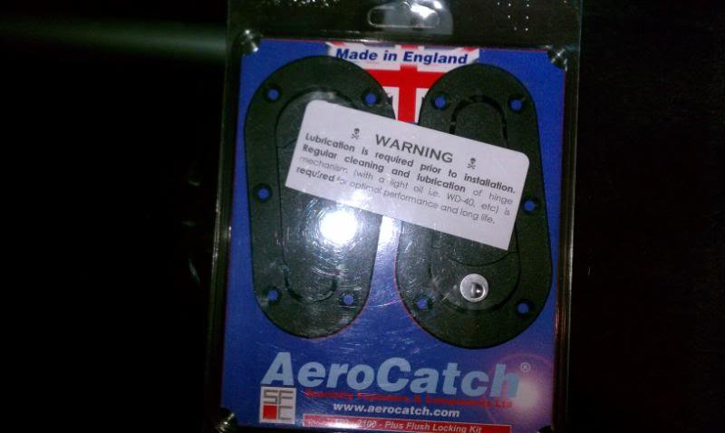

    For those that have installed a fiberglass hood, (VIS carbon fiber/fiberglass in my case), they tend to vibrate at speed on either side of the hood latch.
    The solution:
    Not sure if there is a write-up for these or not, but I did one because I couldn't find one on XRU.
    http://www.xr-underground.com/forum/showthread.php?t=47784
    instant change. I feel 100% comfortable about my hood staying secured down as it should now.
